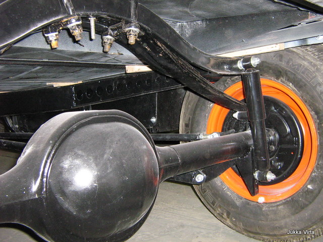

    I put one such rearend under my 30 Cabriolet with stock spring and stock trailing arms reinforced and modified to ladder bars with single large uniball mounted just under the front universal joint. The wheels were 15x7 with 235/75-15 tires. Wheel wells and fenders stock width.
