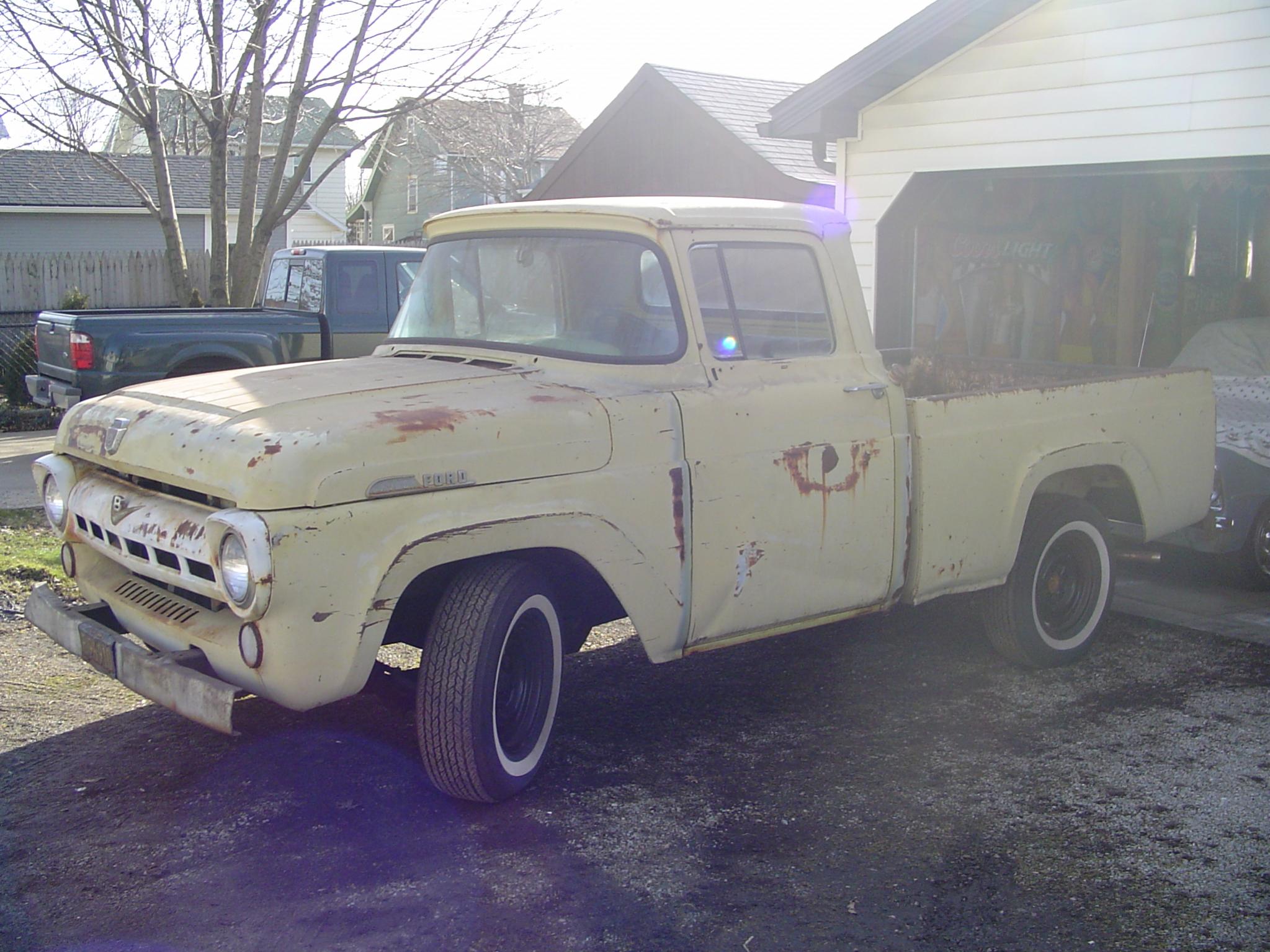

    Dennis, Your looking for a 59-60 F100 front bumper. Maybe 58 too I don't remember. Here is my 57 with the original and then the later.
    And the then the frames horns trimmed and the bumper tucked back.
    Later,Bill
