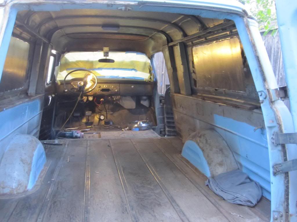

  3. randy
    Joined: Nov 15, 2003
    Posts: 677
    randy
    The first order of business was cleaning out all the sweet custom paneling, curtains and tropical fish decals. Smoking bath salts and interior decorating your panel truck can have disastrous results...obviously! Also, the front seat had to go as it was a 70's car front seat that was built up on chunks of lumber.
    Once that was done, I took out the camper windows. The guy that installed them used hand shears and did his best to warp the panels while doing it. The big flat-ish panels scare me a little, but I can't make it worse! hopefully!
    I made filler pieces and tacked 'em in. Had to shrink a little out of the passenger side where caveman had stretched it pretty bad.

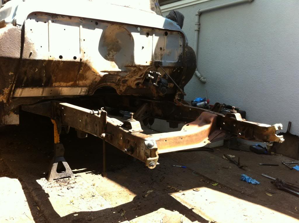

  17. randy
    Posts: 677
    randy
    With the front clip, motor & suspension out of the way, I figured I should probably replace the rusted out toe-boards.
    ...and weld a million holes closed in the firewall.
    I found out in removing the heater unit that this truck has the desirable "deluxe" heater although it does not have the "deluxe" controls. Luckily, they pop up on ebay pretty frequently.
    I got the frame pretty well cleaned up and the sheet metal repair work mostly finished up on the firewall & toe boards

  18. randy
    Posts: 677
    randy
    Finally got to paint the frame. Went with Por-15 because I had an unopened quart in the cabinet. The frame was surface rusted and/or ground with a 50 grit roloc and then degreased. Seemed to stick pretty well...
    I got the leaf springs cleaned up, removed one leaf and reassembled with teflon liners from Speedway. Also, pressed in new leaf spring bushings and reassembled it all with a 4" dropped axle from Nostalgia Sid. Scrub line??? what scrub line???
    Model T1 likes this.
