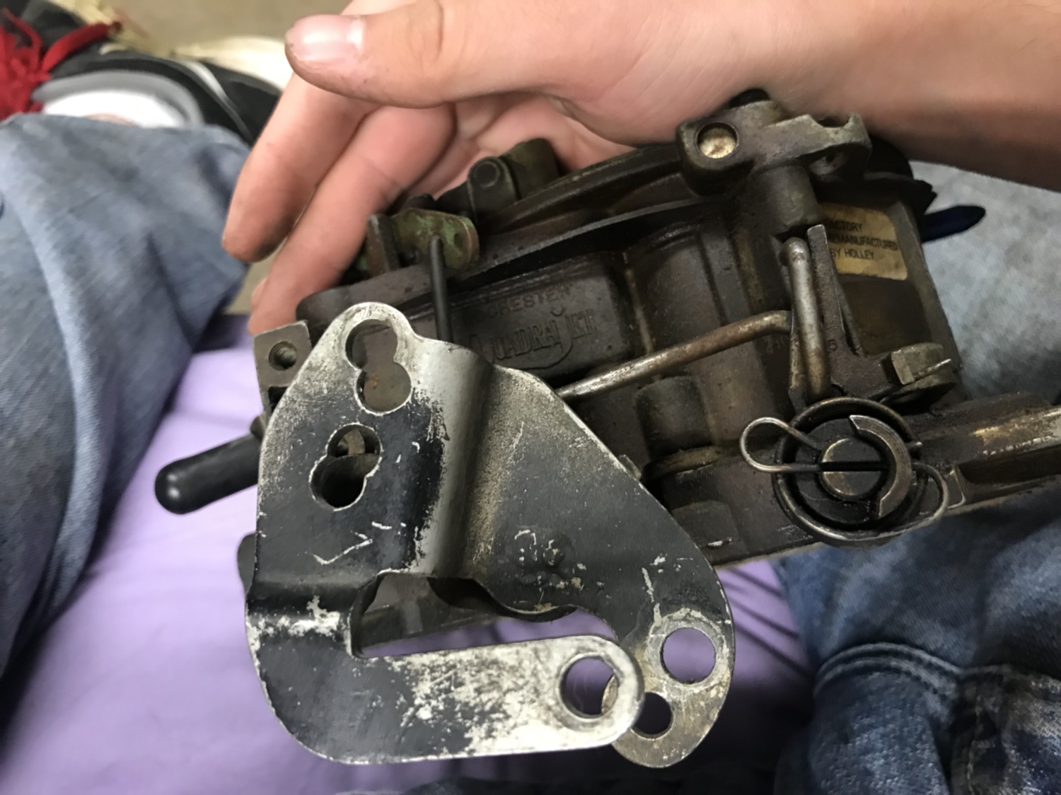

    Well i still am not getting fuel to the carb, it’s been cold so i haven’t wanted to work on it much but i went to a swap meet this morning, just to look around and i ended up having a guy give me some arm rests, (mine are very brittle and broken) and i picked up this intake/carb/air cleaner for $30. The stainless was too cheap to pass up but unfortunately it has a couple cracks. The quadrajet that was on the intake is foreign to me. I believe it has mechanical secondaries and it looks like a vacuum choke to me. Maybe someone will know more about it than me...

    Glad to see you back on it. can't help much with the carb but maybe some of the parts can fix the one you have on the car. The black disc thing is the adjustable cover over a coiled thermactic spring that is heat sensitive, it needs a tube from the exhaust manifold drawing hot air into that coil to slowly open the choke as the engine warms up and it also lowers the high idle speed after you "kick" down the throttle. The cover is loosened and rotated to allow the choke blade to close to a certain position to allow a richer starting mixture. Takes a little patience if you don't have the book to go by. Your exhaust manifold should have a drilled hole all the way through to place this tube into. If you have a newer exh. mani without it then all this typing is for naught and you will have to go to a manual push/pull knob from the dash. Get at it!!!! Ralphie Edit, hood bar ends look good, throw the center away, better off with none than a busted one, people will think you did it!!

    Took the quadrajet that came on the new intake apart, it’s a high altitude auto tranny version which i guess isn’t a very good carb. It’s all gummed up inside and has a kind of caked dust all over inside. I’m not going to use this carb, it’ll go back on the shelf as a spare. On to the next
