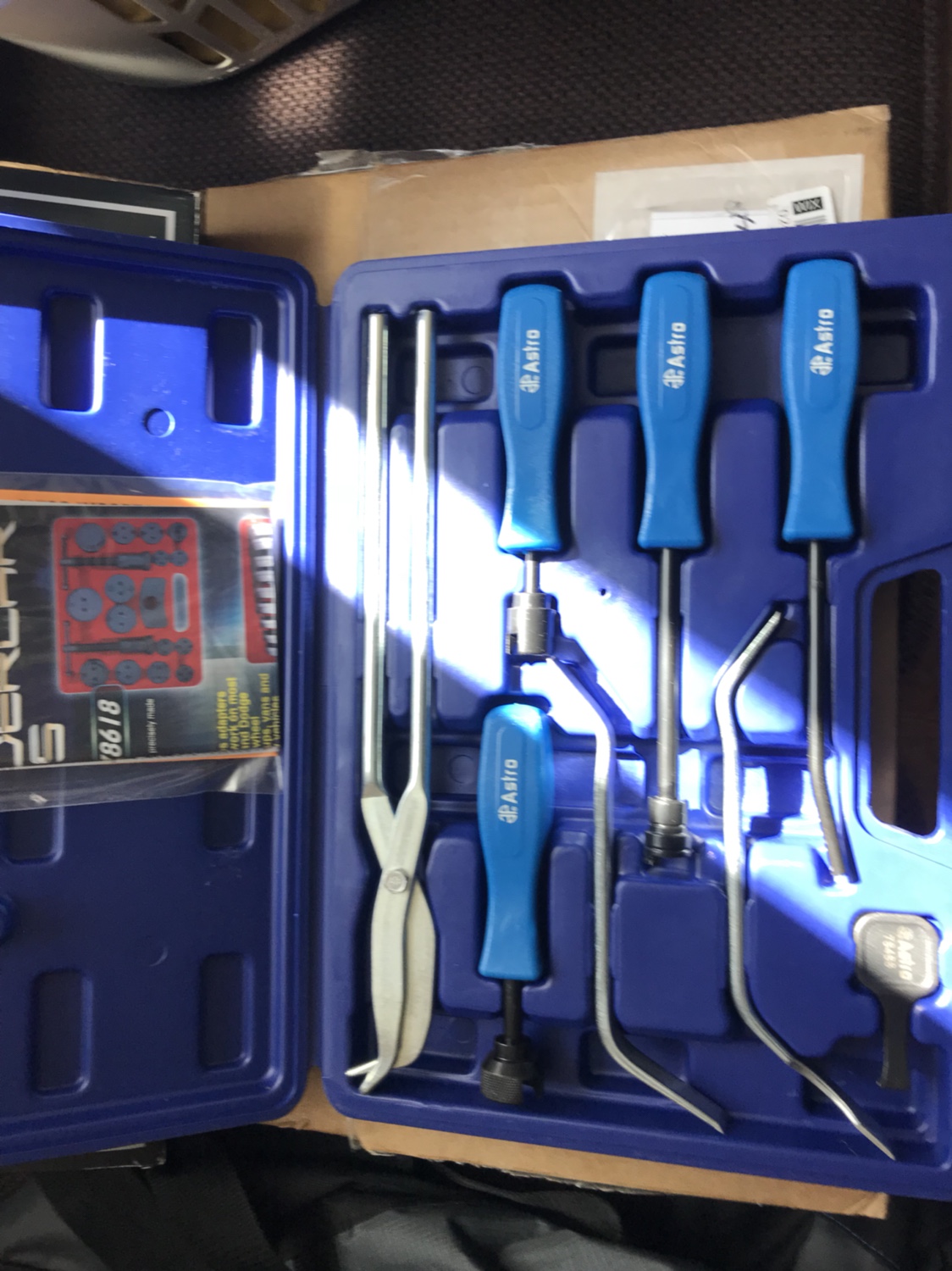

    [​IMG]huge thanks to RMONTY, this should definitely get me started with the brakes once the parts i ordered come!
