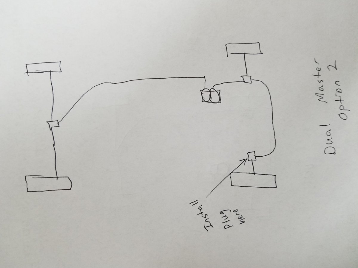

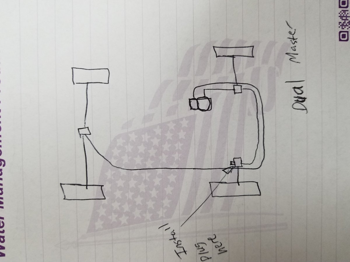

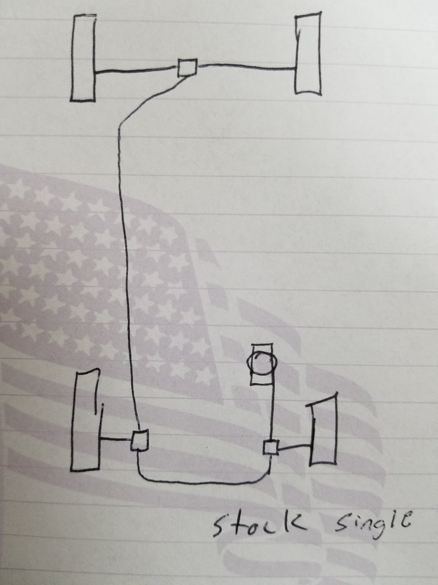

    You cannot just copy the existing lines when you update to a dual master. On a stock setup the rear brakes connect to the front brakes at a tee on the passenger side. You will need to add a second line from the master to the rear brakes and install a plug in the tee on the passenger side. I have attached some quick sketches of what I am talking about as well as some additional threads that discuss this. If you are planning on running all new lines I personally like to run the rear brake down the drivers side as shown in my "option 2" it is less tubing that way.

  29. RaginPin3Appl3
    Joined: Mar 31, 2016
    Posts: 1,172
    RaginPin3Appl3
    Thank you! this gives me a good idea of what i need to do.
