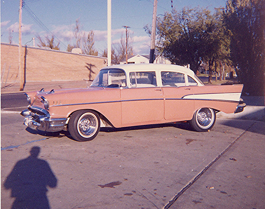

Customs 57 Chevy Budget 4 door build
Discussion in 'The Hokey Ass Message Board' started by RaginPin3Appl3, Aug 5, 2017.
  1. RaginPin3Appl3
    Joined: Mar 31, 2016
    Posts: 1,142
    RaginPin3Appl3
    Well, after 2 years of looking for a 2 door 57-59 chevy i could afford, i finally settles on a 4 door 57 belair. I picked up the car for $1500, and I don't think it has any floor rust, and most of the body is good as well. No parts are missing, and for $300 i had it towed across Missouri to my house in Illinois.
    Got it home yesterday morning and bought a new battery, and plugs and wires for $200, so I'm in the build for $2000 at this point. The goal is to keep it under 3 grand, and that might sound like a crazy idea, but i think i can deal hunt and make it happen. I just wan to get it running and do some cruising this fall. IMG_3159.JPG IMG_3160.JPG IMG_3162.JPG IMG_3163.JPG IMG_3164.JPG IMG_3165.JPG IMG_3167.JPG IMG_3168.JPG IMG_3170.JPG I'll put a small block in the car since it only has a 235,
    and at some point i'll do body work but this is what i had after i got it off the trailer yesterday morning.

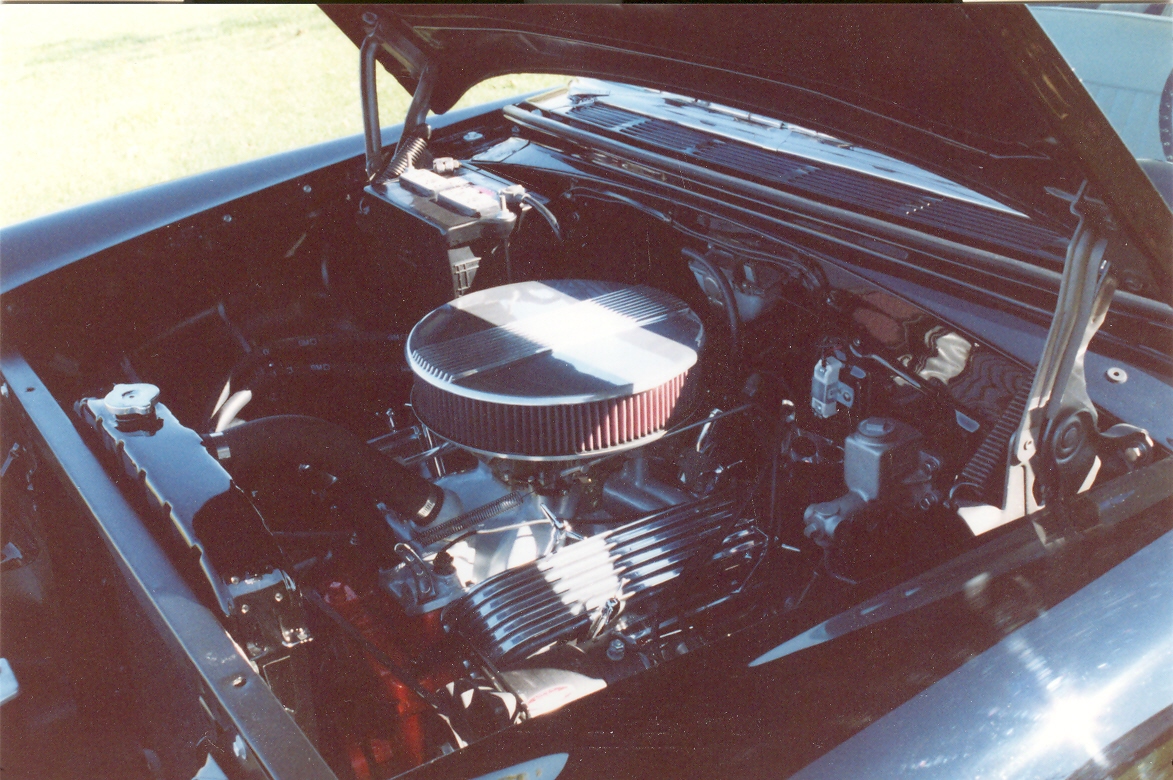

    Attached is a photo of my 55's engine compartment. It was originally a 235 six with a Power-Glide automatic. A V8 radiator and radiator support were swapped in at the same time as the 283, (now bored to 301) and Muncie 4 speed, (which is also basically a bolt in swap). Stock V8 motor mounts were used front and rear. The throttle linkage and return spring are stock V8 parts for a 55 - 57 Chevy, too.
