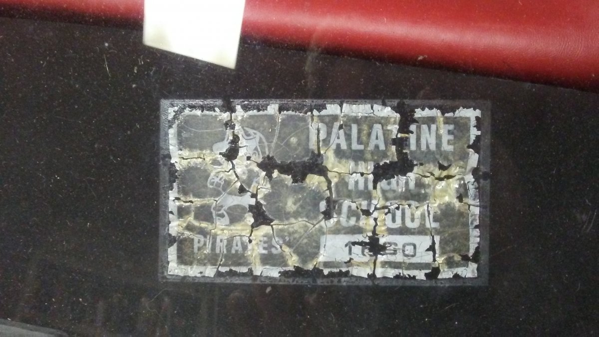

    This is the high school parking lot sticker that's still in the rear window. It's a long shot, but maybe someone will recognize it in it's old white 4 door format and I'll get to find out the history of it.

    Palatine High School is NW of Chicago. Just a little north of Schaumburg. There mascot was the Pirates. You may want to trace it through them with the number on the sticker. Pretty sure that was a parking pass for a student.

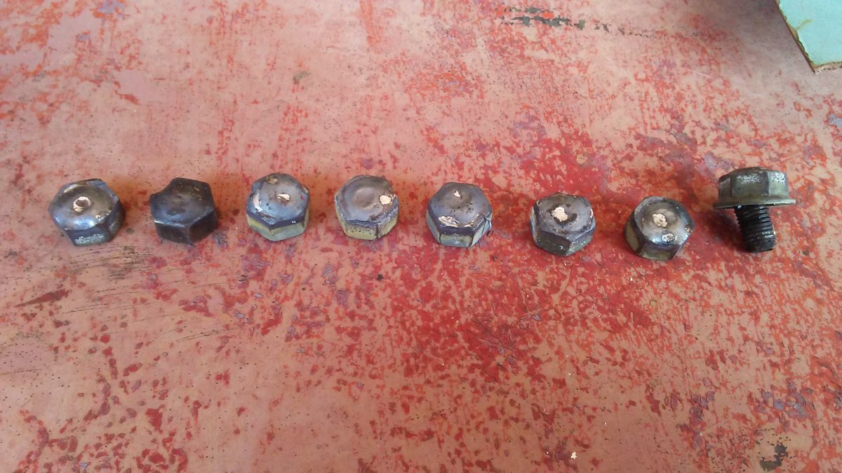

  22. I used to wonder why the hell i was only successful some of the time, welding nuts to a broken bolt. The key, i've found, is the flat washer. Weld that down first, then get real good penetration on top of that

    The washer is especially good if the stud is snapped off flat, what I also found is if you quench the weld with water while it's red hot sometimes it'll harden the weld and the bolt will twist out without breaking off. The most frustrating part of this one is it would come out at least a half turn every time before breaking off. I think the bottom of the bolt was just a ball of rust, and there's no access to the underside, so I had to just keep forcing it.
