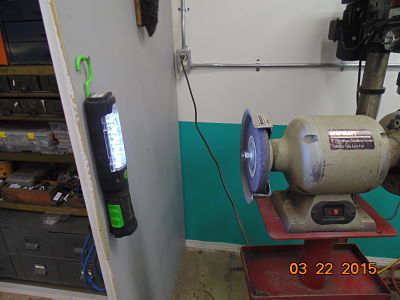

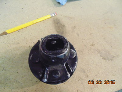

    2015-03-22 18_opt.jpg So, I got a bit of time Sunday and Monday to yank the column, and do a lil brain salad surgery on the rag joint. Using the paint as an initial gauge of how much I removed, I then marked a length measurement on the nose, and ground it close, then filed it flat. 2015-03-22 19_opt.jpg
    Getting to an age where this is super handy near anything I'm working on.. 2015-03-2252_opt.jpg

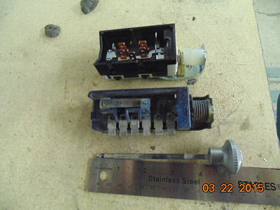

    Bolted everything back together, success indeed. The shifter operates, so the column is in for the last time I hope. So, I've had to use a '57 Chevy headlight switch to go with the wiring harness, as the Pontiac one won't work. The Chevy switch fits in the dash, but the knob won't go in far enough to lock. Currently pondering shortening the shaft, or getting a Chevy knob and changing out the plastic part of it (the actual knob), as the Poncho one is silver, and Chevy ones are black. 2015-03-2232opt.jpg

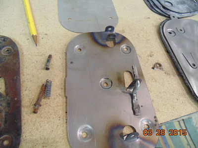

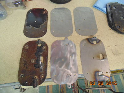

    Well, a couple updates. Slow going, between a 2 week holiday in May, a bathroom reno, doing some painting and wall repair in the house, and a kid graduating high school, Pontiac time has been fairly limited. But, a few things done. The driver's side floor vent door was rotted, so I gave it to a buddy with access to a water jet, and he had a new one cut for me. I had to set indents into the new piece to allow a gap for the seal ( a piece of rubber sandwiched between the metal door halves). I used a button setting tool as a form, a chunk of tube, and hammered 'em in. I riveted it back together, robbed the pins from the old door, lubed and reinstalled the cable, and put it back in, works great. 2015-03-28 20_opt.jpg 2015-03-28 21_opt.jpg

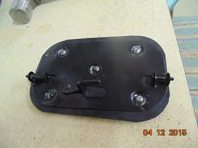

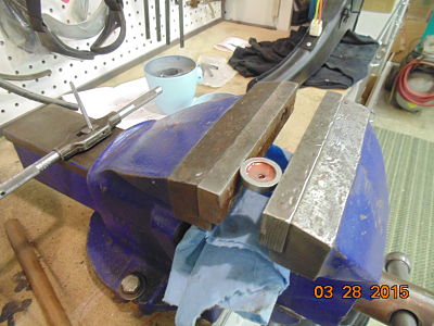

    The top pin in the original door was swaged in place at the factory. I ground off the swage, chucked it in the drill press, and carefully cut a groove in the pin with a hacksaw blade, so I could put an E clip on it, so the pin could still spin in it's pivot. 2015-03-29 16_opt.jpg

    2015-04-12 12_opt.jpg 2015-04-12 155_opt.jpg The completed door. I'll get the other few things done up here in the next few days.

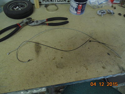

    I changed the wiper cable I mentioned earlier, with the thought that if it ever failed, it's guaranteed to be during a rainstorm. It is available as a reproduction, but only with the wiper transmission, at $150 or so US, so about $3000 Canadian (kidding, but certainly over $200). So, I bought a cable ferrule swage tool for $95, and had at it. That was an exercise in holding one's tongue right, but I got it put together. 2015-04-12 15_opt.jpg 2015-04-28 21_opt.jpg

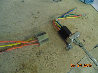

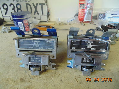

    I had thought earlier I would adapt a Chevy heater fan switch to the Pontiac housing. That wasn't going to work, so instead, I made a jumper harness to adapt the Pontiac switch to the Chevy dash harness, using the Pontiac insulator. I also had 2 heater controls, so I disassembled both and used the best parts to put together 1 nice one. Pontiac 0915 005_opt.jpg Pontiac 0915 006_opt.jpg Pontiac 0915 004_opt.jpg

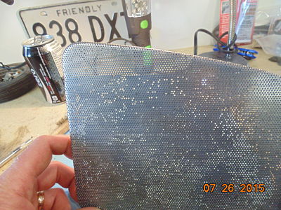

    The last items on the saga of the dash are the accessory gauges, and fixing the paint on the passenger side. It had a big goober where the paint had crazed, and about an 1/8" of paint on the speaker grille. I stripped the paint on the grille, and every member of the house spent time poking the little holes with my scribe getting all the gunk out. I had placed a wanted ad on the Canadian Poncho site for the missing Pontiac dash script. A great guy that lives here in Calgary responded, he had a spare that he GAVE me, so I met him for a beer and had a nice chat. I fixed the paint goober, and installed the emblem. The dash is off the list. Pontiac 0915 067_opt.jpg Pontiac 0915 072_opt.jpg Pontiac 0915 124_opt.jpg Pontiac 0915 126_opt.jpg

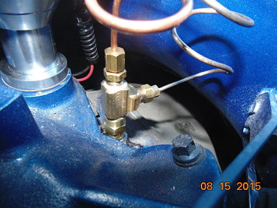

    Into the engine compartment, yay!! Because of the electronic trans, I needed an adapter to run the speedo cable. So that's in, and pretty hidden. The plumbing for the SW oil pressure gauge as well as the stock gauge is in. Pontiac 0915 065_opt.jpg Pontiac 0915 086_opt.jpg Pontiac 0915 085_opt.jpg Pontiac 0915 121_opt.jpg The fuel line from the pump to the carb is done (twice actually, I wasn't happy with my first plan). The brake lines are done in the front, I just have to make up the chassis brake and fuel lines. And I made a throttle rod for the stock pedal to mate to the not stock engine and carb.

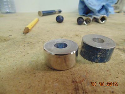

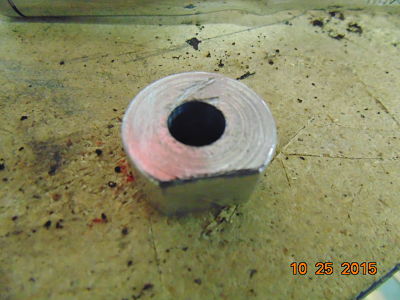

    The alternator bracket uses stacked washers to accommodate for different intakes. I thought these were kinda cheesy, so I made up a couple spacers instead. I rummaged through my junk, and came up with this little aluminum piece that I cut in half, and filed to thickness and diameter using my drillpress. Pontiac110515 003_opt.jpg Pontiac110515 001_opt.jpg Pontiac110515 005_opt.jpg Pontiac110515 006_opt.jpg

    Looks a little less cheesy than the washers. Pontiac110515 013_opt.jpg Pontiac110515 008_opt.jpg Pontiac110515 017_opt.jpg Pontiac110515 018_opt.jpg

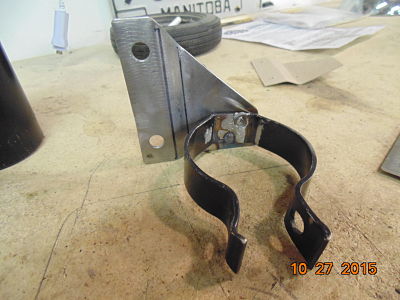

    Pontiac110515 022_opt.jpg Pontiac110515 024_opt.jpg Pontiac110515 025_opt.jpg I couldn't find a coil bracket I liked, and it won't fit in the stock location on the intake due to my throttle linkage. So I used an extra fuel filler tube bracket, and made a mounting tab for it. It looks crooked in the pic, and it is, intentionally. This way, I can get the coil out of the bracket, without removing the bracket from the firewall.
