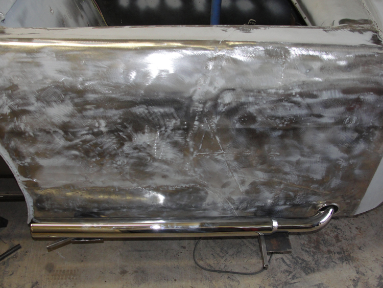

    Updates????? Where are they????? Alright, I worked my ass of on this car Sunday so here are some top secrete cell phone spy pictures I took to hold us over until Racrdad updates the thread.:cool:

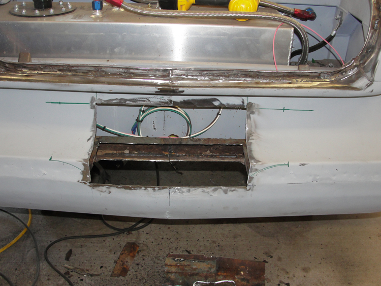

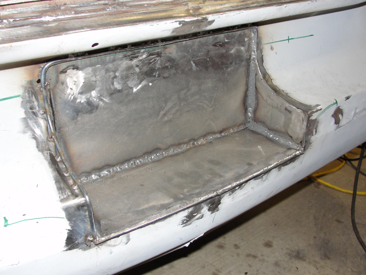

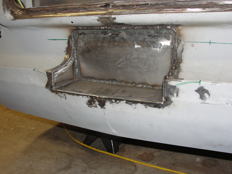

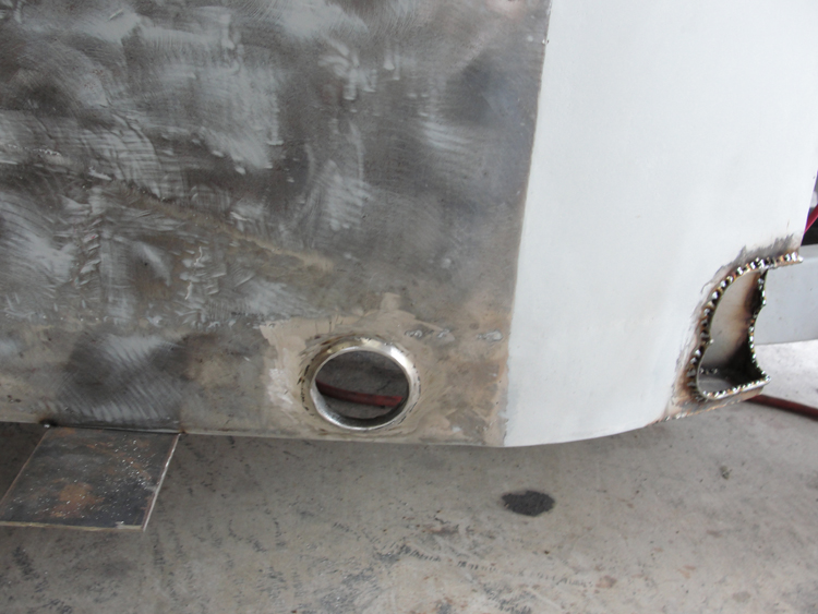

    Little progress, not much though. Tough time figuring out what to do with the license plate so I finally just sunk it in the rear panel. Put some round rod around the recess so the edges didnt look so sharp.

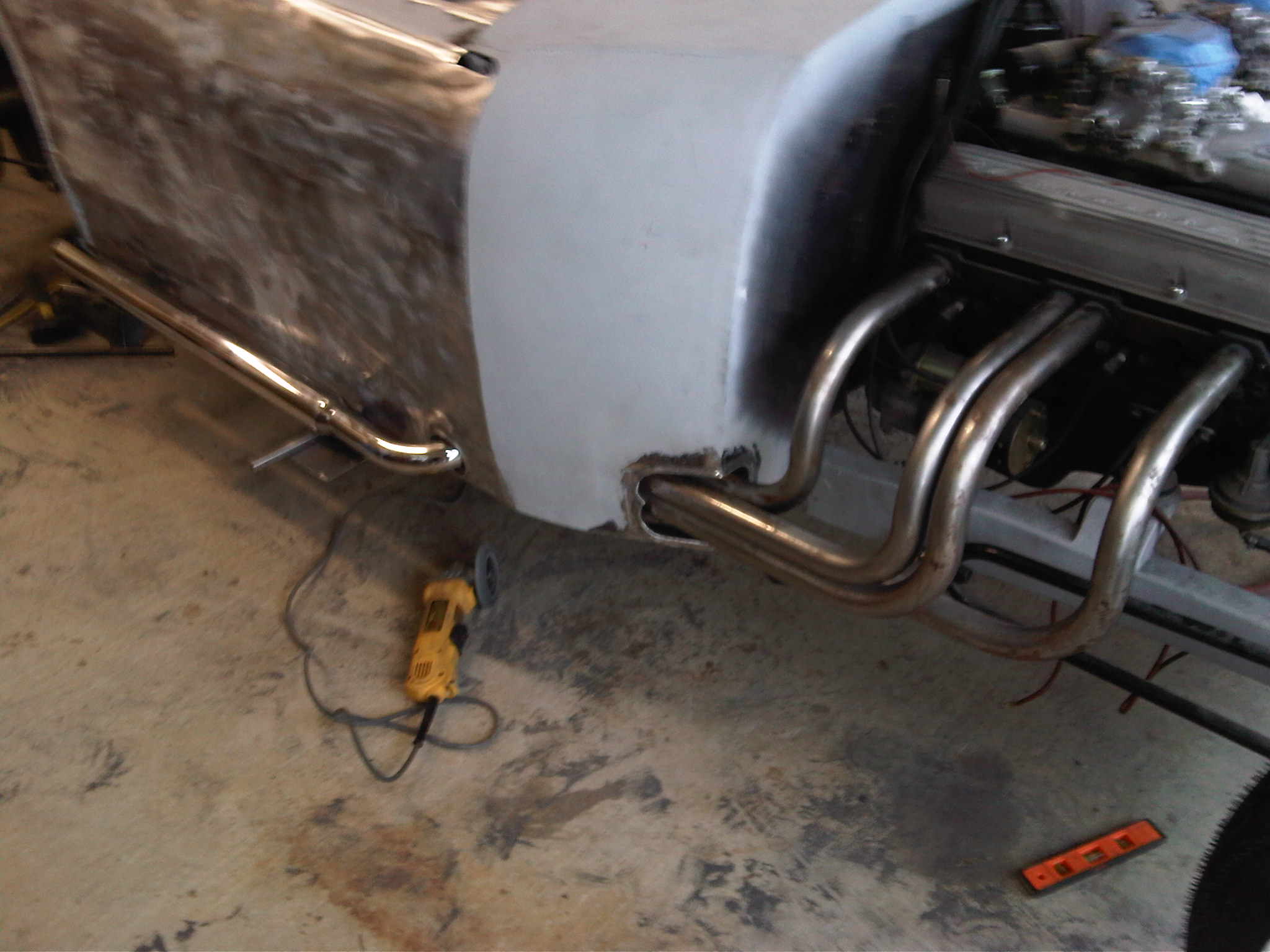

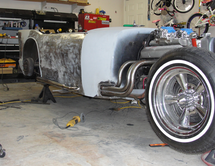

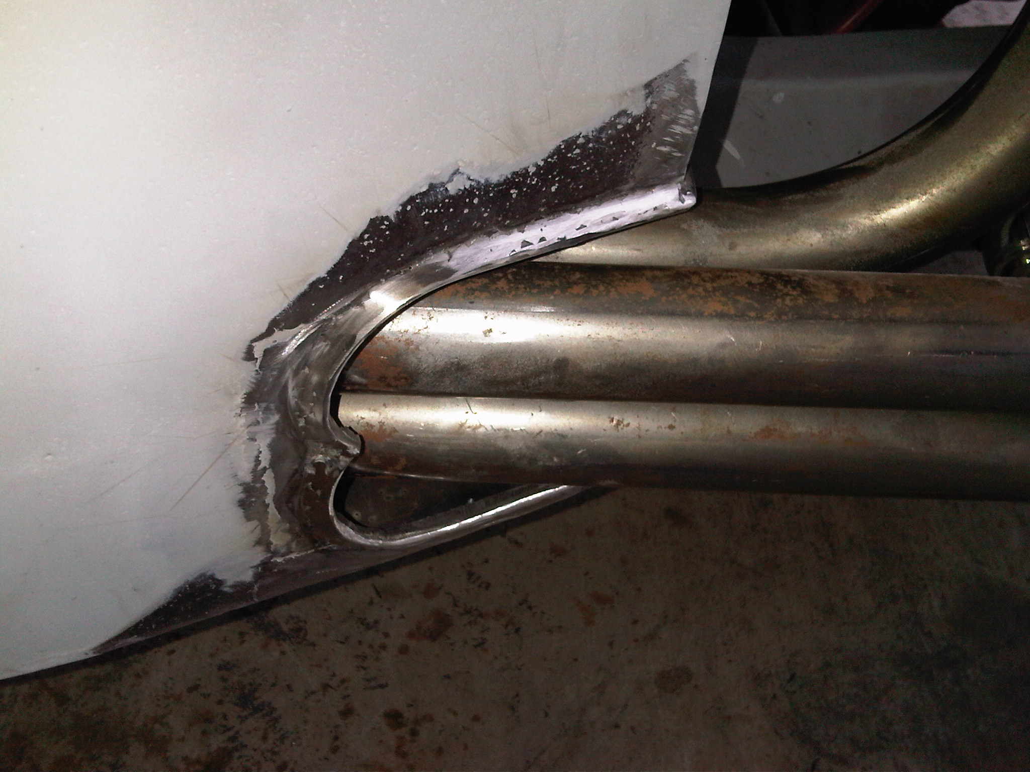

    Trimmed out the edges around the header opening with more round rod and the openings in the rocker area for the pipes to come back out of. Thanks to Robleticia for help on this. He loves to weld and grind! This stuff is quite time consuming for the small area you actually end up finishing. Pipes are just hanging there for the pic so yes, they will be level when mounted.

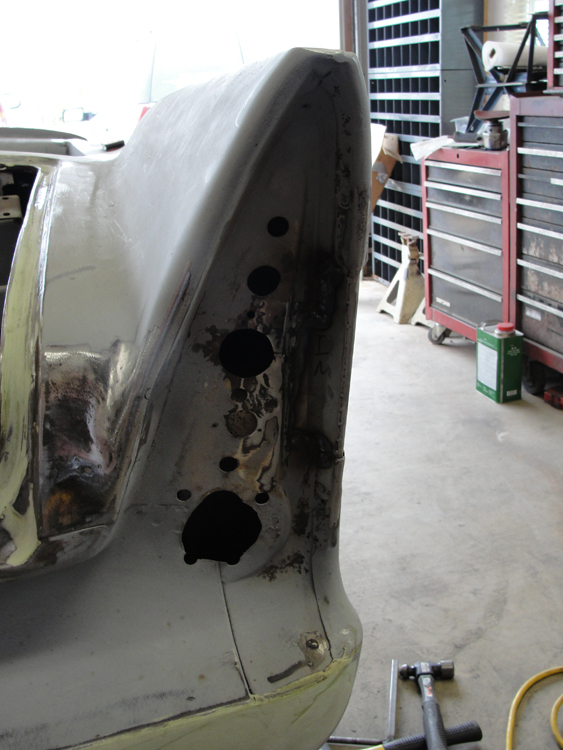

    The passenger side quarter had been hit at some point and was "straightened" with a sledge hammer and a torch I think. We ended up cutting part of it out around the taillight opening and into the quarter panel. Lots of hammering and pulling and we got it pretty close. Remade part of the taillight opening wrapping around into the quarter panel and a small section of the quater panel. Of course I forgot to get a pic of the quater and the piece had been patched back in. I am pleased with the repair as fixing that had been bugging me for quite some time.

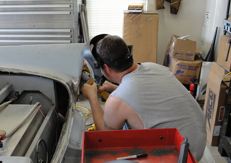

    Racrdad
    Robleticia laying down on the job again. Good help is hard to find! :D

    BrerHair
    Ain't it the truth? Somebody please help that poor man up!
    Not bad for a guy who just got whacked while jockeying.
    Nice progress, Doug!
