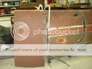

    This is my first project post on the HAMB and constructive criticism is welcomed. Pointers, tips and tricks that all you guys with lots of building experience have will come in helpful I'm sure. So after having the Lunar Lander and the Atomic Punk stuck in my head since the 08 Lone Star Roundup I decided I needed to have a shot at this show rod thing. This is my first shot at a build of this nature and my first shot at a car older than 64 so I am kind of winging this whole deal really. After a few months of keeping my eyes open and looking around I came across a 57 Belvedere 4 door. Loved the shape of the quarters and after a few days of pondering it I brought it home. I actually started on this about the first part of July and will post up progress pics as I get time. This is what I started with:
    Once I got it inside the cutting began. I cut it well oversize what I thought I might end up using. Easier to cut again than to try and make it bigger. With the car still on the trailer I cut the quarters and rear doors off in 2 sections.
    So with the car and trailer out of the way, the quarters with rear doors still attached are set up on some plastic crates to get a visual idea of where I might be heading with this thing.
    After gutting the inner structure out of the skins my buddy Rob helped me make the final overall width decision and tack it back together. Then the door skins were tacked onto the quarters.
    So we put a wheel and tire next to it and got another visual of where this thing is heading.
    Now that we have a good idea of what we need for a frame some 2 x 4 tubing is cut and welded up. Has a 16" kick in the rear. No crossmembers are put in yet in these pics just some square tubing to hold the main rails square. This is also the first frame either myself or Rob has built so we measure alot beofre cutting and welding. :D
    Fast foward a bit, the body is tacked into place on the frame with some braces to hold it in position for the time being and now I need a cowl. I probably should have had a cowl to start with but I kind of started building this thing from the rear towards the front. After some research I dont really think I am going to find a cowl close to the width I will be needing anyway so I figure why not just build a cowl. After studying the rear section of the roof on this car I think I see some nice compound curves that I can turn into a cowl.
    Decided the body was going to be to long once the cowl was added so some length was cut off of the door skins. Pieces of the donor skin from the roof being put into place. No framework for the cowl yet because I wasnt quite sure exactly how this was going to work out.
    Now to retain some uniform shape on each side and add some strength I started building some inner rockers.
    Next up is to build some framework for the cowl. Some 1" and 3/4" square tubing with a bunch of relief cuts so I can get into the proper shape was used. Its starting to look more like a cowl now.

    Took a little break from the cowl and decided to fill in the wheel opening on the quarters. Cut some donor panels form the front door skins, marked the quarters, trimed out the wheel openings and tacked the filler planels in place.
    Ok, got back to the cowl finally. Built the rest of the frame work for the cowl and used another piece of the roof for the top of the cowl.
    The dash from the donor car has been narrowed and tacked in place also and I'll put up some pics of that soon.

    How wide is the firewall? Seems a bit wide at first glance.

    It isn't really all that wide, it's just the angle of the pic. When the mock up motor is in there it looks just right! It's hard to tell from the pics, but if it was any narrower it would be a one seater!

    I've got an NOS tail light lens I can donate to the project. That frame looks a little spindly, hope you're intending to add some more crossmembers.
    Also hope you're going to run some kind of grille that will be reminiscent of the donor car. I always wondered what canted "quads" would look like if you started with a '57 Plymouth headlight/parking light arrangement.

    If it was me, and it's not, I'd have gone with a wedge-shape, wide at the back down to the width of the firewall/cowl area.
    Nothing wrong with your idea of a consistant width, and taper in at the cowl. Just personal preference.
    I'd also have tried to reshape the front-clip, into a useable set of sheetmetal which continued the taper.
    I'd also prefer to see a rake to the sheetmetal, tall in the back, down to a lowered grille area.
    Depending on motor choice, you might have more of the engine protruding up through the sheetmetal.
    The grille/face area needs to be distinctive. If the entire car is flamboyant, make the grille be flamboyant too. If the main theme is a narrowed, yet stock look the grille needs to be along those lines.
    Whatever you choose to do, use balance, so the whole project doesn't have any parts that look over the top in comparison to the rest of the design.
    Continuity and balance are the most important things you need to keep in mind. That, and be flexible. If something doesn't look right, try again, or try something different. You can always do something else and think about it, come back another day with a different view. That's the great part about doing a project like this. There doesn't have to be a deadline.
