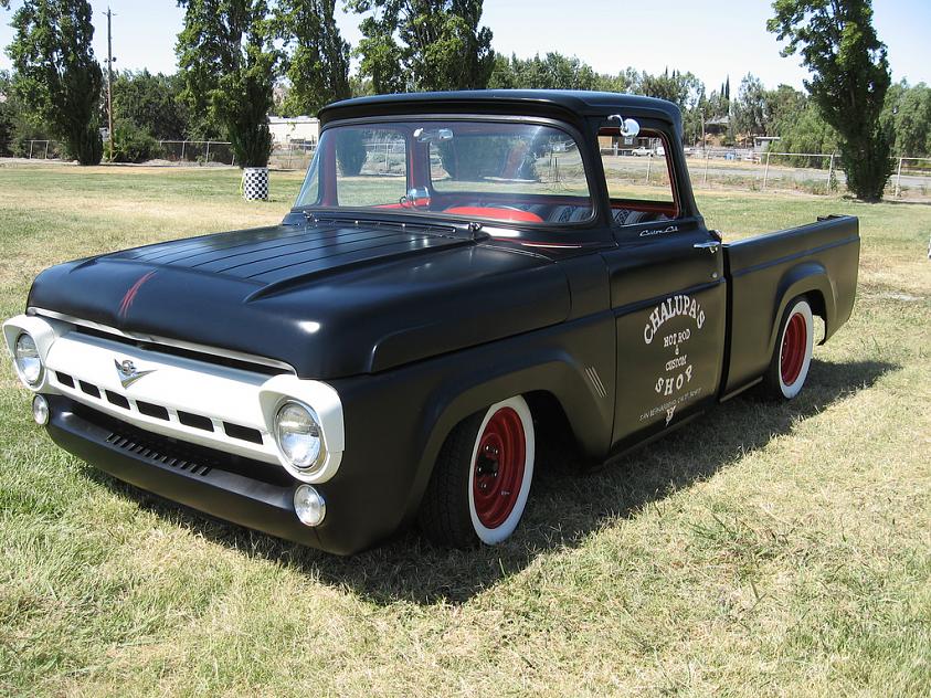

  5. 57f100
    Joined: Jun 12, 2007
    Posts: 63
    57f100
    Here is a picture of a truck with a 57 Grill and 59-60 Fenders and front valance.

    Hey "57F100" is that your black truck? Did you paint it? That paintjob is awesome, I've never seen a paintjob show off the body lines of our trucks more than that red one! Super cool, man, thanks for the picture!!!

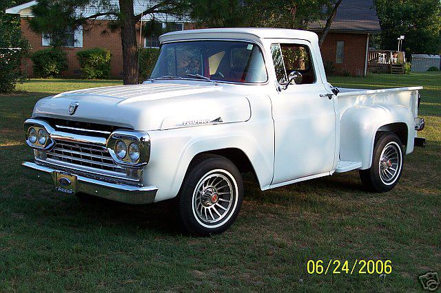

  11. This is super clean -and a little dorky for the HAMB- but still a good example of a '60 with a '57-'58 hood.
