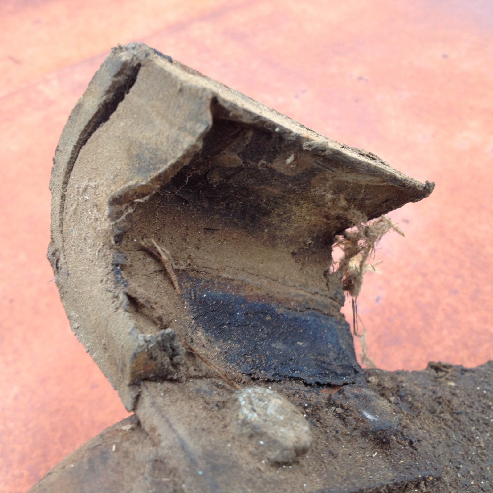

    Thank you for the engine d2_willys! I'm really glad I don't have to use a SBC. I'm almost ready to mount the transmission, but I'm not sure if the mounts are still useable. IMG_0135.JPG IMG_0130.JPG
    There also seems to be some kind of choke an the exhaust manifold. Is it best to repair, or disable it? IMG_0136.JPG
    Thank you!
  28. I have always by passed them because "I am a hot rodder!!!!!" If it is stuck try and break it loose and use it. If the spring dealy is bad I am sure if you look around you can find one and they are a good idea to have if they are in working order.

    The heat riser in the exhaust you can remove if you can not free it up making it function. The heat riser helps warm the cold started engine.
