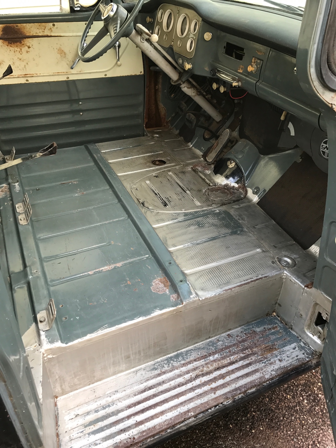

    Spent a bit of time pulling the gas tank today. Seat looks like it will be fine with just a new cover but the tank is history. Only the paint holding it together, nothing left of the pickup tube and sender float!

    If those are the original floors you are very lucky and way ahead of the game. Nice truck.

  5. Floors look great!! I had big holes in mine that I had to patch.

    Floors are spotless!
