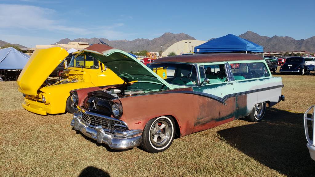

    Aero star springs will sit about the same ride height you have now but ride much better, this wagon has Aerostar springs and Granada spindles rear springs are stock other than having polyethylene liners between leaves 20181116_145438.jpeg

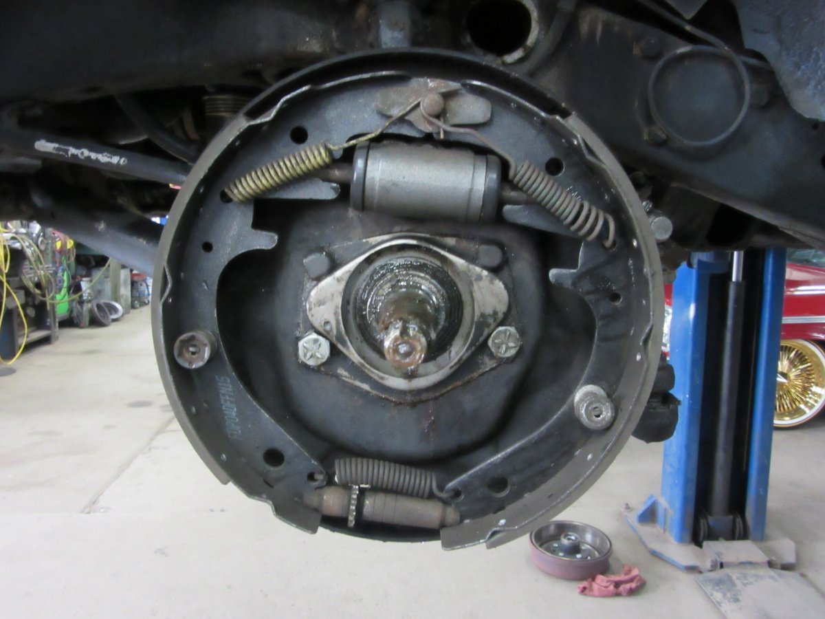

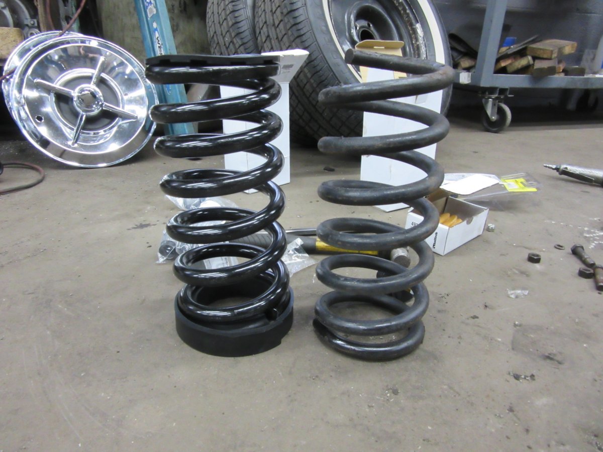

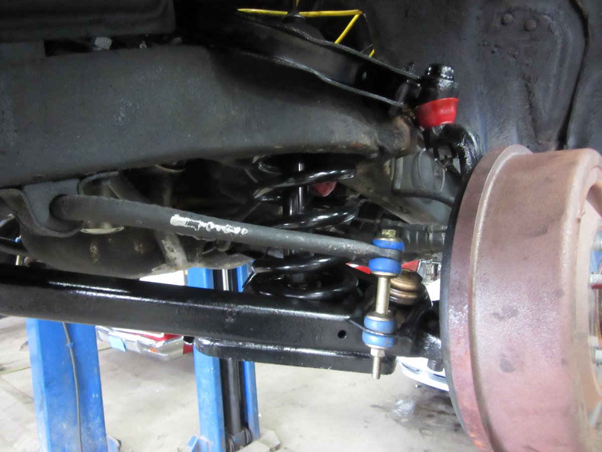

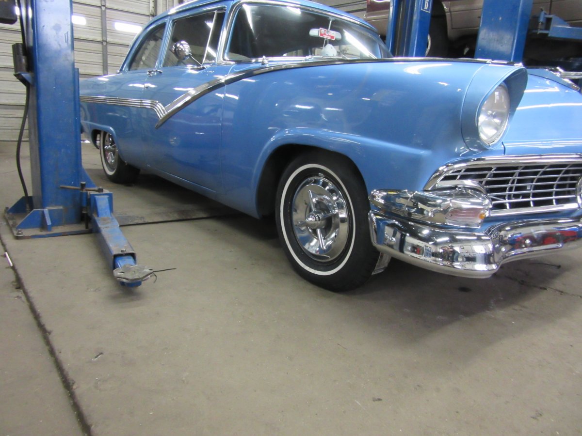

    I installed the Aerostar springs along with the lower ball joints outer tie rod ends and bushings. I also fixed the brake shoes the PO installed backwards on one side and changed from 215-75-15 tires to 205-75-15 tires on the front. I am shocked at the improvement in the ride. It's like going from a bi-plane to a 737. Now if only there was a Granada left in a junk yard.

    Agreed, I used the Energy Suspension boots (they only had red, (Amazon Prime), but I didn't buy the front end kit as I only needed lower ball joints, bushings, and outer tie rod ends. I did order extra boots as I was planning on separating the upper control arms from the spindles to clean them up and paint. I also ordered the Energy Suspension bump stops because they were shorter than the original but I did not realize they bolted through the ball joint. If I had to do it again I would either get the original part or at least measure the bolt. I ended up cutting the stud off the bump stop, drilling it out, and through bolting it. By the way, when buying outer tie rod ends for a 56 Ford, the are both left hand threads (just in case anybody was wondering).
