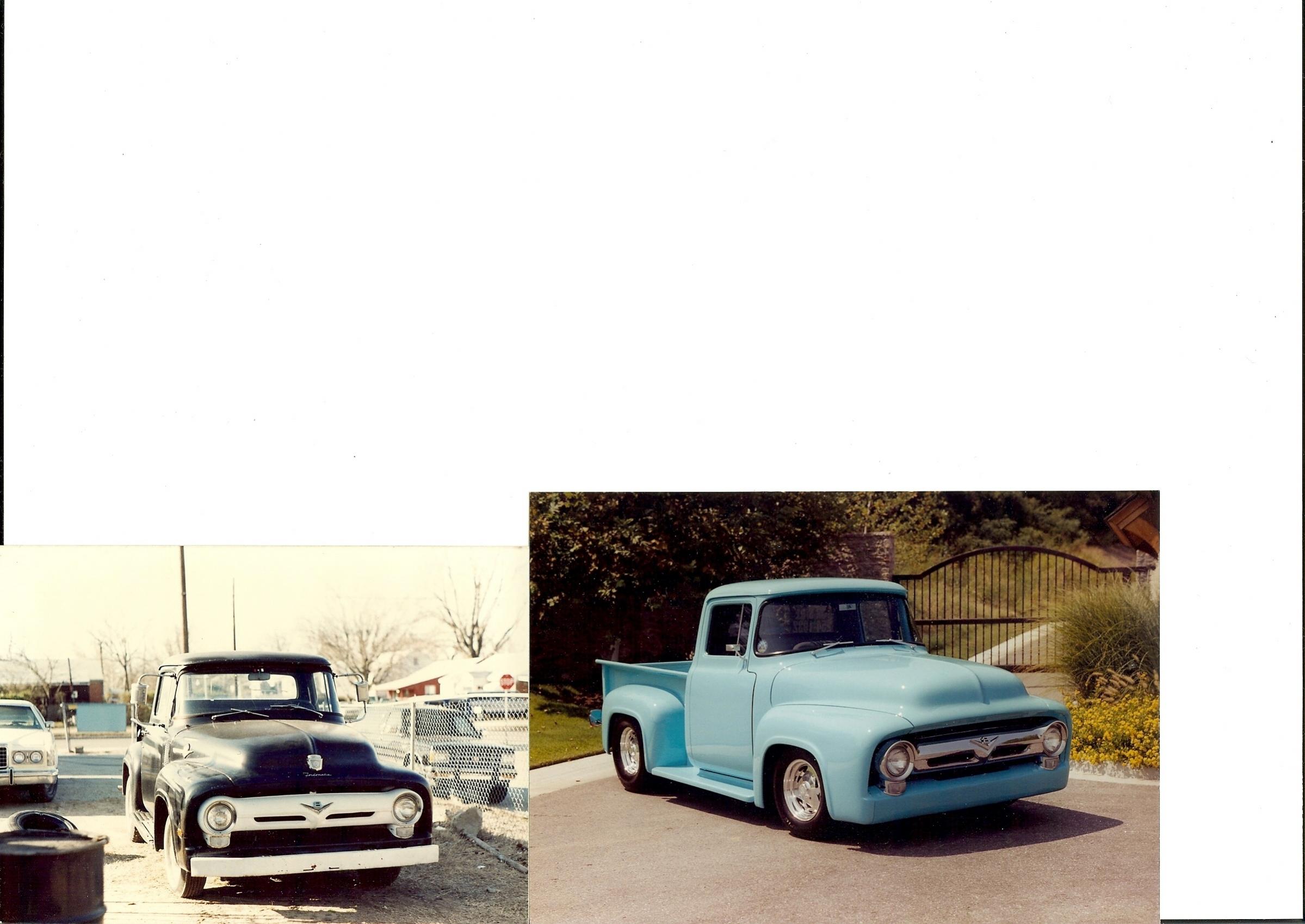

    I have a Gibbon MOPAR B-body torsion bar front on my '56... great ride... adjustable ride height... bolts on... uses a MOPAR manual box or P/S depending on your engine. You'll need a 71-75-ish coronet, belvidere, fury, cordoba, etc. donor car. for the a-arms, t-bars, steering box and stuff.
    Bullet-proof deal... under $500.00 clams. I believe Dwight Bond's brother still makes 'em in Gibbon, NE. I have a number for Dwight... 308-468-6237.
    This is at ride height w/o the Hemi... goes about 5" lower...
