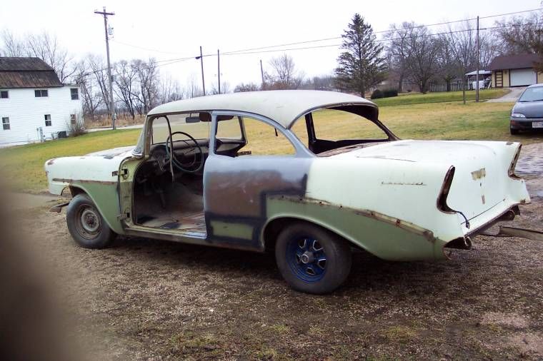

  21. Squablow
    Joined: Apr 26, 2005
    Posts: 17,438
    Squablow
    That's exactly right, I'm referring to the striker post and not the hinge area, I've always referred to that as the "jamb" but that might not be the right term. That part is different on the 2 door, not just because the quarter butts up to it, but there's a different shape there as well, the 2 door door won't shut onto the 4 door post, even if you move the post into the right position. There was another guy on here that did a conversion using just the doors and not the pillar or rear quarter pieces, he had to cut a chunk out of the 4 door front door and weld it into his 2 door sedan door to make the door close on the original relocated 4 door pillar.
    The conversion is pretty much all done, I have the doors off in these pics since I'm doing some work on the bottoms but they open and close real nice with good gaps. The car is at a friend's shop getting some mechanical stuff checked out, then I've got a couple more body welding things to do to it (front fender eyebrows, a couple small trunk pan patches, the aformentioned door stuff, ect) and then it'll be off for paint.
    Thanks for all the comments. I've got more pics too, will upload them when I get a chance.

  22. Squablow
    Posts: 17,438
    Squablow
    I think that would look neat that way. Wouldn't look factory, but I like the sport sedan roofline and I'd like to see one done with 2 door hardtop front doors, would give nice proportions to the car and would clean it up with less jamb gaps in the body and trim and 2 less door handles.

  24. Squablow
    Posts: 17,438
    Squablow
    If you use the 4 door pillar, you have to modify the 2 door sedan door to make it close on that pillar, they're not the same. You could use the door skin from the old back door to fill in the gap, the inner section wouldn't be the same, but with fixed rear quarter windows, it would work.
    You could also just go buy two new doors and two new full rear quarter panels with the jambs in them (they make them now, for '55 at least), weld all that into the 4 door body, add some kind of inner rear panel and again, fixed rear quarter windows (unless you could buy those somewhere) and you'd have it all together without any donor parts. Would be expensive but would work.

  28. Squablow
    Posts: 17,438
    Squablow
    We got it running, and all of the welding is done on the conversion. I've still got a bit more work to do on the repair of the door bottoms (my 2 door sedan donor doors were pretty rough) and I have to put headlight eyebrows onto the fenders, then it'll be ready for the body shop.
    It's at my friend's shop now getting the mechanicals sorted out, when it comes back I'll post up a bunch more pics. Everything so far has turned out really nice, just like factory.
