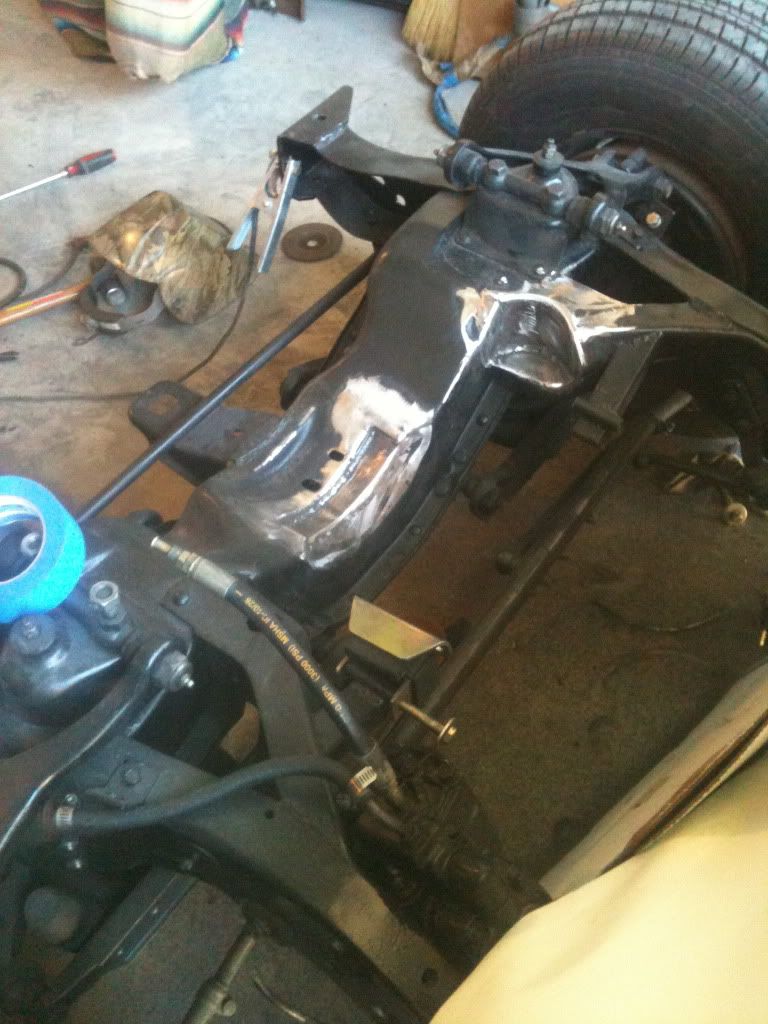

    Modified the frame to clear a mechanical fuel pump & give the new, bigger balancer a little breathing room.

    Enough space around that fuel pump to accommodate engine movement under torque?

    Pretty sure. In the pic, the bolts aren't tight - It'll probably suck in a bit more toward the block when it's all finished. Also, this motor is no beast.

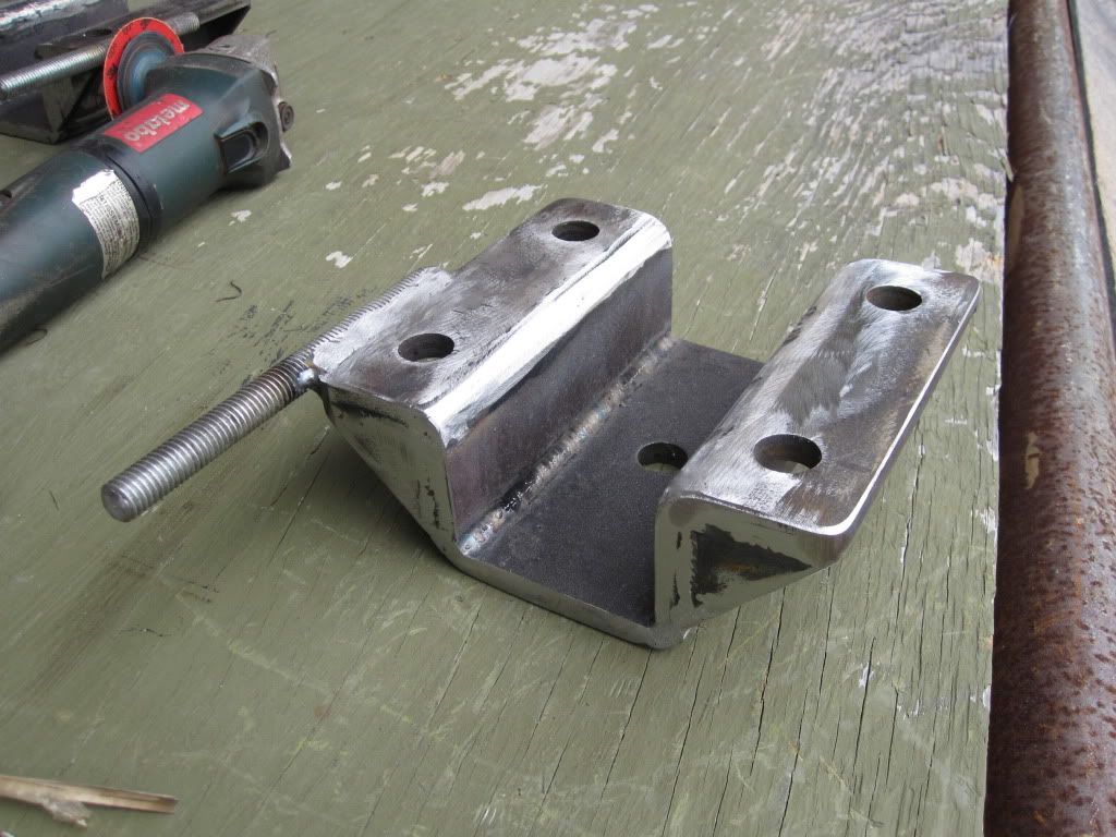

    I decided against airbags. When I initially got the notion to bag my car, I had just finished installing a tri-4-link in a friends car. It came out well.
    But...I don't want this car 90's low, I want it 50's low. I scored some 3" dropped leaf springs from Jamco and had a set of 4" - 2.5 degree tapered lowering blocks. Definitely lowered the ass end, but the u-bolts & lock nuts + the stock shock mount hung below the dreaded scrubline. I found a picture somewhere of a leaf spring bracket that corrected that .
    I made a set.
    Tried 'em out. Nothing was tight, and it was above the scrubline by about 1/2". Ain't much but I'll take it.

    Did you get that using stock suspension? I don't think my car will be that low... The rear physically can't go any lower without sticking stuff beneath the scrubline.
