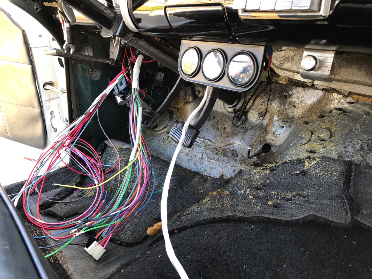

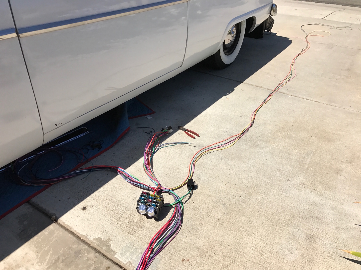

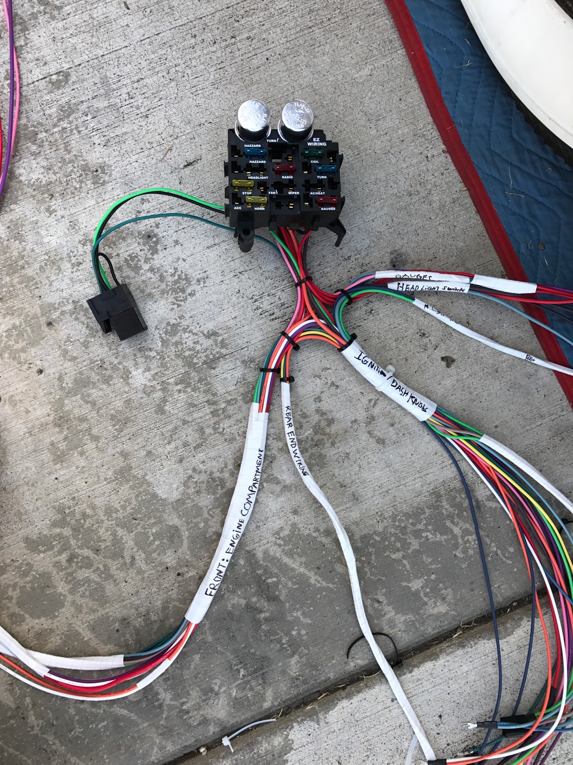

    Wiring is going good. Got about 2 hours into it. Most of the time was figuring out the best way to run the wires to the rear. With the way that Ford originally ran the tail light and fuel sender wires, I had to extend the left side tail light and fuel sending wire a hair because they wouldn't make it all the way into the trunk. Going to start on the dash when I get home and hopefully finish today. Need to get heat shrink.

    Almost all the universal wiring kits are "GM friendly" this creates an issue in these 50's Fords because the GM cars headlight switches are different from the Fords,GM has two "hot" leads and Fords use only one. Contact EZ wiring Tech for info some the guys in the 1952-59 Ford Group that used Rebel Wire did that. Or if you have this: http://www.speedwaymotors.com/Book-How-To-Wire-Your-Street-Rod,2824.html

    You need to use the one in the link I posted,a regular reducer 12 to 6 volt will not function with the fuel gauge the one in the link will handle all three gauges. If you run 12 volts to the gauges without the one I posted they will end up toast the one in the link is under $20,DO IT Right.

    These were originally wired to 6v with no regulator or reducer, is there a reason a 6v reducer wouldn't work? Haven't heard that yet or seen it. Very curious. Thanks for the info

    Wiring all done for now, will post a pic soon, but for now I just want to drive this thing while I can, before I tear into the front end. Ventura Nationals are coming up and need her running until then!
    I may or may not have somehow lost the brake light circuit somewhere along the floor before it made it too my trunk... so I need to pull the carpet up and look for it. I'm 99% I didn't trim it so I'm not sure where it went. I taped it all up before install and double checked, but I guess shit happens. We will see!

    Ignore the battery cable ugliness. That will all be sorted out. Here's a rough install pic gallery. Kind of want to change it up a bit. We will see.

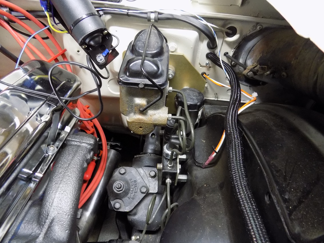

  23. Wiring looks good! I ran the wires to the rear of the car right down the middle of the car, to the right side of the trans hump. I made up a harness board to replicate the dash locations. I had 2 major legs going out the firewall, one for engine and one for lights.
    Summit makes a nice braided wire wrap that neatened up things a bunch and I can access the wiring to add or change things if I need to. Half the price of what Painless sells.

  24. This is some of the wiring routing.

    Yup. That's how the factory ran power to the rear. There's an indented wire track specifically for it that goes from the cent front of the dash all the way to the rear seats and then into the left side inner wall of the quarter panel. I followed suit and taped up the whole run and utilized all the factory wire holders. Works well and don't even notice it's there. Can barely even feel it.
