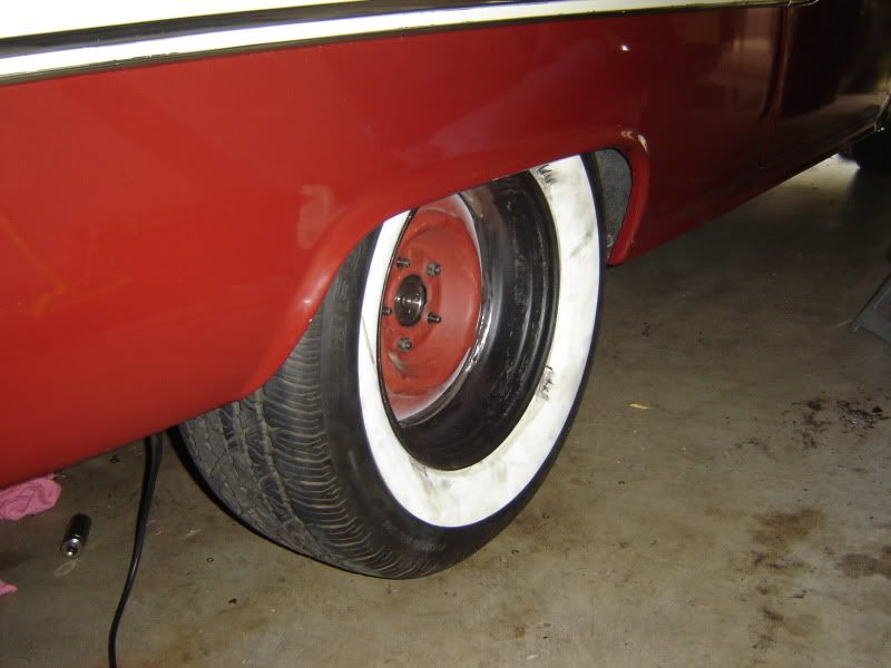

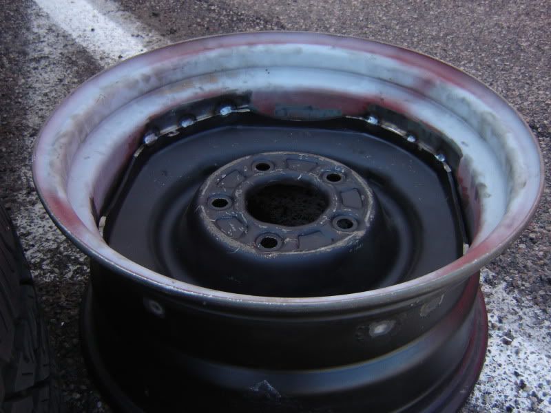

  12. I wanted an Olds/Pontiac rear end for my '55... I wanted one bad. I looked for a while but decided to just go with a new 9 inch Ford. I went 1 inch narrower per side and had my steelies reversed (by a Hamber if he recognizes his work!) to make up for the 1 inch difference in rear end width. One of the best modifications I made to the car! Tire changes with the stock rear were brutal. I had to deflate the tire and wedge the flat tire between the fender and the rear end. I was almost at the point where I'd have to remove the shock just to change a tire. I'd have been screwed if I got a flat out on the road someplace.
    My small block makes more than 400 ft/lbs of torque and I have a five speed. I decided to go overboard on the running gear just so I was assured that I wouldn't have a problem. I went with a Strange pro nodular iron (is that right?) center section with trac-loc. I ordered a "round back" ford rear because it looked more stock. Ford's SVO drums and axle flanges were drilled with the chevy bolt pattern.
    I'm pretty sure I'm into this rear end for less than I would have for an Olds/Pontiac posi in the same width and right bolt pattern. Also, gears in various ratio's are much more plentiful for a Ford 9 inch.
    pics:
    First prototype:
    Here's the prototype on the car:
    The finished product:
    Skip the billet wheels and spend the money on a rear end!
    I posted more info here:
    http://www.trifive.com/forums/showthread.php?t=29131
    Oh yeah... after the driveline mods I bent the springs pretty badly. I often drive it like I stole it though. :) You might think about that too. After I got new springs I ended up putting Caltrac bars on the car.
