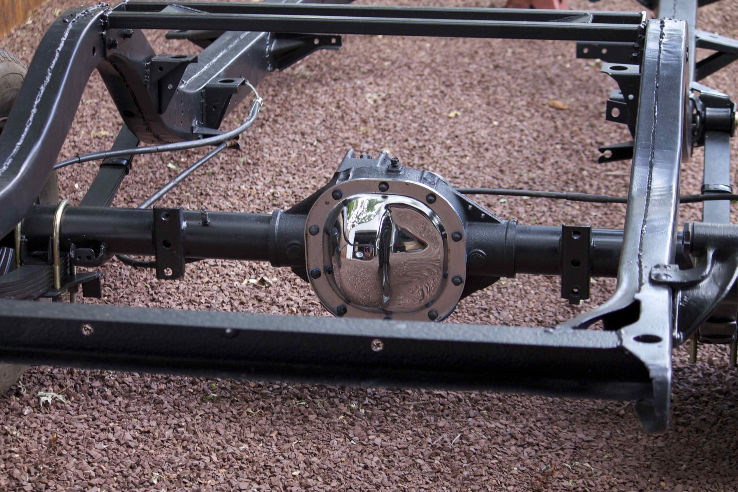

    Ford Explorer rear- it is the correct width. Weld on new perches and bolt it in. Cheap, plentiful, and strong. Can even get them with disc brakes!

  27. PASTDUEBILL
    Joined: Apr 6, 2008
    Posts: 825
    PASTDUEBILL
    How do you keep the driveshaft from thumping the tunnel with a chunk that is 6 to 8 inches off center?

    Joined: May 29, 2007
    Posts: 2,186
    55chieftain
    More like 2" off center. And just as strong as any 12 bolt . Also you don't have to pay outragous prices the restorers are getting for 12 bolts.
