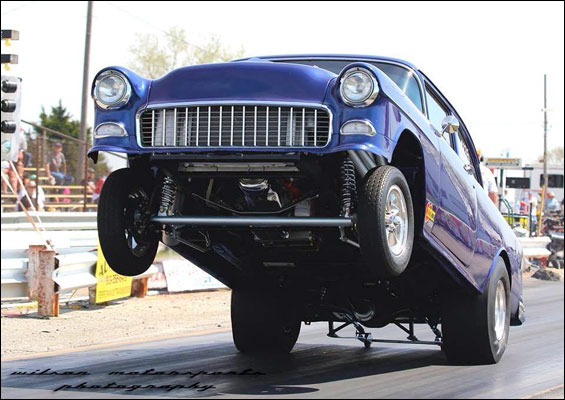

  9. High5
    Joined: Jul 2, 2012
    Posts: 185
    High5
    Running ladder bars without a floater kit will cause the suspension to bind.
    The cleanest way raise the back of the car is to place the springs on top of the rear axle (like mine in this photo). You can use air shocks but the ride will be rough. The stance in the photo is with the engine installed.
    Here's what the underside looks like. The air shocks had not been hooked up at the time of this photo and will get the minimum pressure to run them (which should not affect the ride). These floaters were hand fabricated. But you can buy something similar. I also installed a panhard bar.

  23. I have to ask. You had ladder bars on leaf springs and when you pulled the ladder bars the rear end didn't flop all over the place? Ladders and leafs have to have floaters, that is why it growned and clunked and eventuallu pulled the heim joint from the ladder bar.
    As far as ride height, that is your choice. if it doesn't look good to you then change it. Some of the fellas will tell you that it needs to look and ride like a lumber wagon and others will tell you that it needs to be more of a subtle change in ride height. End of the day it has to look like you want it to look.
