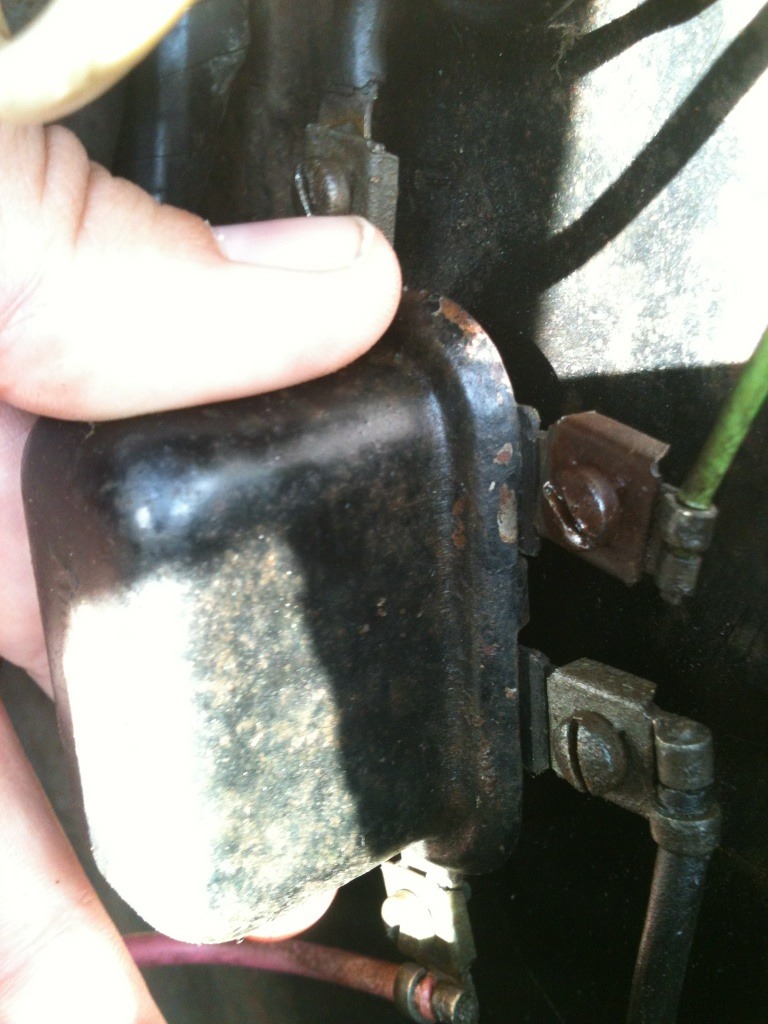

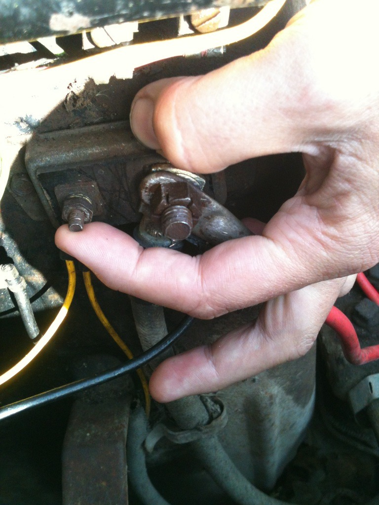

    Okay, this ole girl is giving me fits, still no crank. I threw a test light around the engine bay and here's what I have so far (I went through the fuse box and all fuses look good) - ImageUploadedByTapatalk1349111442.212919.jpg
    This unit (after cleaning) is lighting the test light on 2 of the 3 terminals, except ground (normal)
    Voltage regulator? Has 4 terminals, "Gen" (no light-normal)
    "battery" is lighting
    "F" (no light) what is this connection?
    Ground (no light-normal)
    Starter Solenoid?
    The large lug (from battery) is lighting on all wires
    The small lug has no light
    This small module has 4 terminals that connect to the voltage reg
    "1" "2" "3" "4" and none of them are lighting the test light
    I removed, inspected and cleaned the starter switch on the Stromberg carb and it's in really good shape. I checked the connections and I have no light-even pushing the gas pedal and neither wire is lighting.
    Any suggestions?
    Something seems to be preventing starting energy-
    Neutral switch? Where is it?
    Thanks for any help guys
