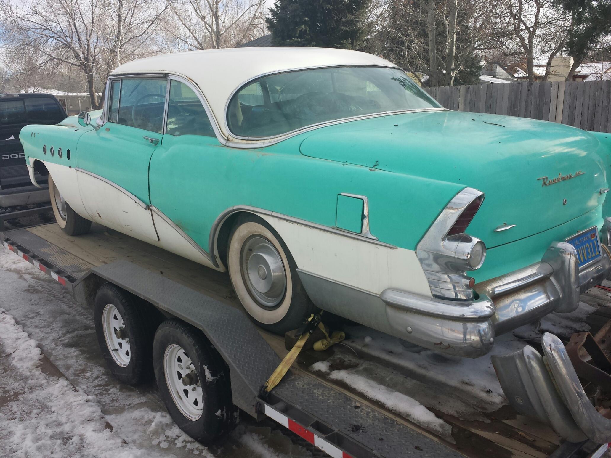

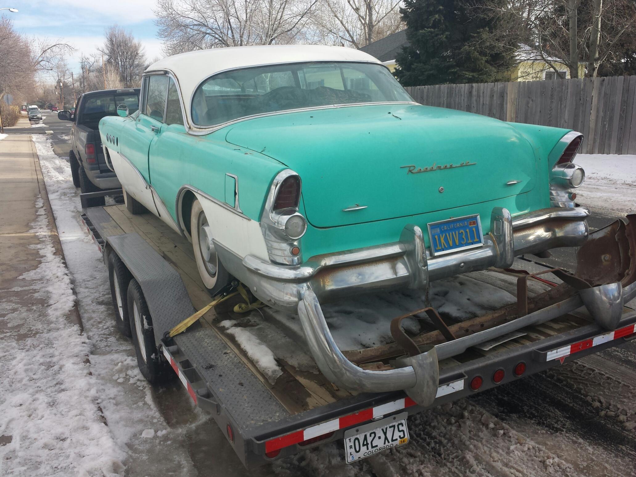

    well finally drug it home with minor casualties of travel....
    kidcampbell71 and tb33anda3rd like this.
  3. Squablow
    Joined: Apr 26, 2005
    Posts: 15,037
    Squablow
    Looks pretty clean. A friend of mine has a '55 Roadmaster with a 500" Caddy engine in it, he has a 4 link with a 71-87 Chevy full size truck rearend. The rear was a good width and has the same 5 on 5" bolt pattern as his front drums.

  6. NICE...i remember picking up my 56 olds in rock river wyoming almost 2 years ago come feb 4th..seeing yours on a trailer and some snow made me smile..im sure your were like me soo excited and proud as you drove it on the trailer home..cant wait to see your progress..:D keep posting

  8. Munster Motors
    Joined: Jan 23, 2012
    Posts: 457
    Munster Motors
    yeah i seen that on t.v. that thing moves!
    i was very excited to get it! snow on the ground and high winds we made it back from Loveland,Co.
    thanks this thing is really solid for the age, been trying to grab it for about 2 yrs now and finally did...just need to get my 56 plymouth on the road and driving before i can mess with it tho
