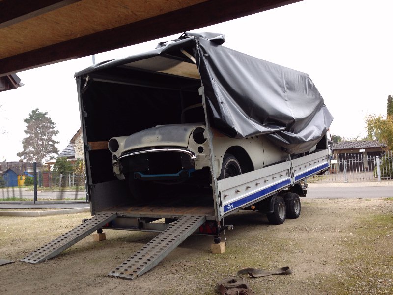

    i bought my project in december 2013, it arrived april 2014 from the US and since june i begun restoration and kustom process. its a 55 buick special hardtop coupe, she is called mary lou.

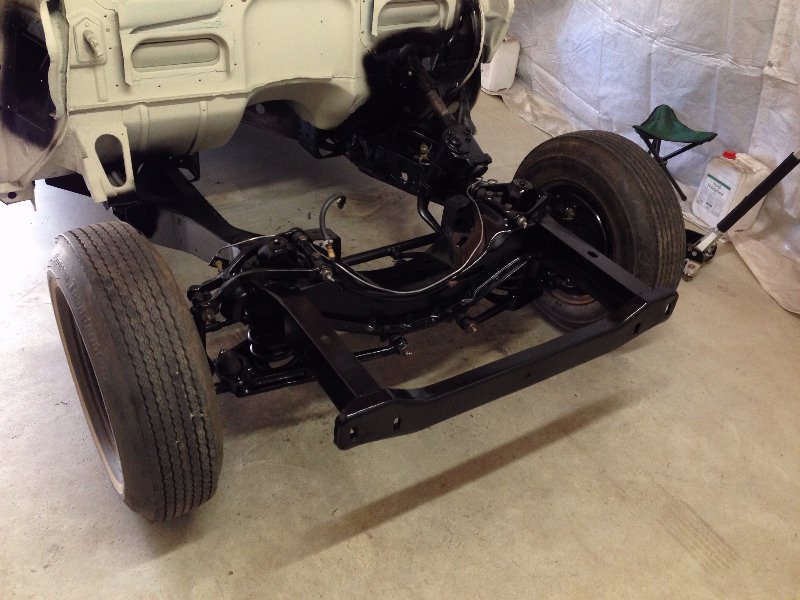

    so i decided to get the body nearly complete to bare metal...
    front end is like new, all with EP primer and chassis black.

    after movement of the car in november 2014, i had room and time for the engine, wheels, interior and details...

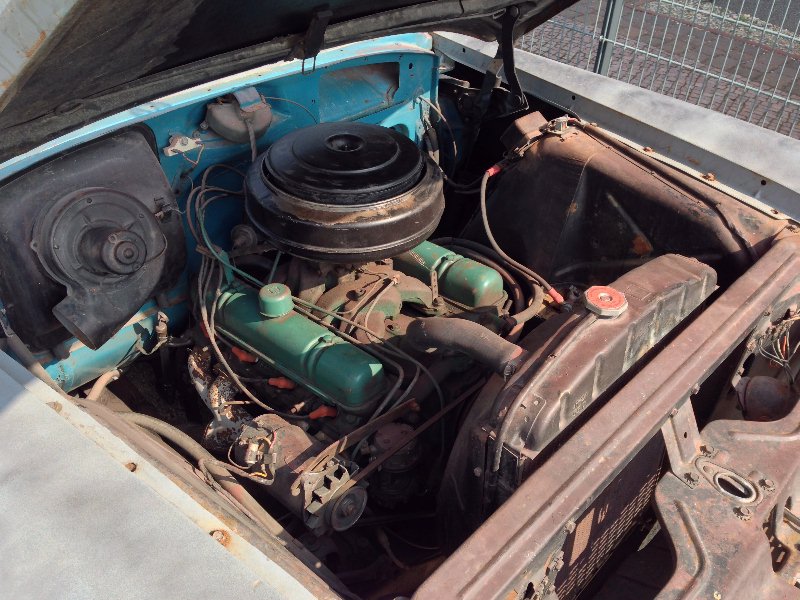

    then I started to dissambly the engine to check everything, new gaskets, painting it and so on…
    from the preowner I know it was completely overhauld less then 2k miles ago!
    And yes it runs perfect and inside it looks like new!

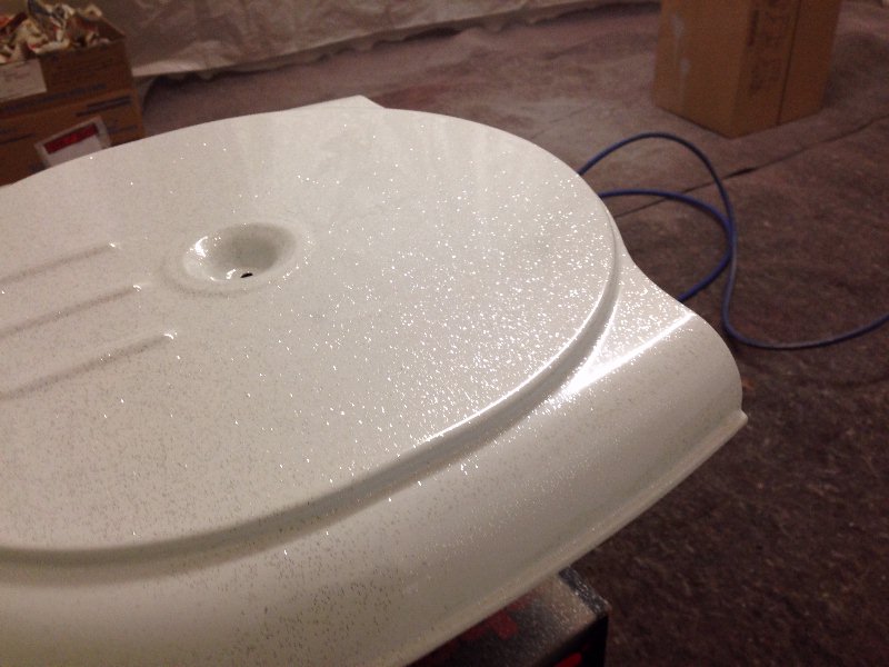

    Caddy style air filter housing, also painted frozen white with flakes.

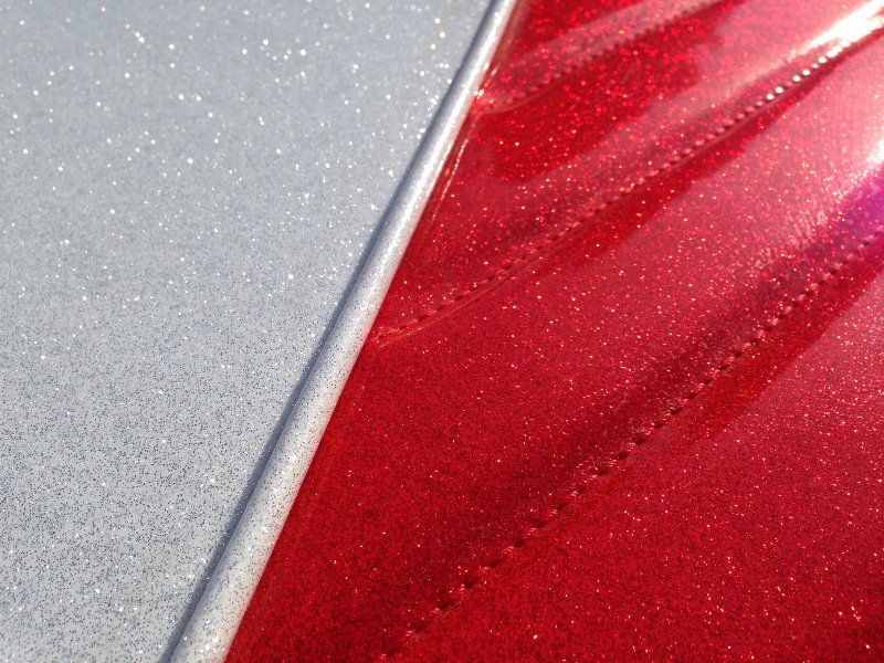

    got my interior back last weekend, LOVE it or HATE it! :)
    here a small teaser...
