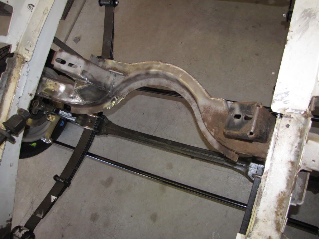

    over two dozen tube axle installs so far , i gotta go with the speedway deal. got one in this ....
