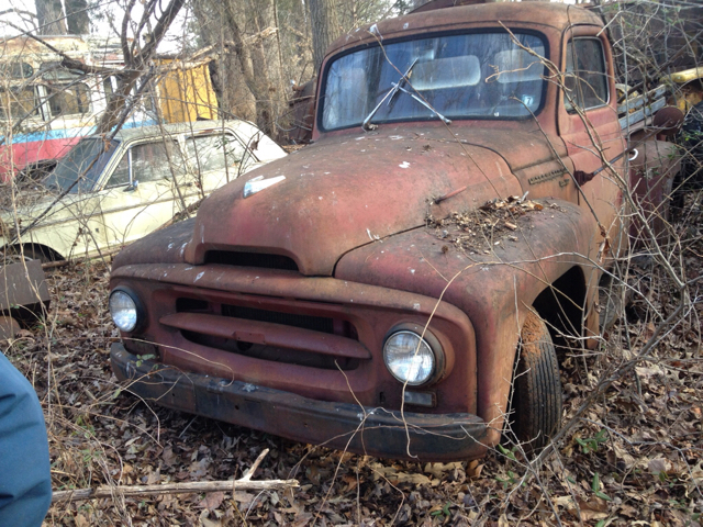

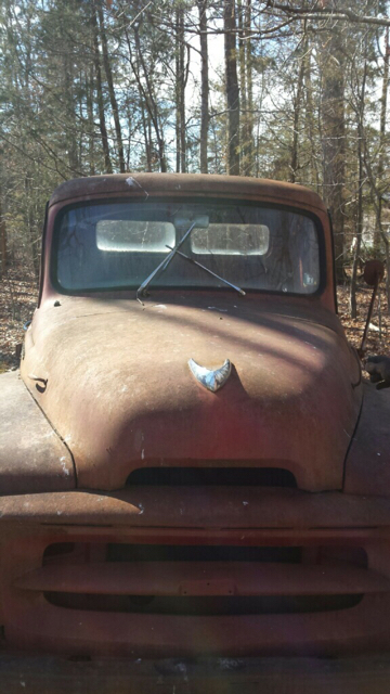

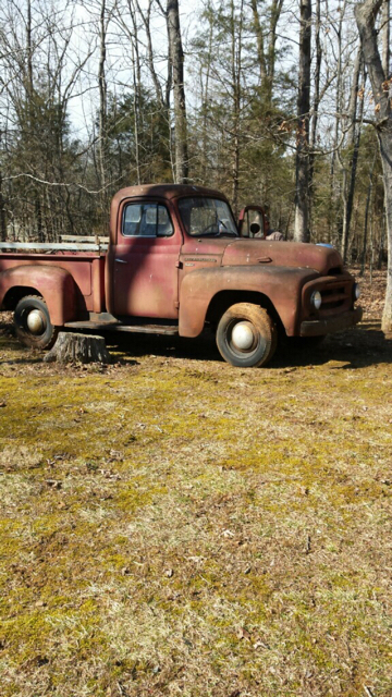

    This truck was gifted to me by my Grandpa.
    I've decided to go with a traditional restoration with a few customizations to make it my own. It's mostly solid as it was a NC truck so it rusted from the top down.

    Looks pretty good.I really like it that you are doing an IHC,something different is cool. How do you plan to modify it?Are you going to keep the original engine?

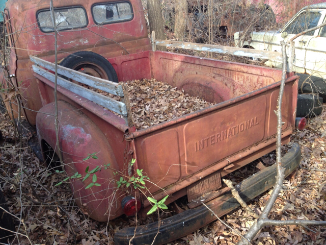

  4. Im planning on taking off the rear bumper since it was optional back when manufactured and fabricating a plate to hold tail lights. Also going to fab a wood deck for the bed. Straight pipe exhaust so you can really hear that signature diamond engine sound. I've already gotten the old SD 220 in line six runing good. Had to rebuild carb and fuel pump. Also took a few weeks to get the engine freed up properly

    Nice looking R that is going to be a neat project. That rear bumper and brackets is worth some bucks to a restorer. Most have no rear bumper or have a dealer installed aftermarket heavy duty bumper that is a factory installed rear bumper you have, will work for all L-R-S's

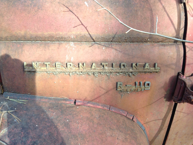

  10. The L R and S series's were made in different time periods one after the other. Before the L series was the K series I believe. You'd have to google it for the dates. The numbers after the letter designated the type 1/2 ton, 1/2 ton HD, and so forth up to line haul tractors.

    I'd suggest to hold on to the rear bumper. I wish my 46 had one.

    With the idiots on the road these days its not wise to have no rear bumper.all my vehicles have both bumpers and I have been hit in the rear many times.

    Great project. Keep the bumper.
