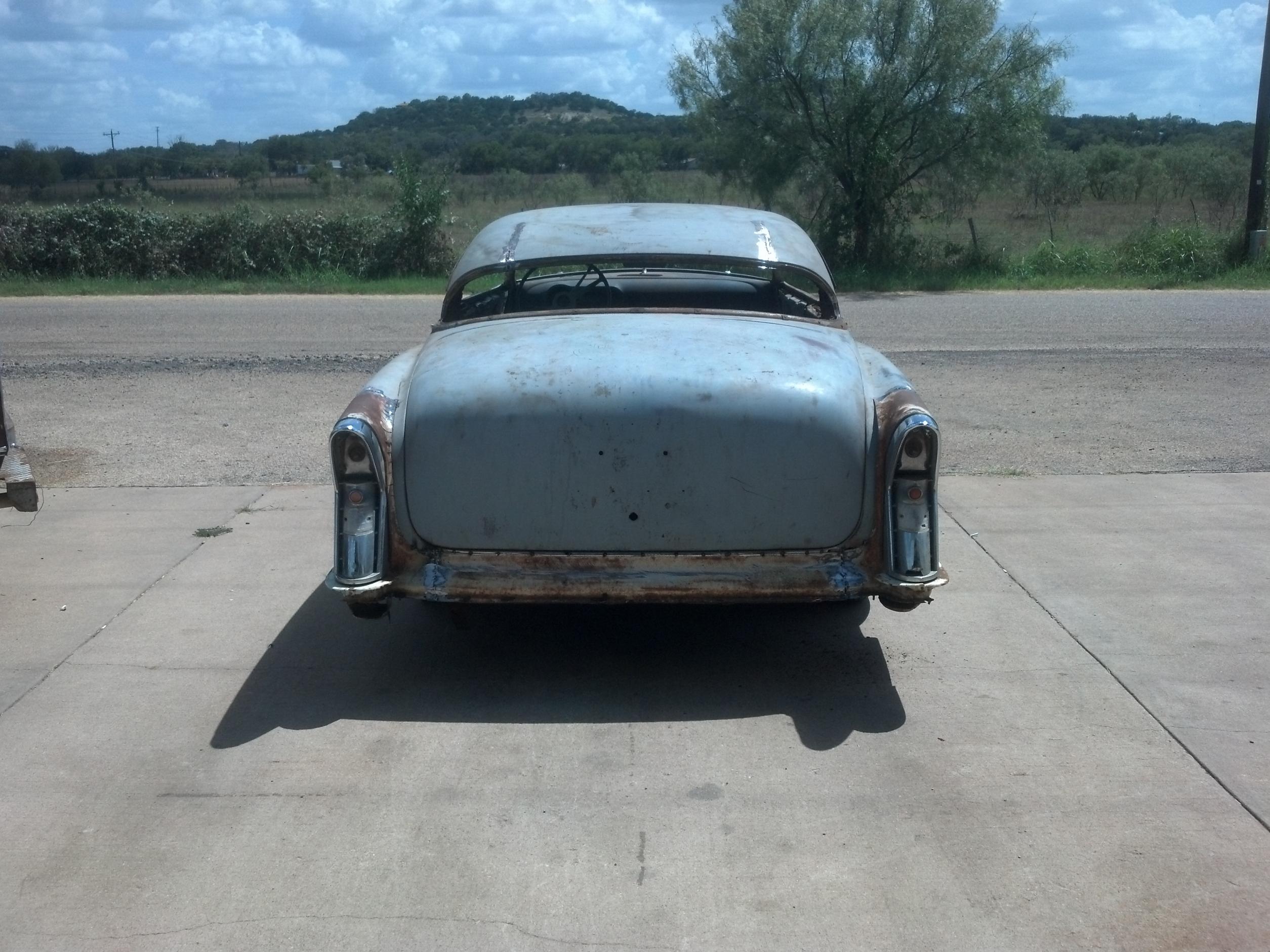

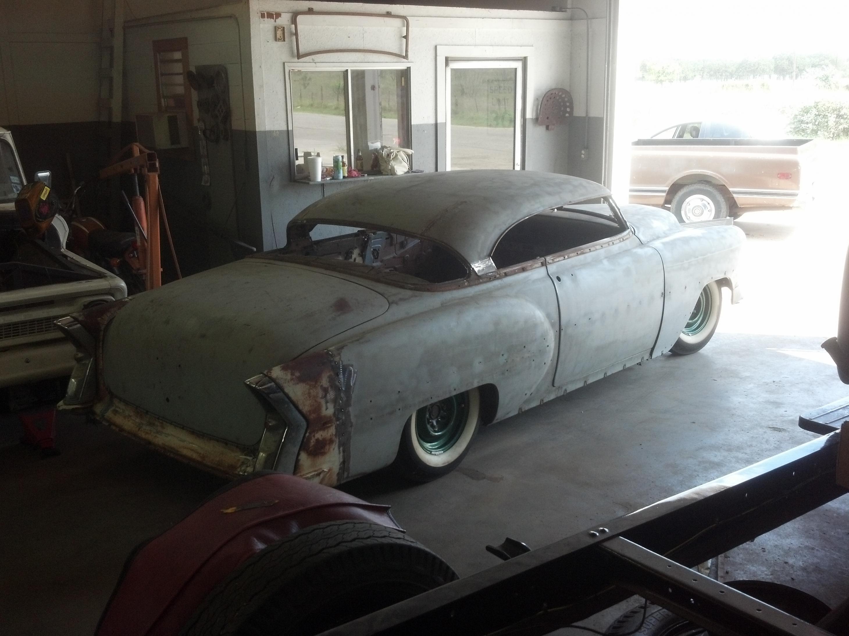

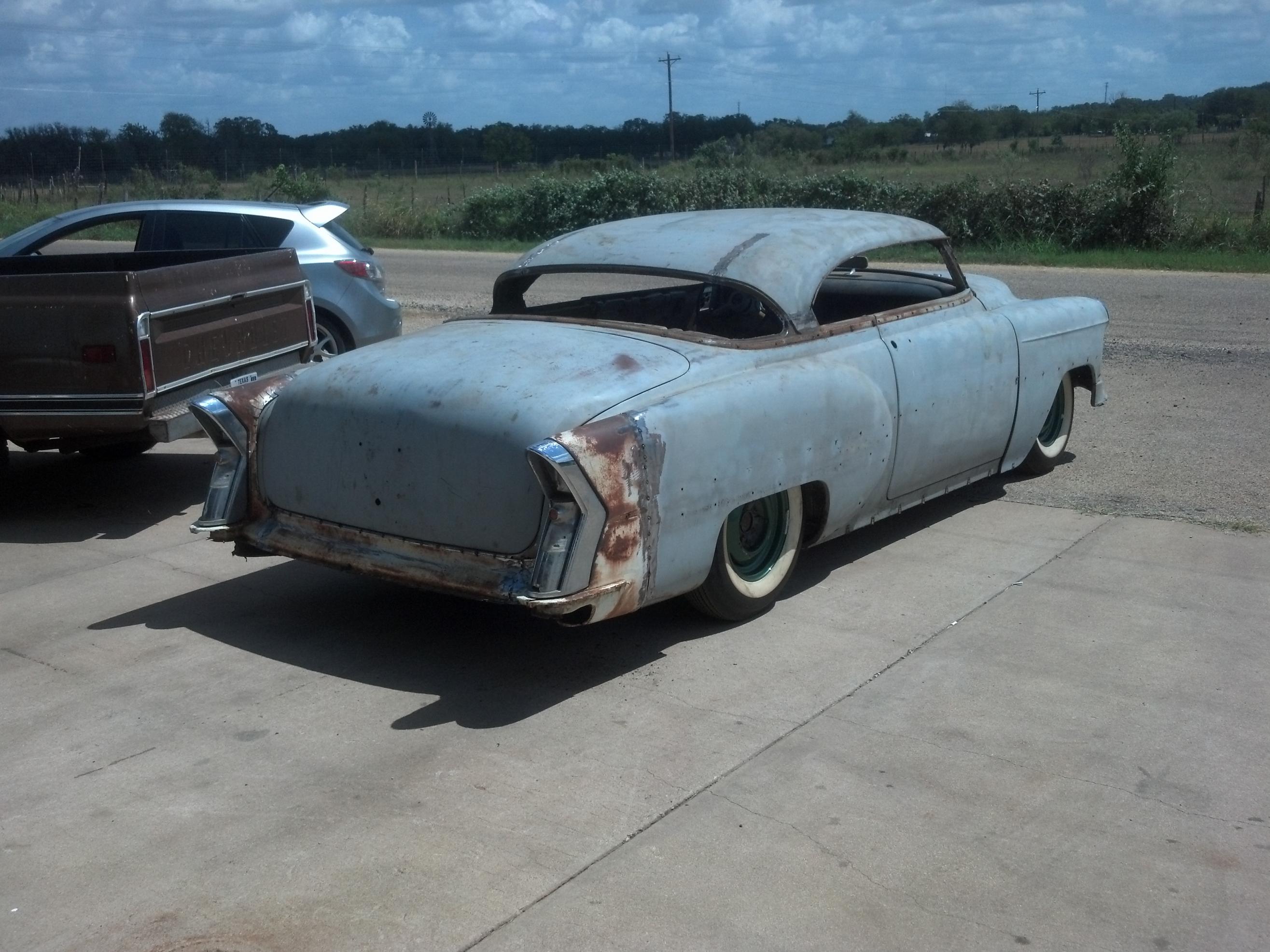

    my 54 i just chopped 3 in and buick taillights. mustang 2 with bags front ,triangulated 4 link in rear. next question is what front bumper ? really dig 57 buick?

    the point is to accent areas of the car were there was a lack of height. like the height of the sides and i have seen to many of the packard tails done.

    i think they look bad ass jus needs a kustom bumper to bring it all together!

    i have the buick rear. thinking of sectioning it to make it thinner so the thing doesn't hang past the quarter panel.

    Those taillights are TITS! I think they look great with the chop, a little lower in the rear would be cool but I'm guessing that's coming later. Its going to be exceptional when you're done!

    If your going to run a buick bumper Id recommend a 56 buick bumper instead of the 55, its alot nicer looking at least in my opinion. I was going to put 56 packard tails on my 55 buick and run the 56 buick bumper, but sold the car before I got to do it

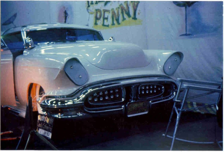

    Maqybe something involving a '56 Olds bumper would work.
    I believe the "Golden Penny" '54 Chevy used a 'Vette grille in the Olds bumper (before the Edsel shells), but I couldn't find a picture of it like that.

    Tom's golden penny.

    Digging the rear treatmeant i like how you used the rear quarters rather than try and fill it in around the tailights..the 56 bumper will look great on there with them...good lookin car man.

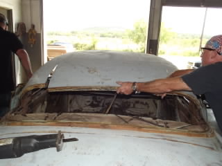

    Do you have any pics of the chop in progress? Would like to see how you cut and re-fit the rear glass area. Also, what are you using for a rear glass?

    i have pics ill post them. i was talking to gene winfield about molding plexi for the rear window . molding it off of the original back glass. i still have to move the rear window area forward to not have the weird double bubble seen with a lot of hard t. chops.

    Car looks great, nice job on the quarters. Glad to see some guys are still building real kustom cars, with actual body restyling. Too many cookie cutter cars out there these days. I'll be keeping an eye on this thread...

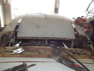

    here are some pics . the back how i slit it to line up the back.

    had some time today to flow out the insides of the quarters!
