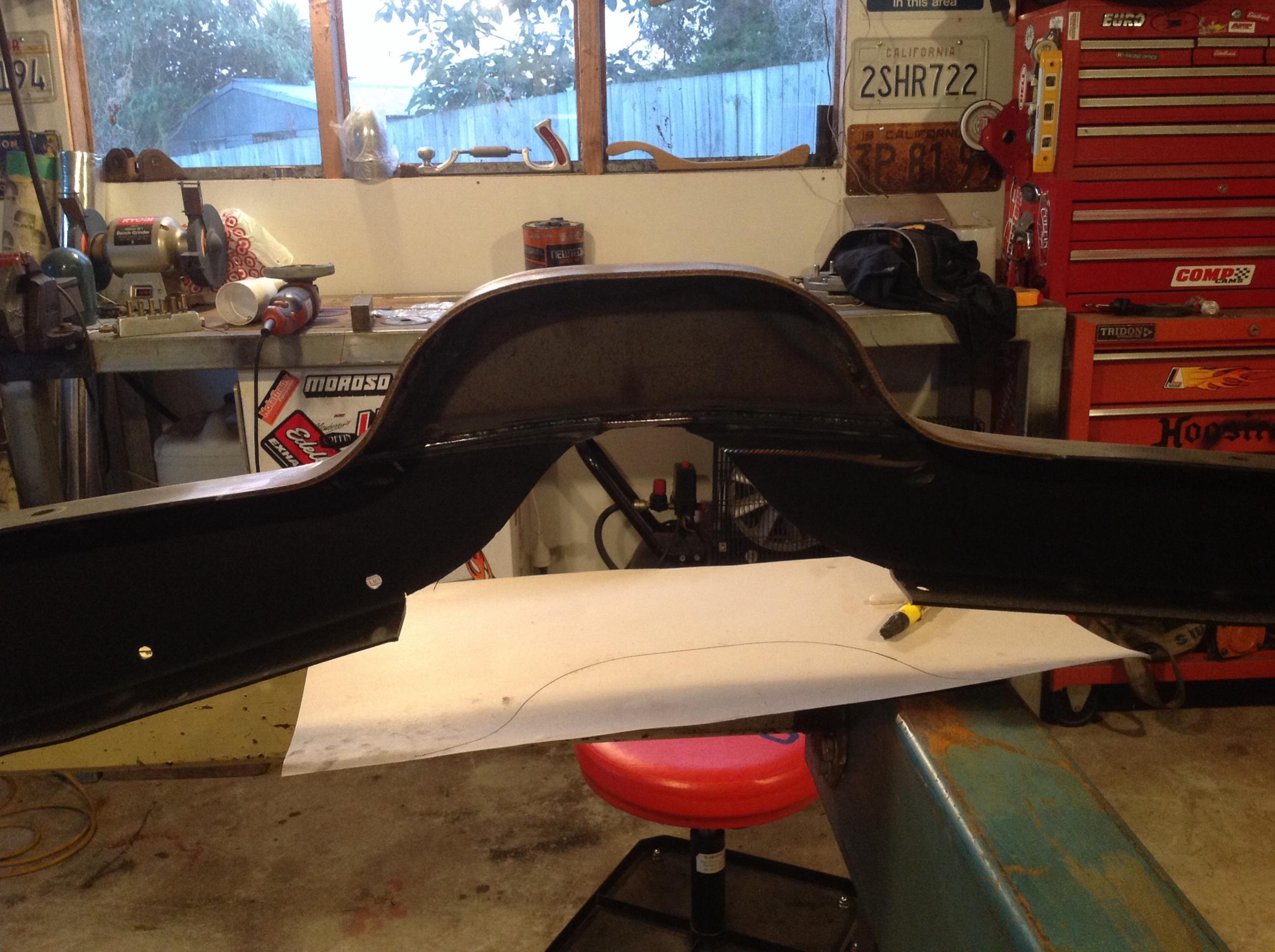

  1. Started on my f100 rear kick up last night for more diff clearance.
    Here is how it likes so far.i think it flows ok

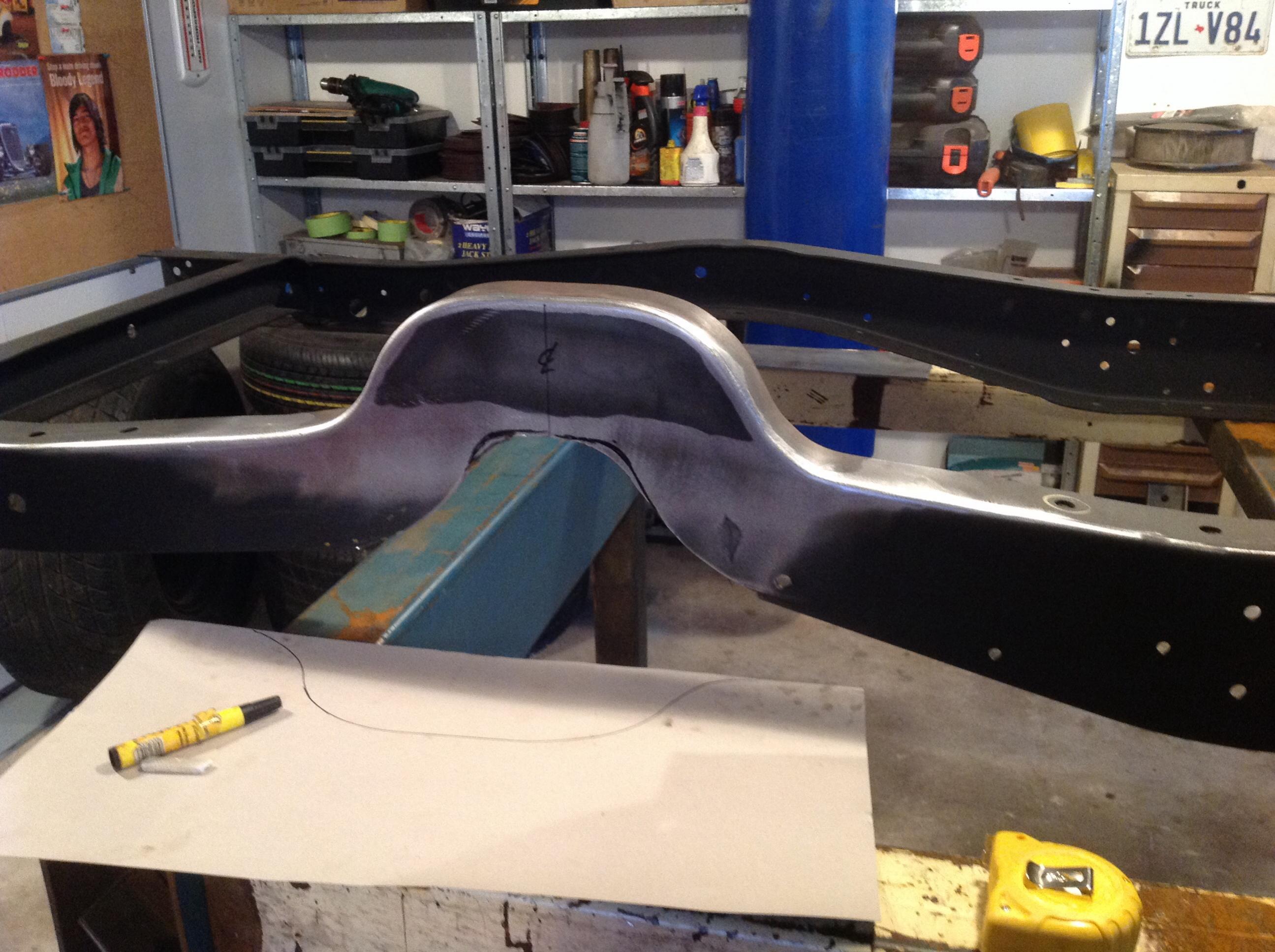

    Looks great. Do you have a photo of the inner side? I like to see the various reinforcement techniques that people use.
  4. Sure,I have tig welded a plate on top out side of chassis then fully welded the inside side,cut the shape of the kick up I still got to close the bottom.i then cut away the old top chassis lip as the chassis is getting fully boxed.the front end is art Morrison and rear end strange rear(I know it's not tradional)
  5. Here is the inside shoot
