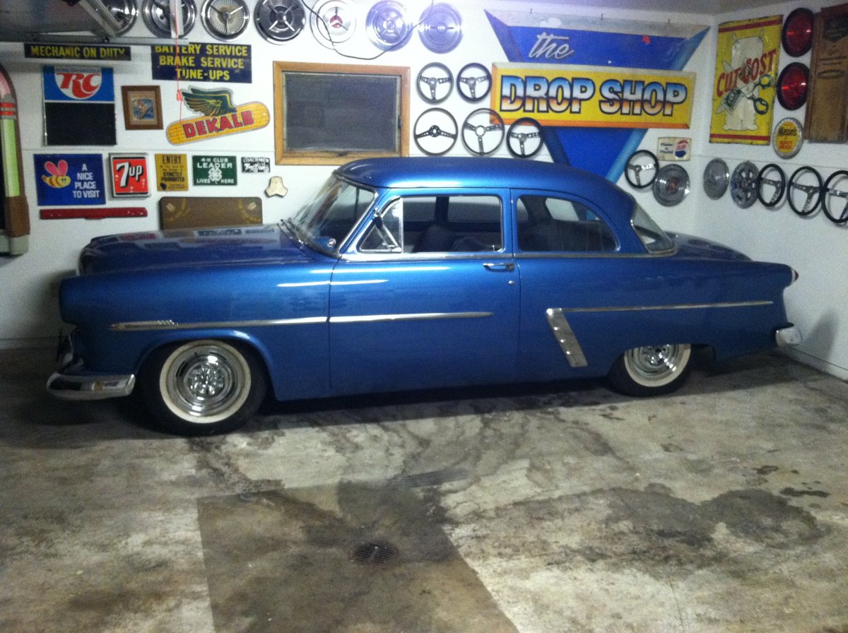

    Can any of you guys identify this car or the owner. The stance and wheel/tire combo is spot on. Sweet car image.jpeg

    In terms of wheels and tires on that blue car, looks just to be 6.70-15 rubber wrapping 15-inch chrome wheels.

    I was thinking the same thing for the tire size on the blue car but would like to verify, same with the suspension. Great looking setup al around. 3 on the tree behind the y block....... For now. T-5 swap is in the very near future, i found the adapter for $160 online which seems to be a wicked deal. T-5's are all over craigslist, not having an overdrive gets old lol

    I think part of what makes the light blue car above look so low is it's parked in tall grass, the grass is up to the rim in the rear.

    I agree about grass making the car look lower but i try to judge things off of bodylines in relation to the rims. In the rear its tucking almost to the hub center at the wheel well opening. Its an inch or two lower than most cars ive seen
