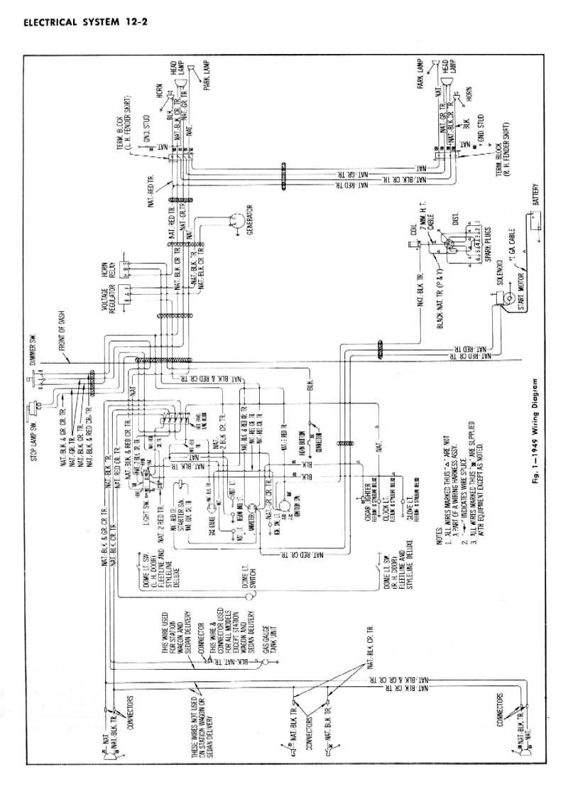

    Get a ClassicWiring.Com 11x17 laminated schematic of your car. The wiring is in the color of the original wires with every option. About $20 you will never be sorry.

    Notice there aren't any turn signals on that 1949 wiring diagram..there aren't any on the 1954 diagram, either....
    Turn signals were were optional or accessory equipment.
