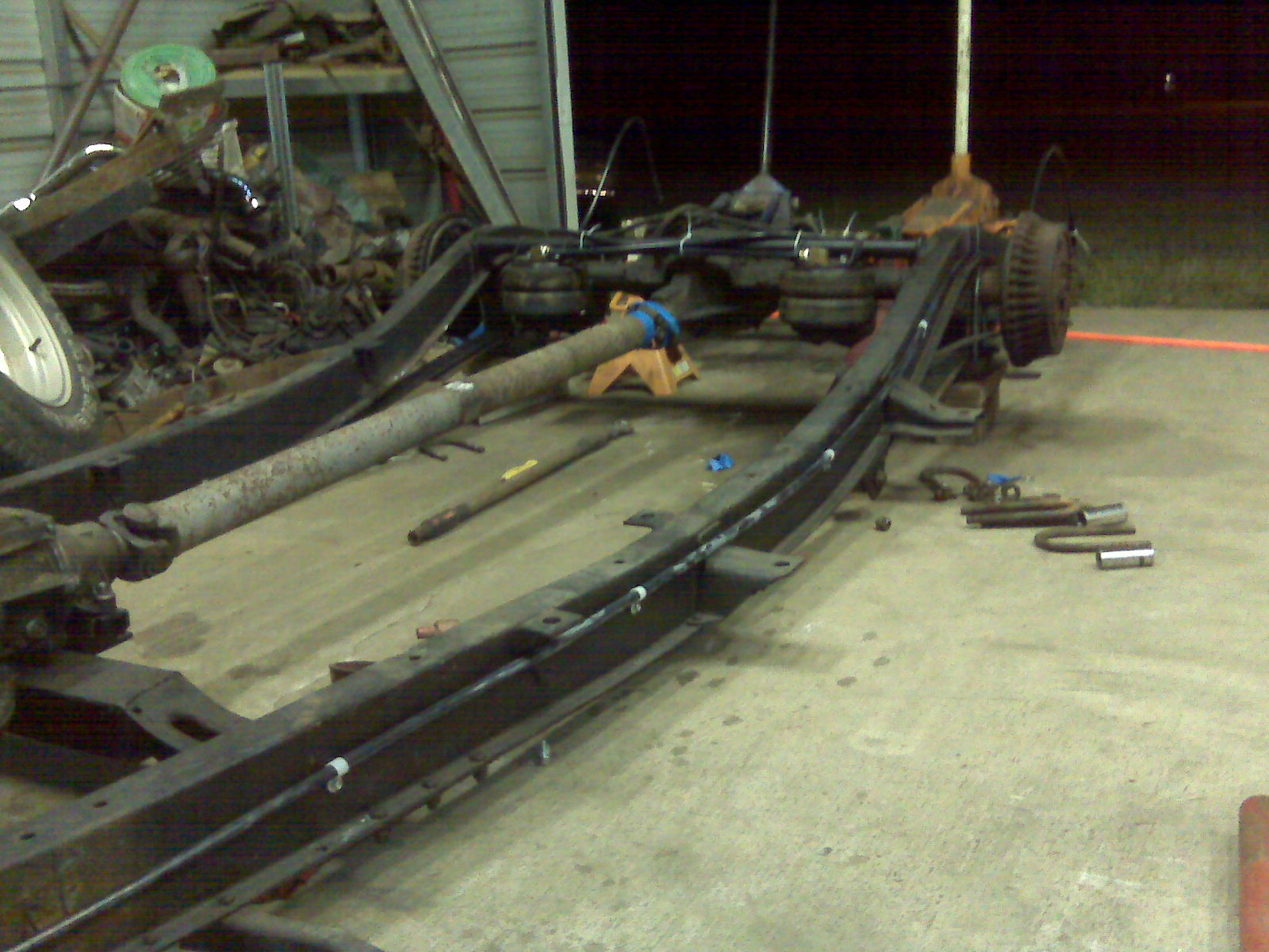

    Hey fellas,
    While im waiting on my mustang II to arrive, I have began stripping and cleaning up my frame for all the work to come. My question is, where is the best place to take a level measurement front to rear? From the flattest point on the front of my frame (about 6 inches rear of the rad mount), my level from front to rear is off about an 1/8th with the rear being too high, but if I take level from the rocker, the car is dead level. Any yes, the floor is dead level. 54 chebbie guys chime in here!
    Thanks!
    Jaison

    I think there are only 2 mounts that are "level" to one another the mount center of the frame on the outside looks like a "n" and the one just infront on the rear tire.
    I checked each mount by itself with a 4ft level. It wont be lazer perfect but close. I think square is more important when setting up a M2 front end.
    MrC.
