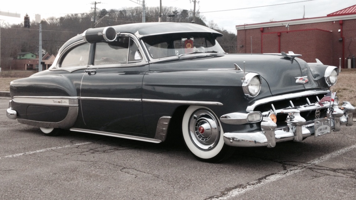

    On my 54 Buick I cut a coil and I used part number 5759 for sensatrac. They were perfect and cheap at the parts store.

    Inked - Nice ride! Did you use drop spindles? Was one coil enough? How and how much did you drop the rear?

    Just one coil in the front, no dropped spindles. I was running 3in drop springs from Jamco in the back but it's 4-linked and bagged now. Rides awesome.
