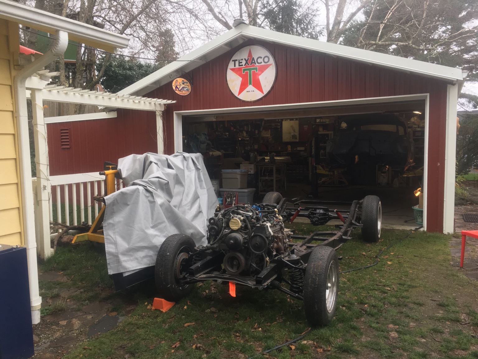

    Starting a new thread for my project 54 Chevy.
    Dad bought it a month before I was born. I grew up in it and learned to drive out in a field when I was 8yo.
    Have a number of other classics. But this one is family!
    [​IMG][​IMG]

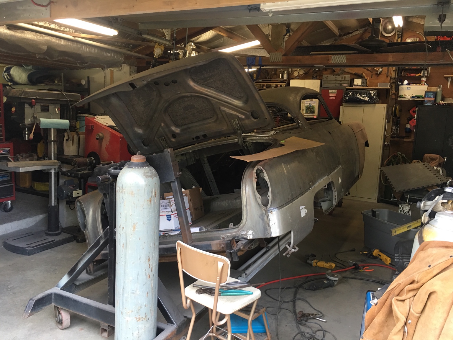

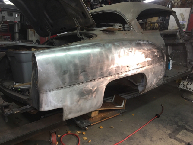

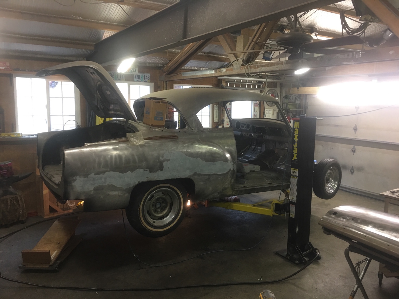

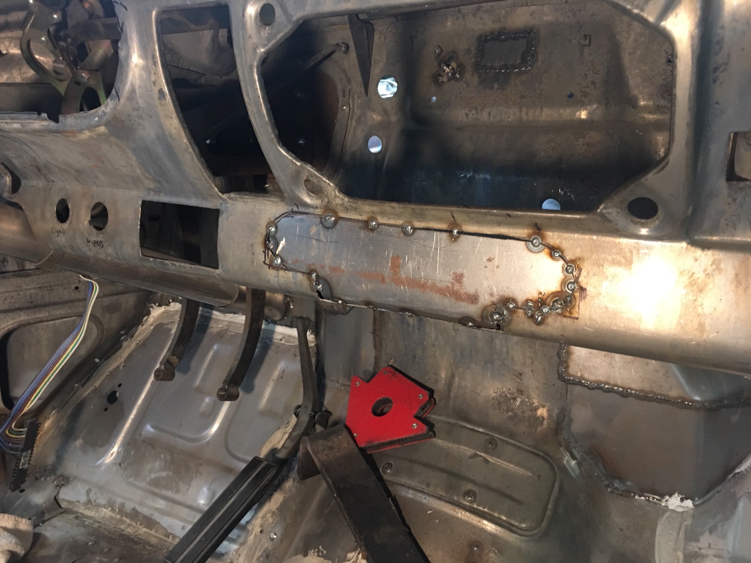

    Did some more metal work today and got it off the rotisserie.
    Going to finish the firewall, prime and paint the undercarriage with bedliner this weekend. Should have it on the chassis next week.

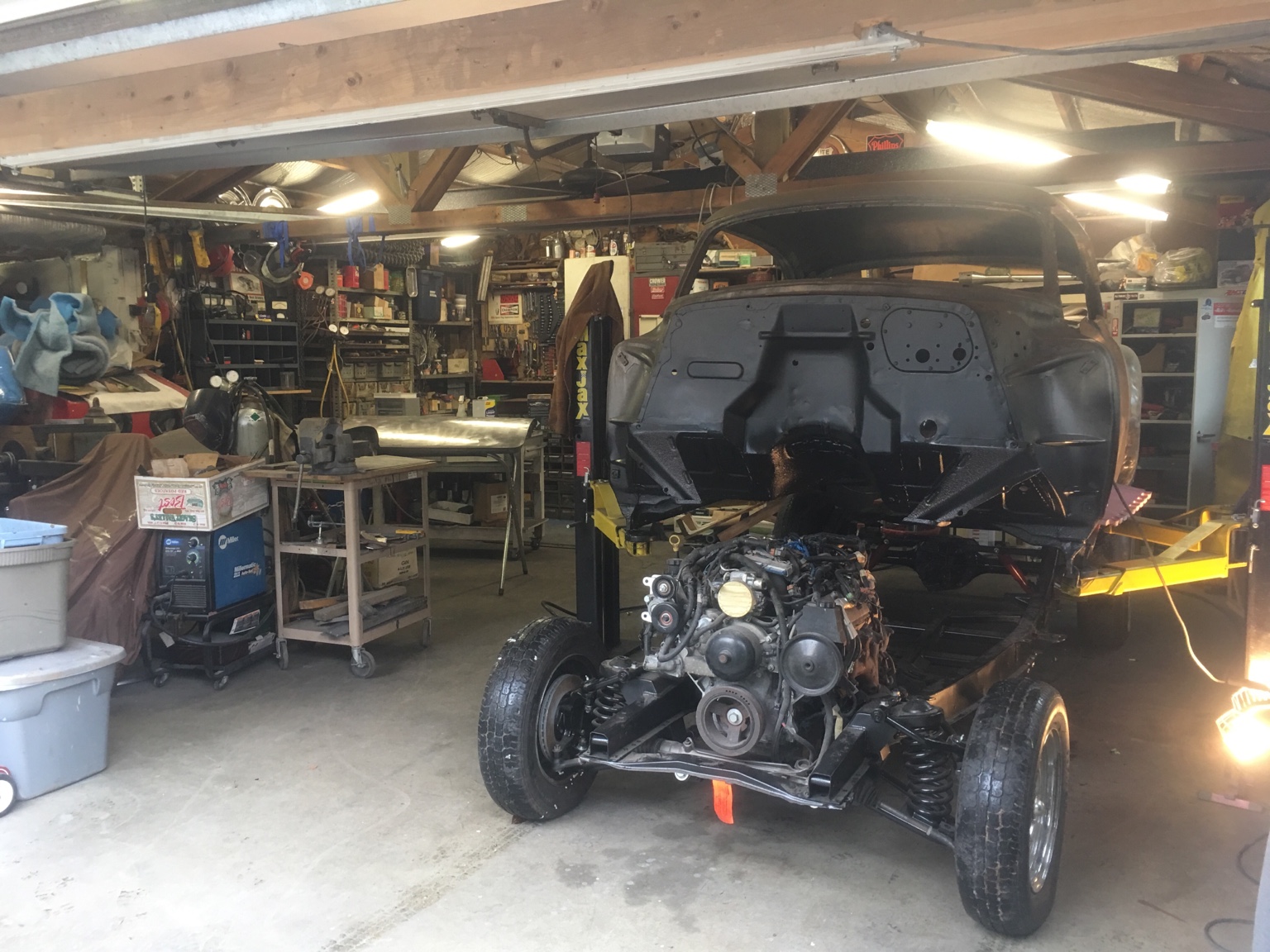

    [​IMG][​IMG][​IMG][​IMG][​IMG][​IMG]

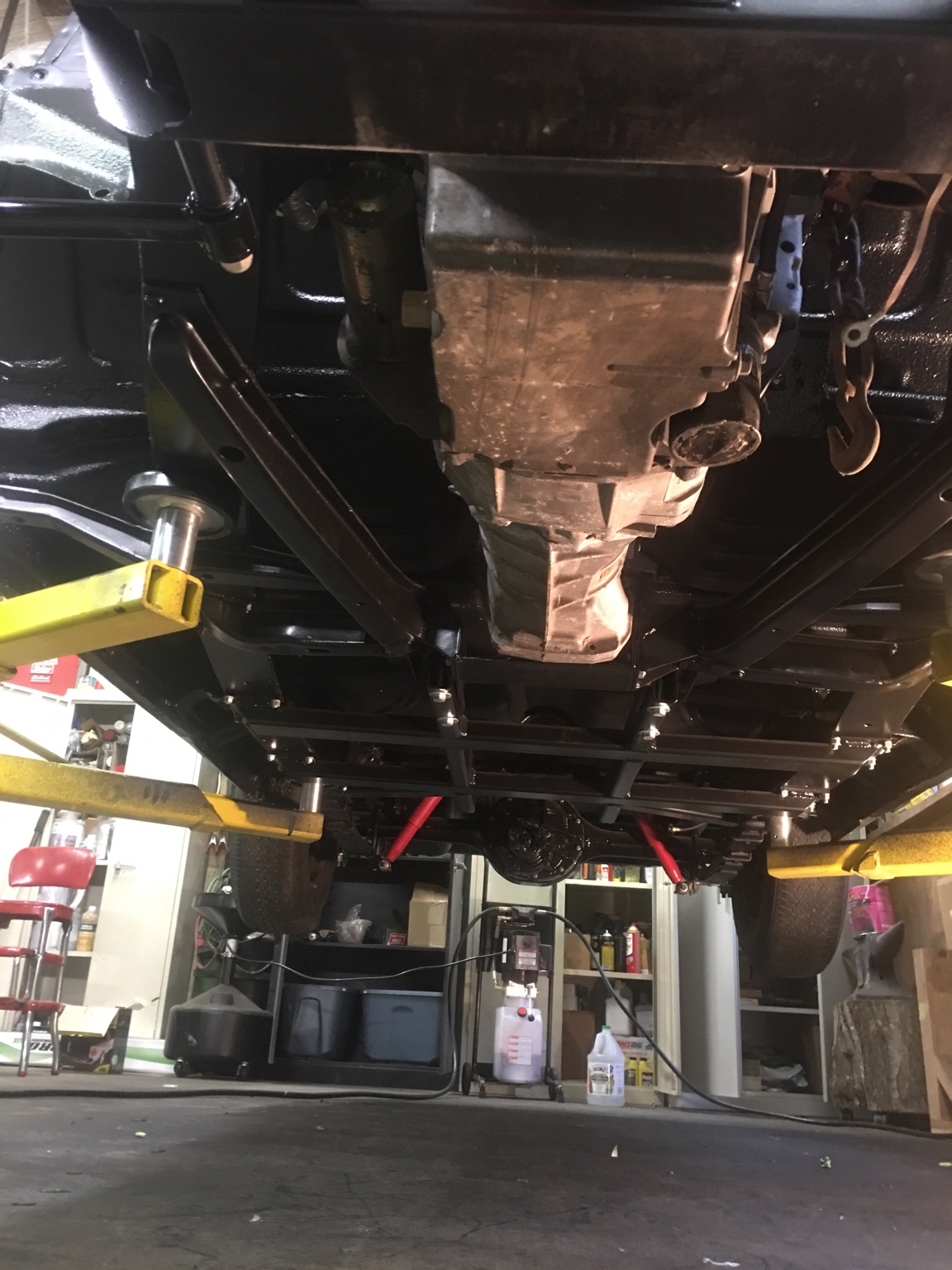

    Past few days I sprayed Por 15 and truck bed liner over the under body. Bolting it to the chassis now.
    Please disregard my choice of engine and transmission. I know it is not H.A.M.B. friendly.

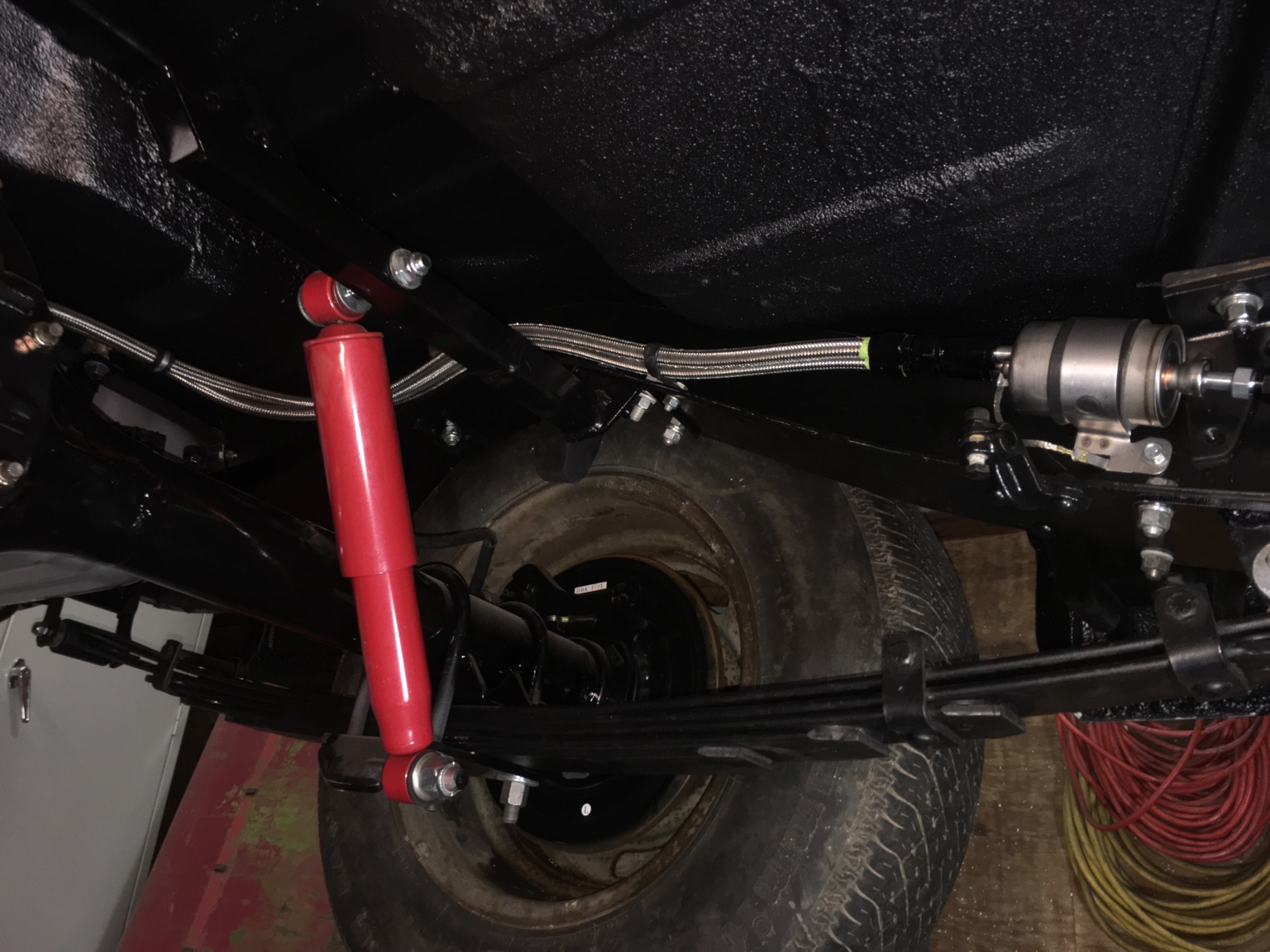

    Boring but still progress.
    Got the fuel tank and plumbing in.
    Still working on plumbing the brakes and clutch though.

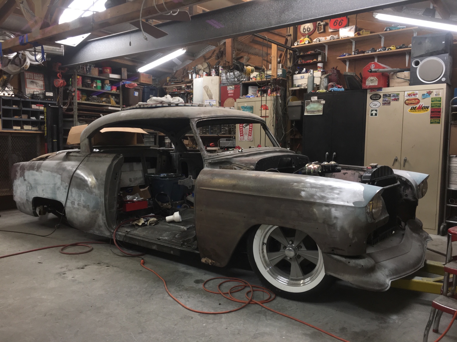

    Been awhile since I have done some progress updates on the 54. It was sitting again while I finished other projects over the past year. Got back cracking on it a couple months ago.
    Other than non H.A.M.B. friendly progress. I relieved the driver side splash pan for tire clearance, installed 55 Chevy headlight trim, and recessed dash vents.
    Have a number of irons in the fire yet. But making progress none the less.[​IMG][​IMG][​IMG][​IMG][​IMG][​IMG]
