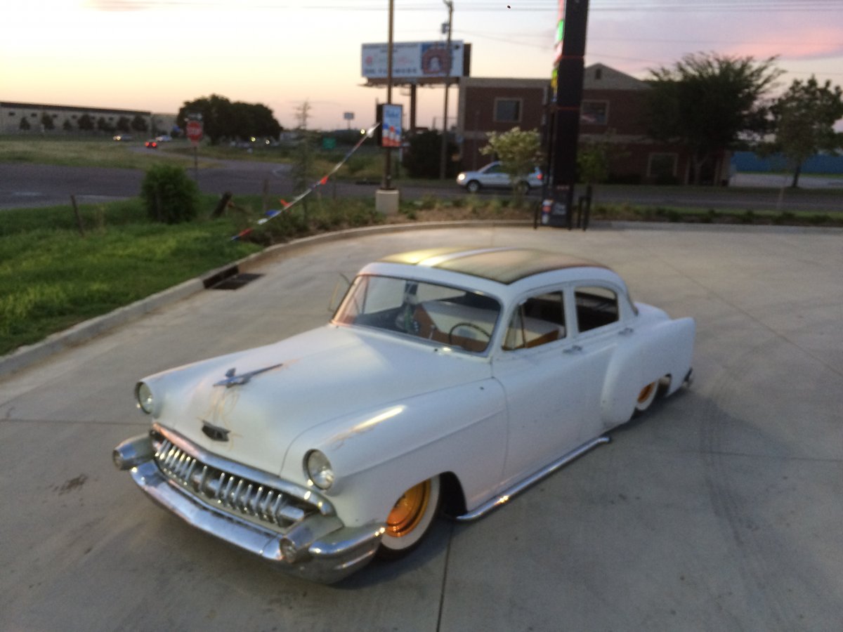

  15. Jbuhl1954
    Joined: May 19, 2013
    Posts: 129
    Jbuhl1954
    Here is how Merlene sits now.. have gotten a lot done to her since the last post!! I have been driving her like crazy!!
    chryslerfan55 and Slow down like this.
