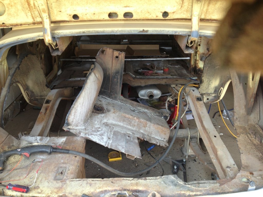

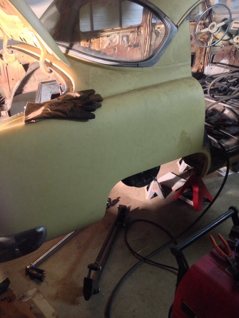

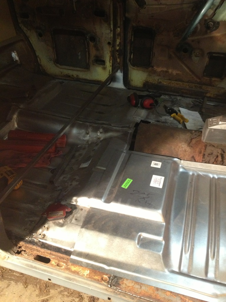

    Got the floors basically done ol Merlene!!!

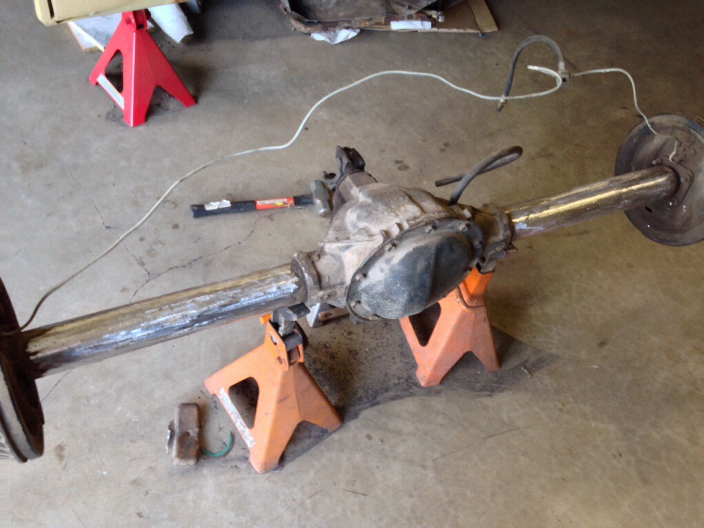

    Then I decided I should put the suspension on air!!!
    Cut all out!!
    ImageUploadedByH.A.M.B.1379809694.838237.jpg ImageUploadedByH.A.M.B.1379809711.709330.jpg ImageUploadedByH.A.M.B.1379809724.536265.jpg ImageUploadedByH.A.M.B.1379809745.685142.jpg

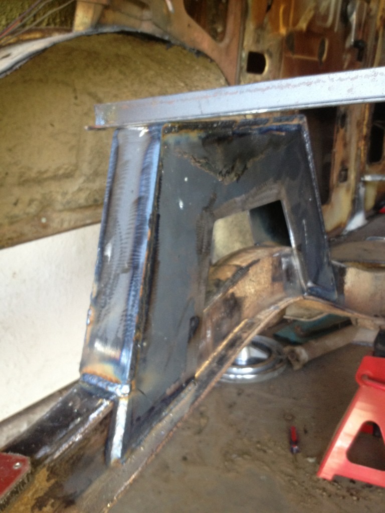

    Not bad haven't put down any beads in about 6 years!!!
    ImageUploadedByH.A.M.B.1379809808.328244.jpg ImageUploadedByH.A.M.B.1379809816.727980.jpg

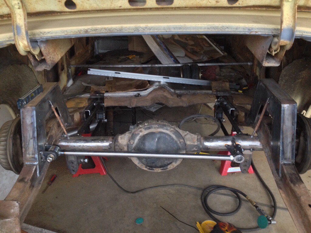

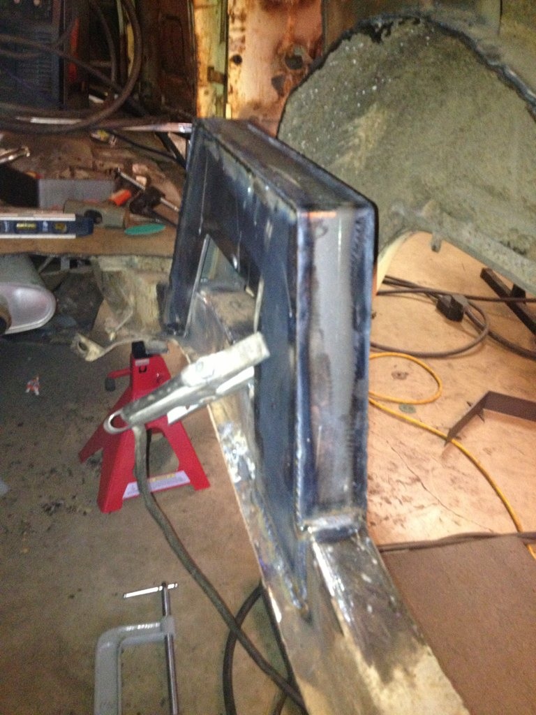

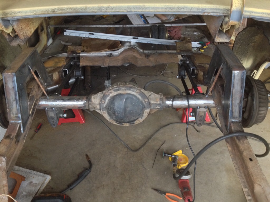

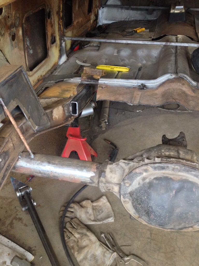

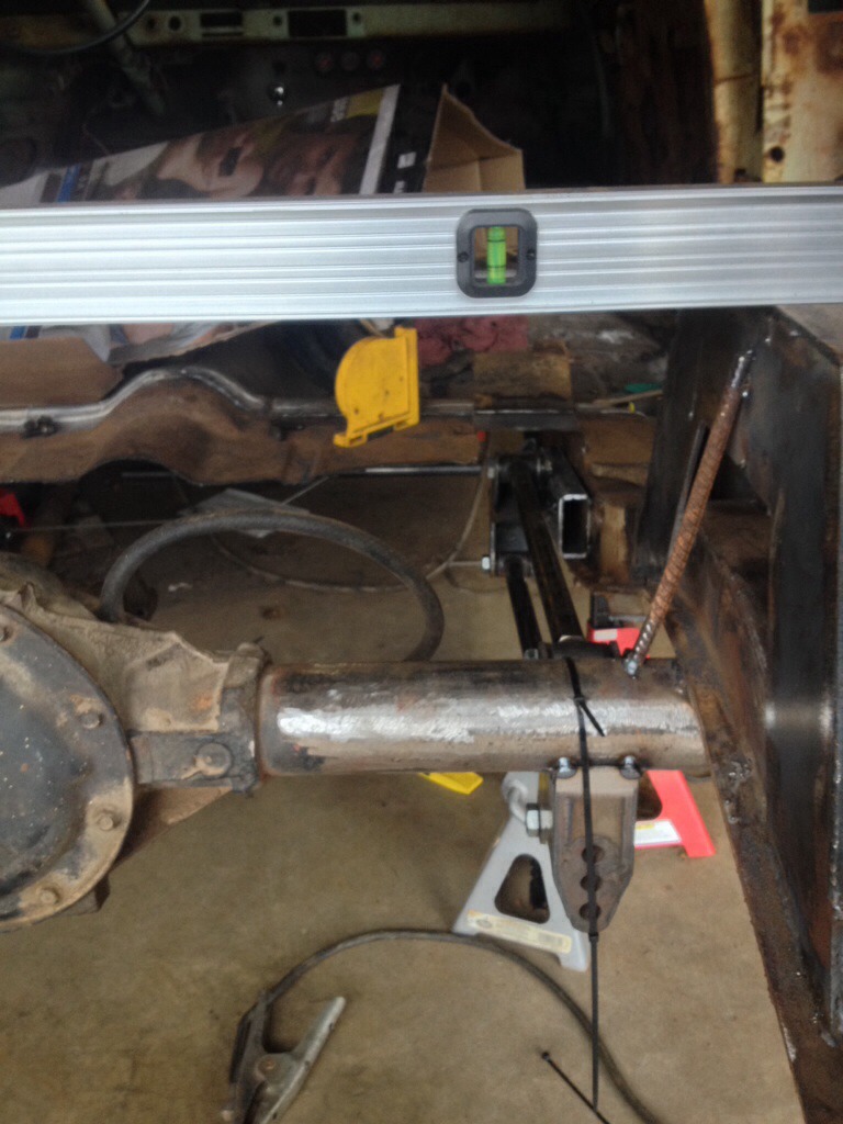

    Got the parallel 4 link and panhard rod tacked into place!!! ImageUploadedByH.A.M.B.1381850260.331019.jpg
    Took 2x3x3/16 square tubing and tack to frame to space 4link out!! And yes it will all be gusseted!! ImageUploadedByH.A.M.B.1381850358.232081.jpg
    Other side!!
    Passenger side in place!!
    Both links on!!
    And panhard rod on!!! Bag set up coming next can't wait!!!

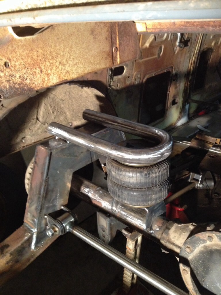

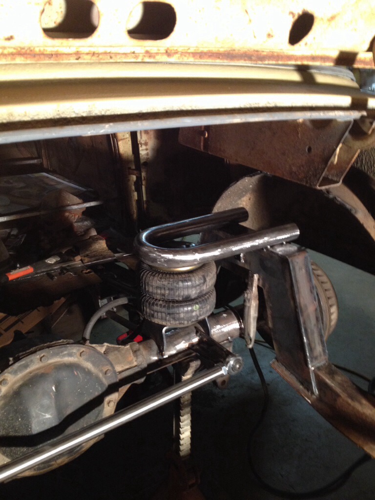

    Here is what I got done tonight!! Lower and upper bag mounts tacked in place!! ImageUploadedByH.A.M.B.1382061461.358391.jpg ImageUploadedByH.A.M.B.1382061473.882531.jpg ImageUploadedByH.A.M.B.1382061504.624225.jpg
    Tomorrow I'll tack up the upper cross bar and shock mounts!! Pics to come!!

  17. Just curious, why are the bags positioned so far inboard? Like springs, wouldn't they be best positioned close as possible to the frame rails? Only asking as I have yet to do this on my 53 Buick...have never bagged any vehicle before.
  18. Jbuhl1954
    Joined: May 19, 2013
    Posts: 129
    Jbuhl1954

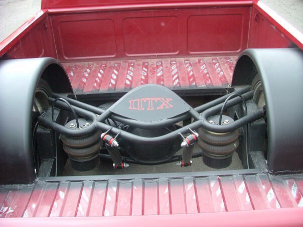

    Dragdoc I put them a little closer in then I do most!! If you look closely the edge of bag is on the edge of the parallel link bars. The panhard bar will keep the car from side to side play!! I will be running independent bag setup so should not have any sway issues either!! ImageUploadedByH.A.M.B.1382100045.010156.jpg
    I also slipped these bags in a little closer and actually behind the axle and this s10 drove like a champ!! So I figured it would work for my application!! Thank you for the close eyeball!! I second opinion is always nice!!

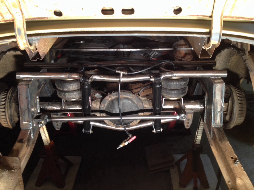

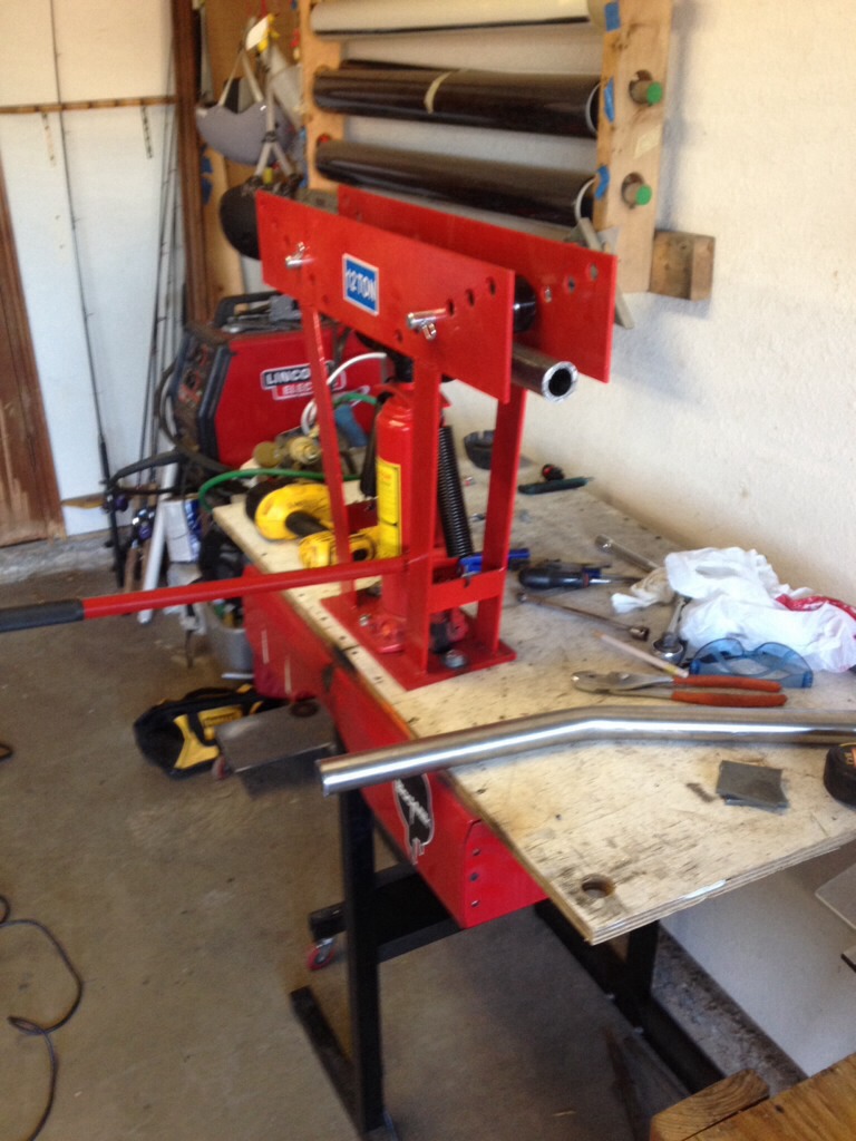

    Alright back in the garage!!! My boss gave me some grid wall so I put it up the other day!! Great addition to the garage!! ImageUploadedByH.A.M.B.1382576775.037543.jpg
    But on to the good stuff!!
    Bending up some crossbar and shock mount pieces!!

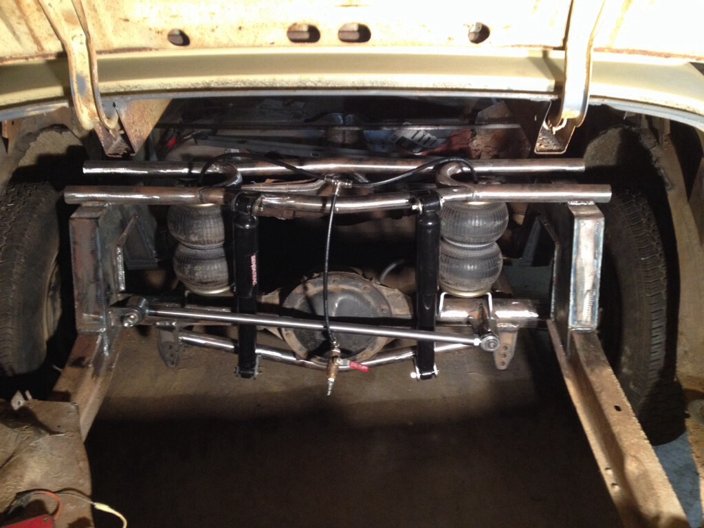

    Crossbar tacked up!!
    Frontside!!
    Put the bags in it!! Bottom bar is tacked to the parallel link mounts, ill use it for my lower shock mounts!!! I'll try to get the shocks done up and finish weld everything before Monday!! I'll take more pics along the way!!!!

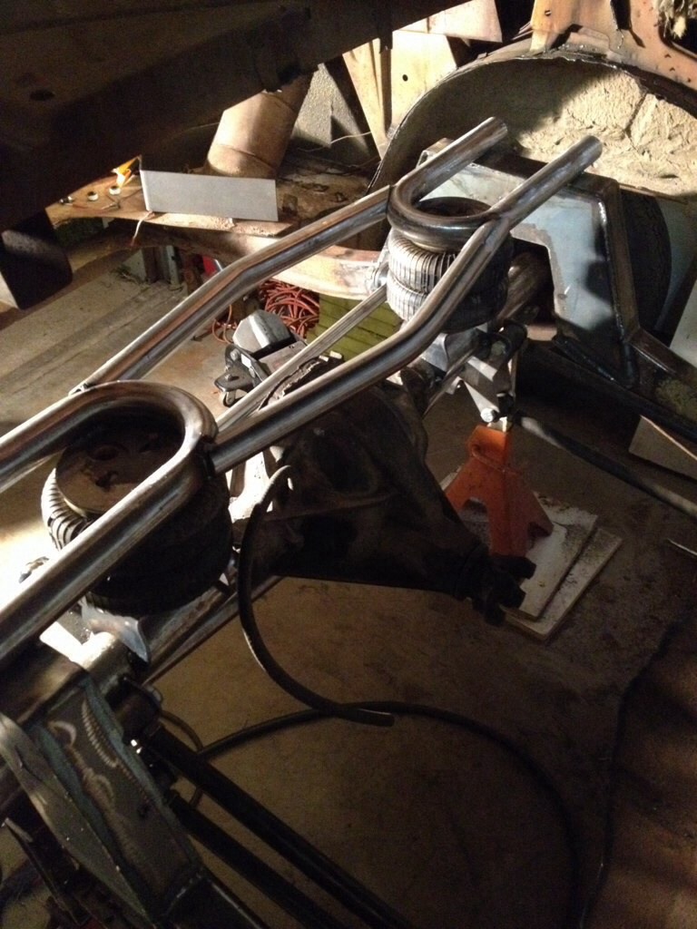

    Got the shocks tacked up and ready!! ImageUploadedByH.A.M.B.1383323029.896406.jpg
    Tested all the travel lengths and then put her on the ground!!
    Here is the pic I like the most!! The comparison pic!!! ImageUploadedByH.A.M.B.1383323227.151168.jpg
    When I pulled her in the garage and how she sits now!!! MII front end coming next!!!

    you choose to weld the bag mounts just on top of the notch instead of a more professional approach? i.e loose un-terminated ends of bars? Ive been building mini trucks since before bags were "the thing" and if you really want to knock it out of the park clean up those ends and throw some gussets on it. I'm not saying bad job just offering advice Most dont even make it this far, thats when i buy them by the box.
  27. Jbuhl1954
    Posts: 129
    Jbuhl1954
    I don't know man looks pretty profesh to me!! I appreciate your comments and advice???? But the car isn't done yet there is lots to do still!!! So check back and hopefully I can build "MY" car to your liking!!!
