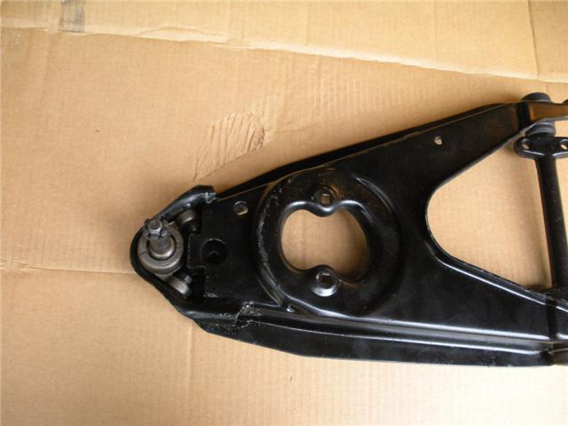

    Another Hamber sent me these pics of what he did. He grafted the lower control arm ends from a 59-64? full size Chevy to use those spindles and used some tubular upper arms from Speedway and made a mount for the upper. I'll probably do something similar on my 55.
