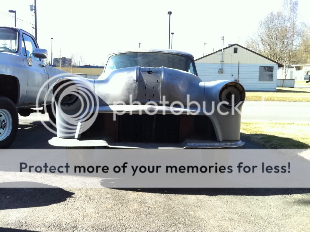

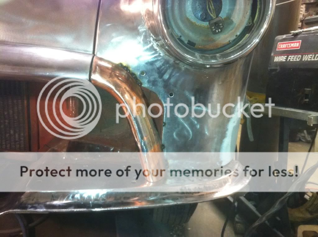

    Well,its been quite some time since I did any updates to my build.Was having issues getting pics to upload for some reason but finally have it figured out. I decided to go with 55 Olds headlights, I really just disliked the factory lights.
    I started with just the rings, I made a skeleton from 3/16 round stock than wrapped it with 20 gauge sheet metal.
    http://i695.photobucket.com/albums/vv317/volksjunky/1953%
    20Pontiac%20custom/IMG_0354.jpg
    I also decided to do something a little differand with the grill surround, I used the existing top arch from the orinal grill and extended it about three inches using pieces i cut out of the old grill. I changed the angle and overall shape of the opening quite a bit. I just think it flows a lot nicer...
    I capped the ends off just to give everything a nice finished look.
    I also ended up replacing the passenger side rocker,it had a hell of a crease in it and I didndnt want to put a lot of filler in it. Glad I cut it out because it was a fricken mess !
    I also hade to patch the bottom of the drivers door,I ultimately will end up doing inners and outer on both doors this winter.
    I got the bottom part of the car sealed in DP and pulled it outside to get a good look at things. still lots of little things to iron out but all the big body work is coming along.

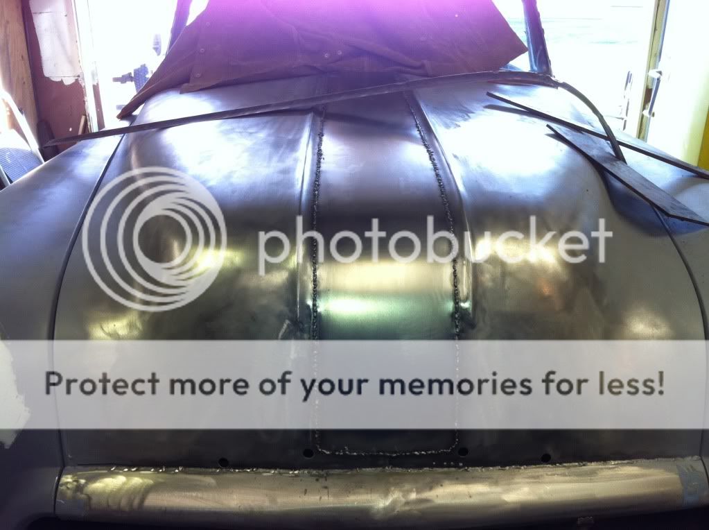

    Right now Im concentrating on getting the hood done,I cut out the overlap and welded the hood solid..
    I than made a filler piece to get rid of the stainless trim, sorry die hard Pontiac folks, but the shits kinda ugly and I want a custom not a resto !
    And thats where im at for now. Today I will be doing all the grinding and filling the holes from the original emblem.
    Oh, I also shortened the hood ribs by six inches, I will be rolling beads in some 20 gauge and carrying them on to the trunk later on.

    Cool thanks for the replies guys ! Got the hood pretty well done and the first skim of mud on it,need to turn it around and do the trunk next.
