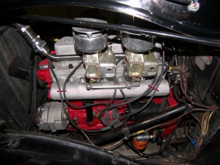

  9. I agree 100%. No need to do a V8 swap. The 230 in my '48 Plymouth has an EDGY head and cam, Offy two carb intake, split exhaust, lightened flywheel and an overdrive. It will run down the highway at 70 mph all day long with no issues and return respectable mileage in the 18+ MPG range.
  10. PS~ If you want to get really trick, have Earl (EDGY) cast up another one of his F heads. We have one in our '35 Dodge Bonneville push truck and it's one hell of a motor!
