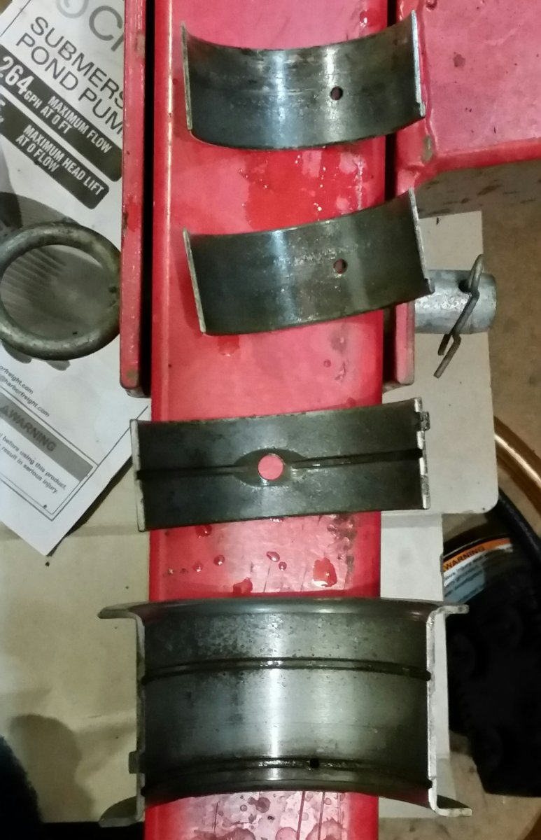

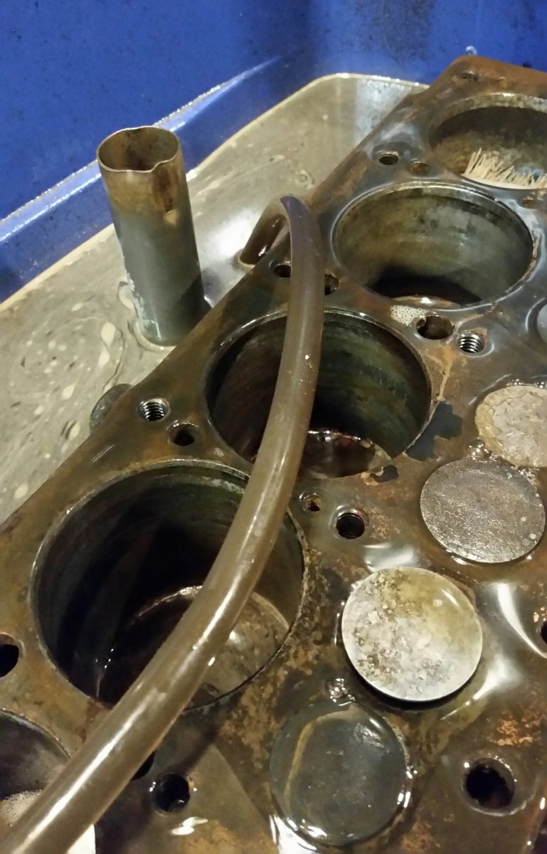

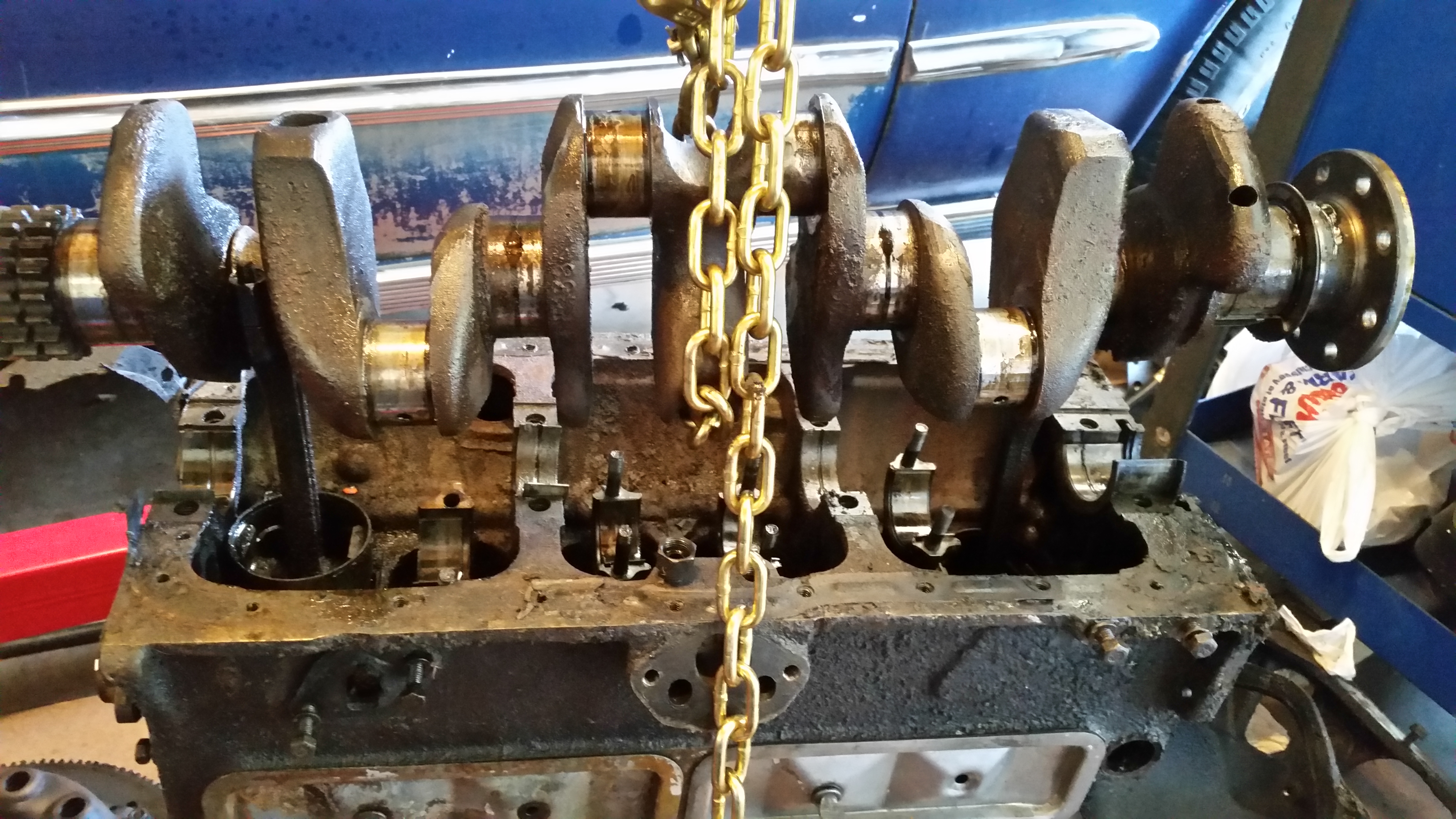

    Teardown pictures
    AndersF likes this.
