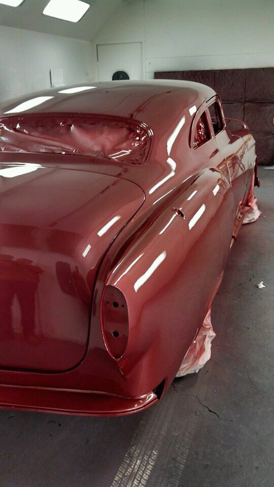

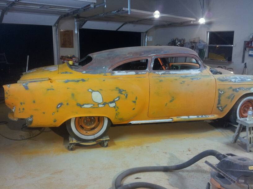

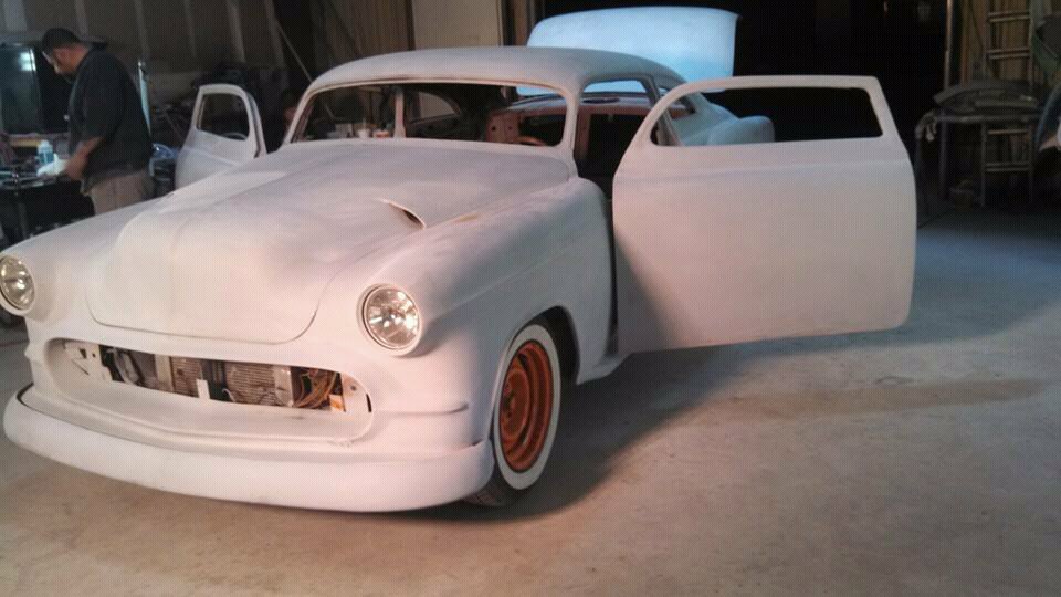

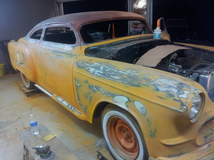

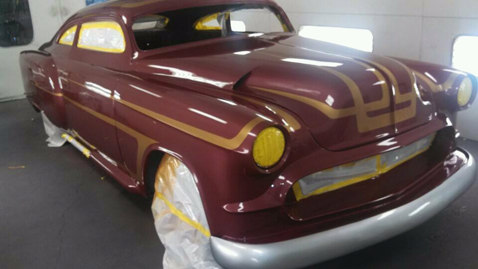

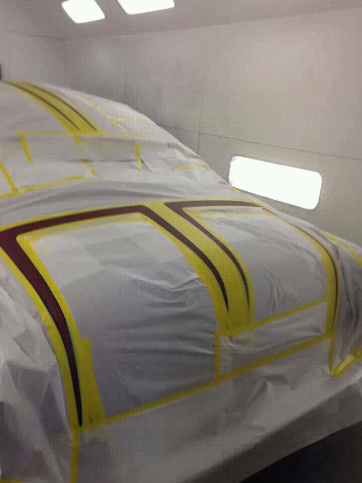

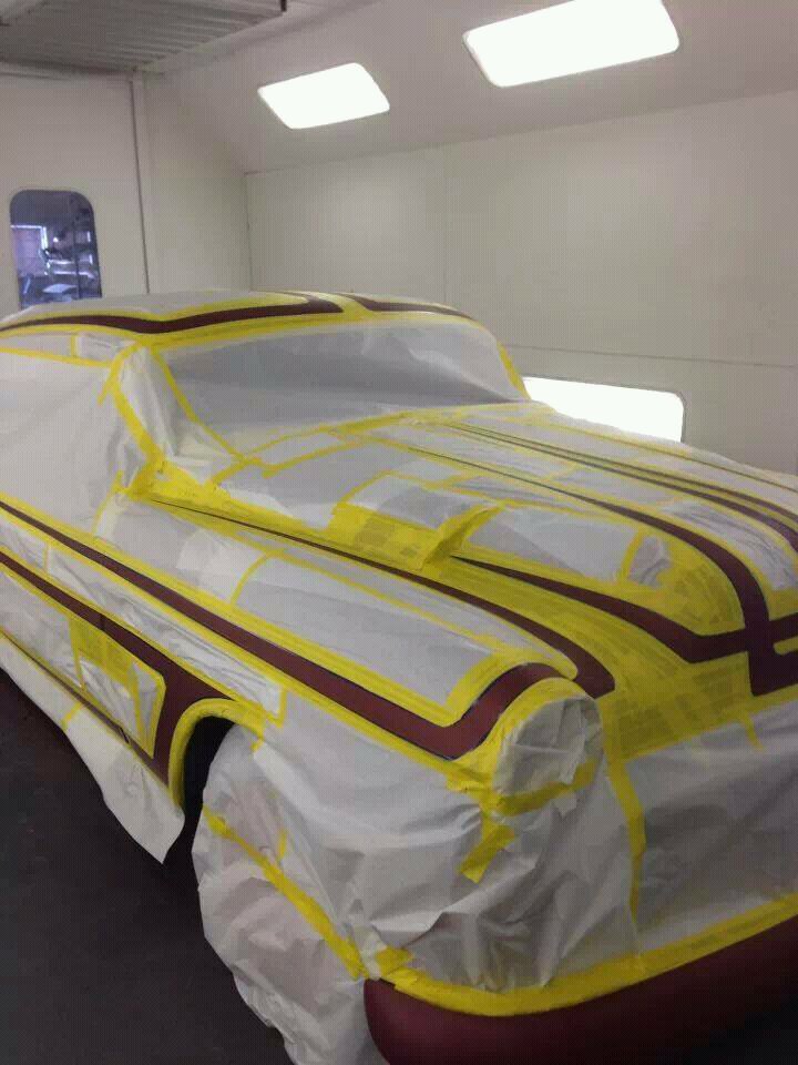

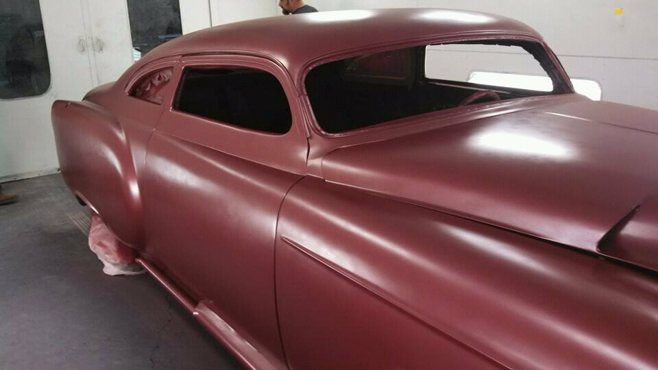

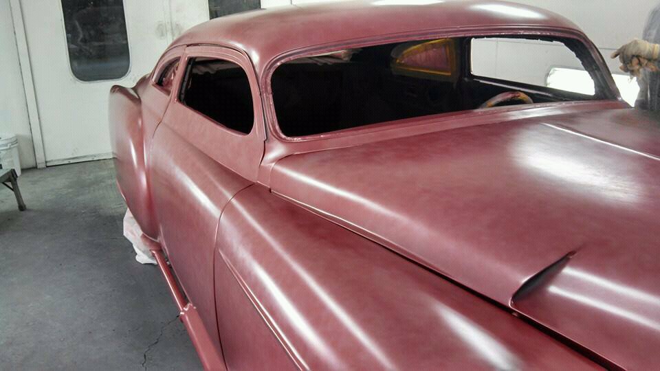

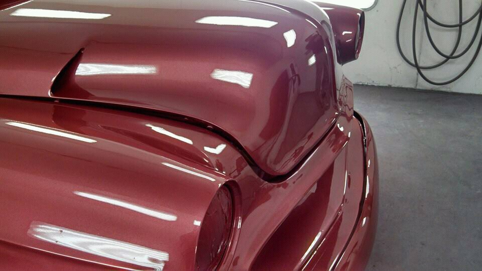

    So its been a while sence I have posted on here. We have been driving the hell out of the 53, but it is showing some wear and tear and I was never happy with the out come. So we have taken it down and are giving it a face lift for this years Lone Start Roundup and here are a fiew pictures of what it is going to look like. We started this about four weeks ago.
