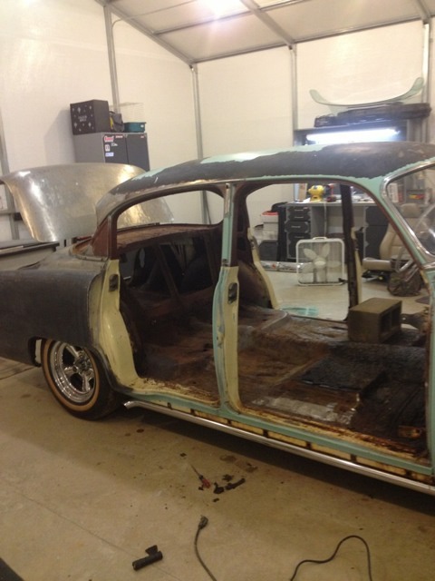

    A lot more stripping, wire-wheeling, taking stuff off, sorting screws, wire-wheeling, cataloging my parts, and did I mention wire-wheeling? I still have lots to go, and I dream about it at night. I don't have pics of it all, but 2-doors down, trunk lid done, rear fenders and back glass opening, etc. ImageUploadedByH.A.M.B.1386301533.902356.jpg ImageUploadedByH.A.M.B.1386301546.638199.jpg
    Some rust on the rear fender bottoms, trunk extension, but overall, the car ain't too bad. ImageUploadedByH.A.M.B.1386301677.763723.jpg

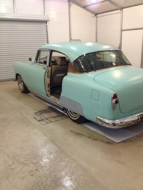

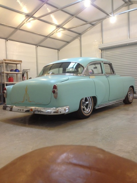

    Ok. Last update for now and we should be up-to-date.
    Picked up some original seats from a fellow in Mobile, AL. My good ole Dad drove down (4 hours), visited some family, and picked them up for me. Definitely only the frame is salvageable, but I got the front and back for a fraction of what I've seen elsewhere. Pumped about that! Not to mention...perfect fit! Can't wait till its time to get them covered. We've already got our guy lined up. ImageUploadedByH.A.M.B.1386301958.767116.jpg ImageUploadedByH.A.M.B.1386301975.028712.jpg
    One last thing...this car is a joy to have! It's even got my 10-year old off his iPod and video games and in the shop getting his hands dirty! Already worth the money! ImageUploadedByH.A.M.B.1386302062.114819.jpg

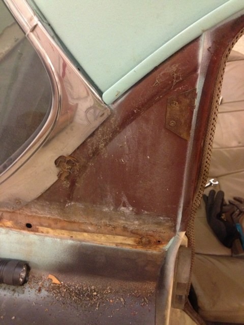

    I found some patches from a generation before me. I'm not sure if the car was in a wreck or not. There's plenty of lead here and there, but not enough to indicate a major crash. Either way, its interesting to find these repairs from yesterday.

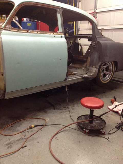

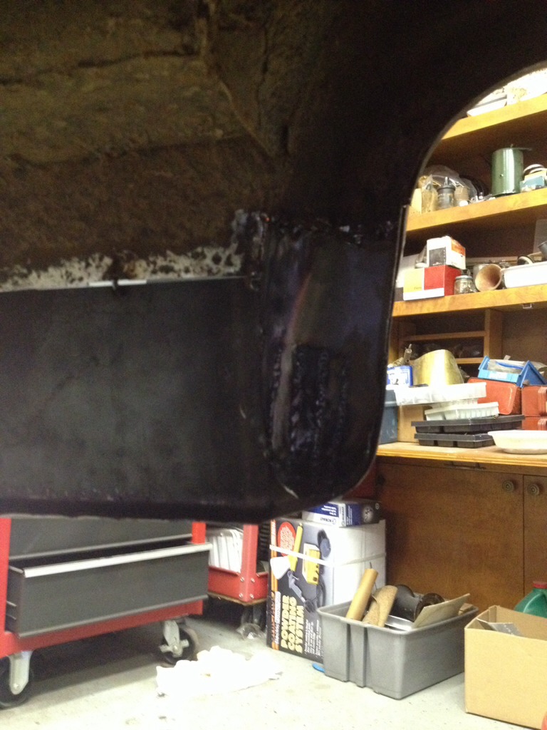

    Front half of the Outer rocker coming off...and looks like the inner rocker is next. Obviously, I will replace the inner rocker before installing the outer, but here's a dry-run of my new outer rocker. Not too bad. I think it will work out OK. ImageUploadedByH.A.M.B.1386595982.383642.jpg
    Next is to keep removing the rocker toward the rear door. It doesn't replace everything back there so I'll need to finesse it. There is damage below the rear door, so that's going to be an issue.
    Any suggestions about how to fit the new rocker in this area?
    As you can see, the new rocker doesn't quite replace everything, and I have a few holes at the base of the post. Unless there's great advice out there, my plan is to blast it all out real clean, plug weld the holes and roll with it.

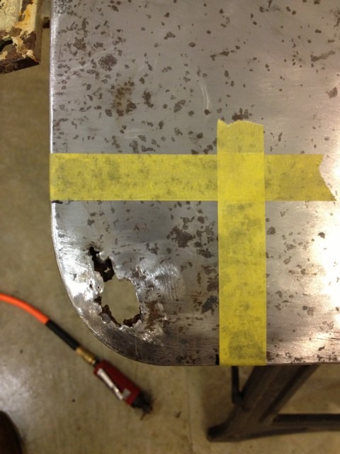

    As you can see, I had some problem areas with my drivers side dog leg. The curve at the bottom where my outer rocker replacement joins was rotted through. There was also plenty of lead in it that was cracking. I put the cutting wheel up to it about 15 times before I could bring myself to actually dig in. Now that its out, I feel better about getting all that repaired. Picked up some FREE steel from a local sheet metal shop and started making some templates out of aluminum foil I folded over multiple times. Feel free to laugh at me, but it worked! It's coming together at Dad's and looks pretty good so far.

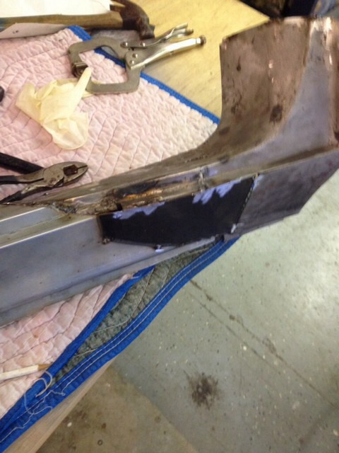

    Thanks all, for the encouragement. I'm probably not totally "HAMB-friendly" as I'm not really planning anything custom...just a restoration. Nevertheless, I appreciate all the encouraging words.
    Worked on some homemade inner rocker panels today after church. I need to sandblast my braces before tacking and fitting them. I'll post some pic tomorrow maybe.

    Installed the front half of my homemade inner rockers. The back half will take a little tweaking, but they're next.
    They aren't "factory", but they're installed and strong!

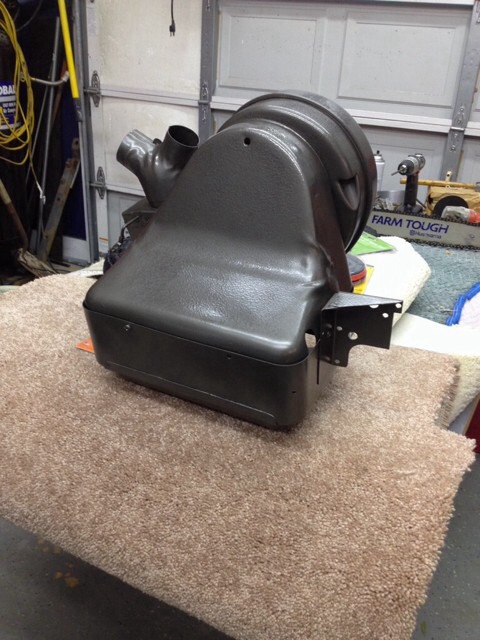

    I pulled my heater motor out and controls and started removing chrome pieces from the dash. I didn't get a "before" picture of the motor and housing, but here are the "after" pics. View attachment 2115649

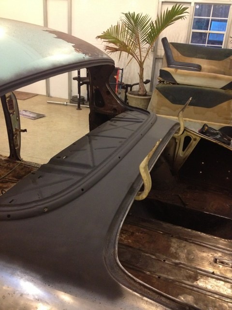

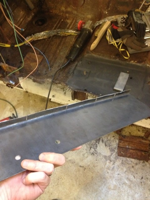

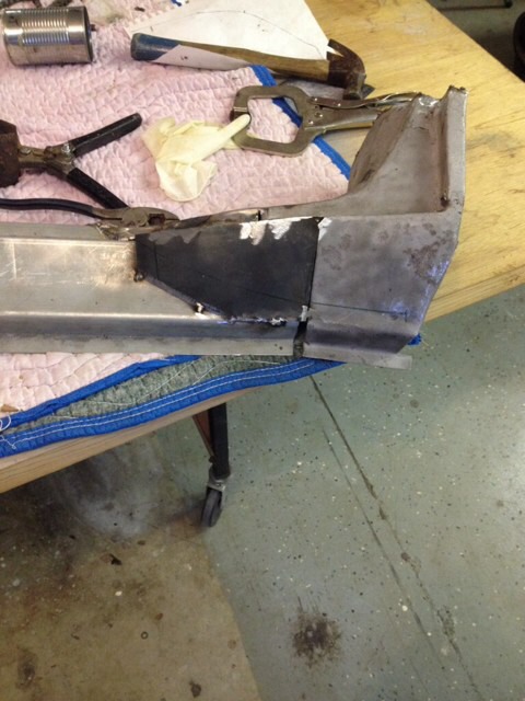

    I started work on fitting my after market outer rockers to my part-stock, part -homade dogleg. They were not the same, to say the least. ImageUploadedByH.A.M.B.1389754126.850459.jpg
    Nevertheless, perseverance and the willingness to repeatedly cut tack welds loose over and over, it's getting closer.
    It's still got a ways to go, but I'm pleased with the progress. For what it's worth, this car is the first I've ever welded or done any metal work. I'm certain that fact is obvious to many of you veterans, but I'm thoroughly enjoying learning and spending time with my Dad. ImageUploadedByH.A.M.B.1389754466.790077.jpg

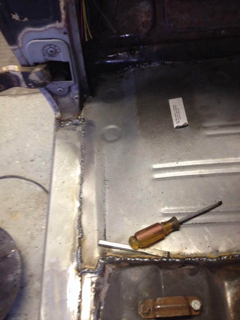

    Floor pans coming out!
    And here's my Pops putting the new pan back in. It took a bit of massaging, but turned out well in the end and seems very strong. I've still got to cut out the access to my master cylinder. I want to leave it where it is below the floor.
    One side done!

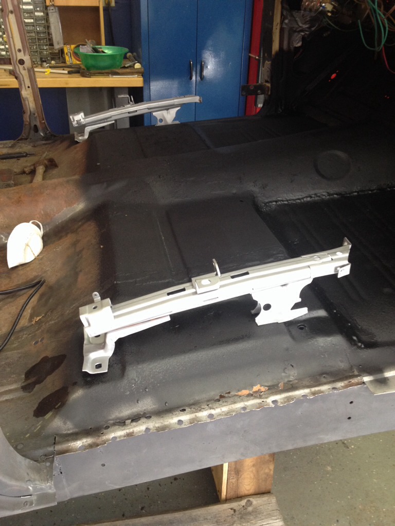

    This picture shows both floor pans in with spray on bedliner down on the floor. I've also fully restored my front bench hardware that allows the seat to slide back and front. They turned out really nice and slide smoothly.

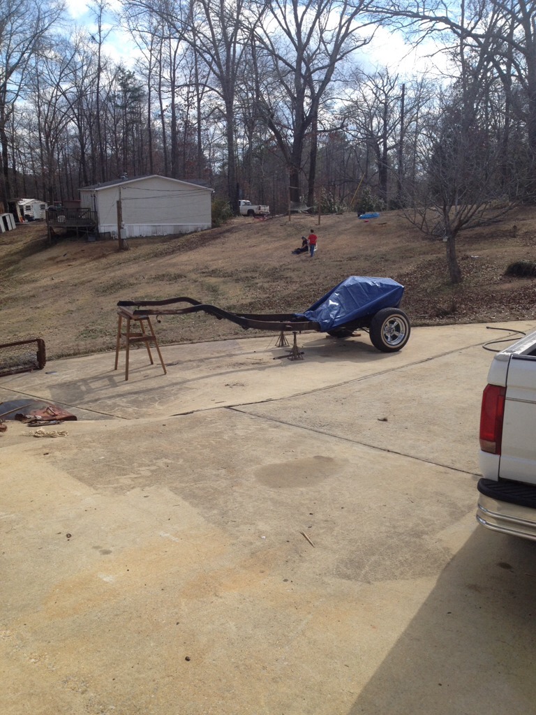

    Body's off and the chassis is outside.
    The chassis needs a little welding done and a friend from ChevyTalk is giving me a set of leaf springs. Mine were in bad shape. The rear end is out and I'm cleaning it up.

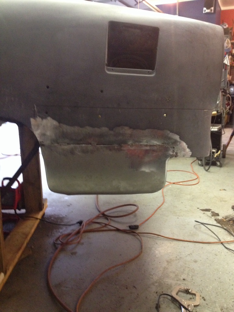

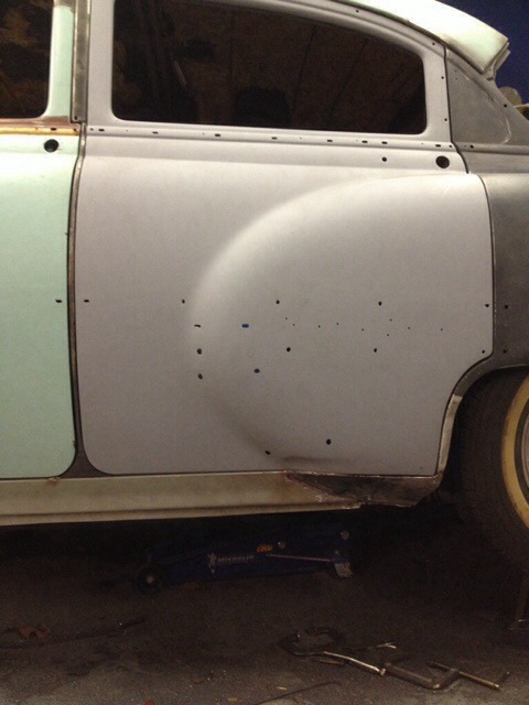

    Rear quarter rot.
    Rot out :)
    Eckler's quarter panel (that took 8 weeks to get here - don't plan on using them again).
    I decided to only weld in what I needed. I just hate cutting out good metal to replace with good metal. Ran into a little lead and still need to finish my welds and grinding. It's straight, though, which is what matters.
    And here's the inner quarter which was worse than the outer. I'm remaking all that from scratch. Not show quality for sure, but once it's smoothed, painted, and back on the chassis, it'll work.
    That's where I'm at so far. I'll take any critiques!
