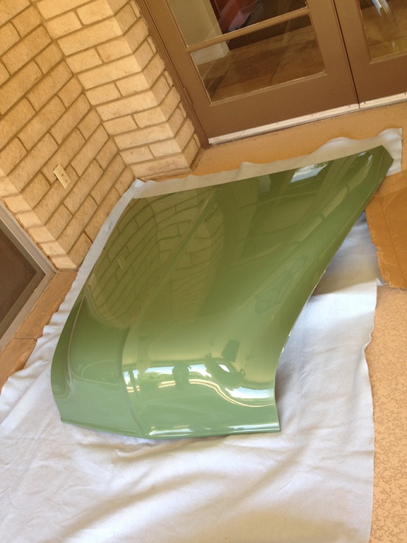

  3. lucky53
    Joined: Apr 10, 2009
    Posts: 104
    lucky53
    The Car...
    And The Hood.

    I had the same issue with a fifty Chevy, bolt the hood on and have a buddy lower it down real slow, if you can climb underneath with a flashlight and check for clearance. Judging from your pic it looks like it will fit. Good luck!

    I'd find some styrofoam cups the same height (you may need to cut the cup) as the filters. Put them on the filter base and shut the hood, if cups are in one piece you're good to go, if the cups are crushed you need to modify the filters.

    Your back one will clear no problem. That front one is pushing it. It will be close. My guess is its not gonna fit. Too far forward and too high. The cup test is a good idea. Good luck man, cool car!
