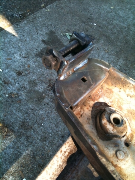

    started working on the front suspension
    stepping the lowers.

    Prabadly a silly question, but I will ask anyway!!You are going to gusset the lowered step, on your aframes, arent you???
    I have a 51 also, and I am thinking stepping mine also.

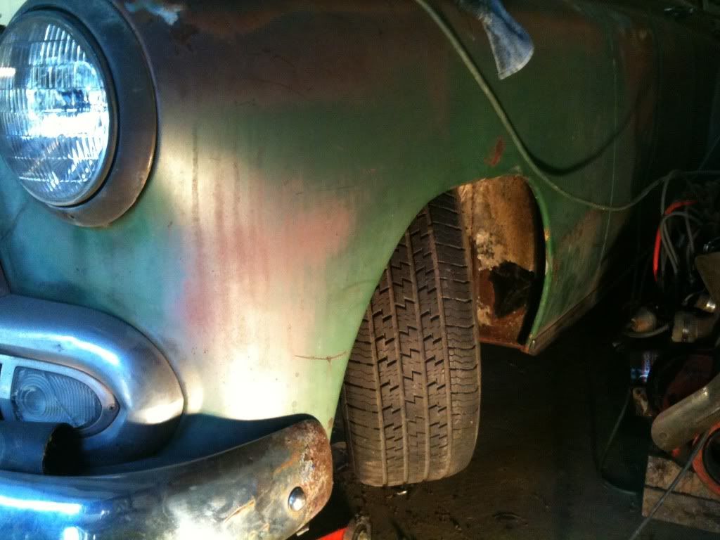

    gusseted the steps. the upper arm is hitting the inner fender now

    Alright i got to this point to get the front to sit where i wanted it. then stood back and looked. i decided it looked horrible. i will be ordering some 3/4" heims to build new lower arms.

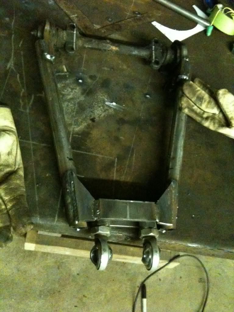

    It looks like the uppers will work. ill build in some extra adjustment in the lowers that way i can fix what little camber there is. i wanted to raise the inner mount on the lower arm but that will just make more problems. ill just have to see. im sure ill do 50 drawings before i decide what to do.

    here is where im headed with the lower arms.

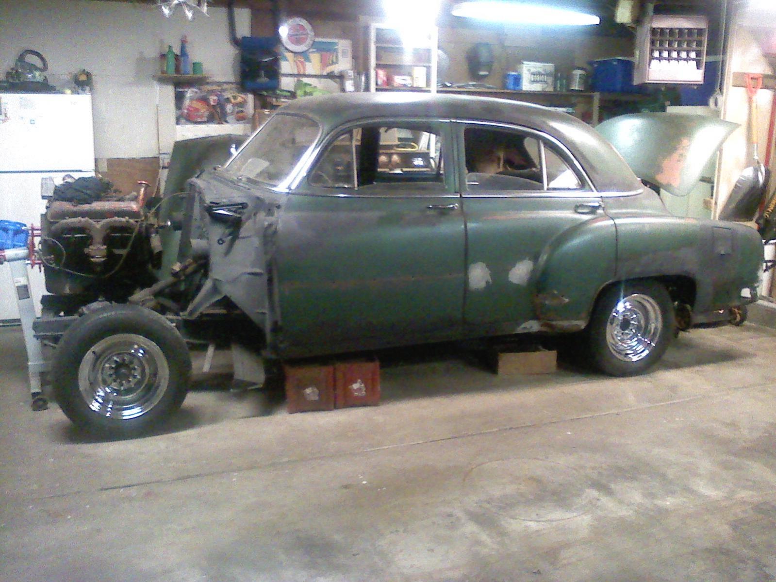

    been a while since i updated but i only work 2-3 hours a week on it. i got some 18" boyd smoothie IIs got the lower arms finished and all the suspension back in. i will be building adjustable uppers to fix the camber.

    Thanks. I plan to have the motor in by Saturday after the holiday

    I think it's fantastic that your grandad owned the Chevy, the new motor is looking good. What year and size is the new engine 216,235 or a 250? Just below the radio delete plate there's a add on with a chrome door, question what is that unit? :D
