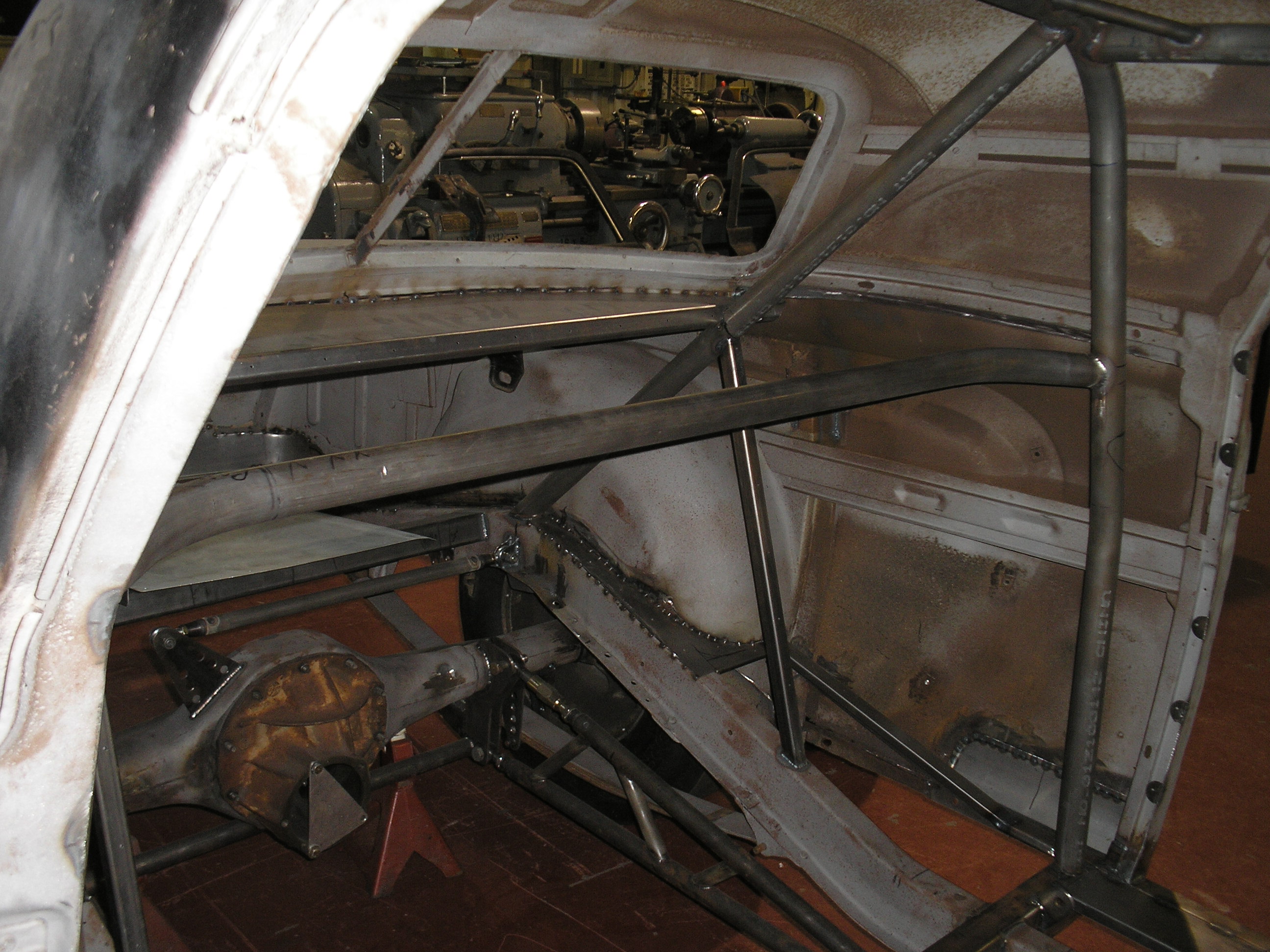

    I always leave the bar behind the seat out until I'm finished fitting the tin work in the back. So now that it finished here's the seat bar installed. the rule book says 1 1/4" x .065 but I went with 1 5/8" x .065 because it has a lot of bend. It's also a good idea to leave out the doors bars until the last thing also. I'm getting old and it gets rough crawling in and out. studebaker 008.JPG

    Next today was the seat belt mounts. The one in the center is for the crouch strap. The shoulder belts will mount too the seat bar. In this pic you can also see the drive shaft loop. and front ladder bar mounts. studebaker 009.JPG

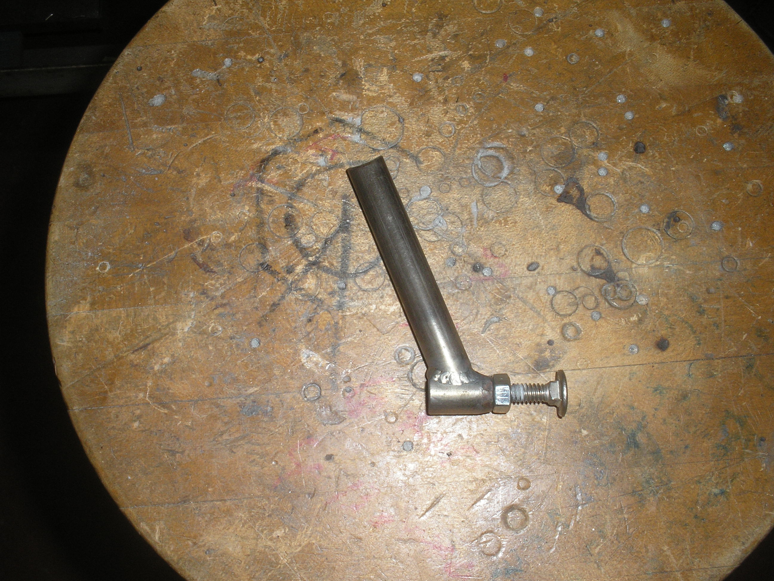

    This took most of my time today, the gas petal, my dad called it the foot feed. Making the parts don't take a lot of time, figuring out the angles and pivots take some time to get right. The pivot tacked on and brackets cut out. everything is 4130 chrome moly. If your using mild steel everything should be a little bigger. studebaker 001.JPG

    Quain, I have a question.
    I see a locator bar on the rear end.
    My understanding is they are not needed on leaf spring suspensions.
    Can you explain if I'm misinformed ?

    This is a very important part that gets left off more often than not. The gas petal stop, I make them adjustable in case you change carbs or something. With out it you can bend the carb linkage or worse cause to throttle to hang wide open, plus I just like the feel of a positive stop. studebaker 003.JPG

    Glenn because of the floater instead of the housing being mounted solid to the spring it's a good idea to use a panhard bar. A wishbone or diagonal link would work better but our rules don't allow the modern stuff.
