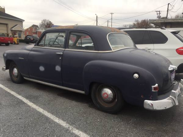

    I'm new to this site but not new to rods and customs as well as willys wagons, I found this Plymouth at Christmas so I treated myself to a little after Christmas present.
    I can't believe that it is a Pennsylvania car that has 0 rust as well as 0 dents, I currently have the motor and transmission, as well as the rear axle removed, I just installed a new set of posies super slider rear springs as well as a 2001 mustang rear end with 3.27 locker, I'm going through the motor right now I'm going old school and putting a 63 Studebaker R1 289 Avanti and a Fairborn Chevy transmission adapter only been working on it for a month and plan on setting the motor and transmission in this weekend and painting it in a couple of weeks.

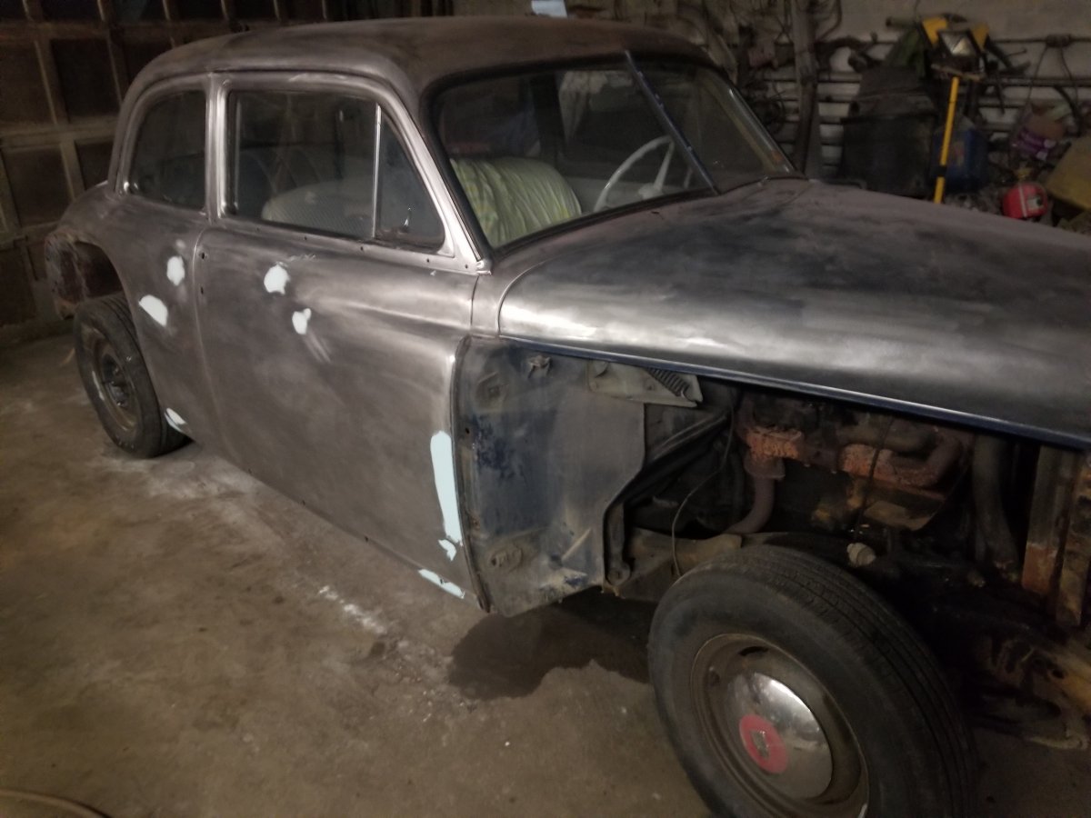

    Just added a few more pictures

    Well plans changed started motor and transmission installation and ran into a significant malfunction, its like trying to put a size 14 foot into a 7 shoe, everything had to be reengineered, so I proceeded to plan B I'm installing a 360 mopar in it i really wanted to doo the stude but didn't want to get involved with steering or subframe installation
    Will post some pics soon

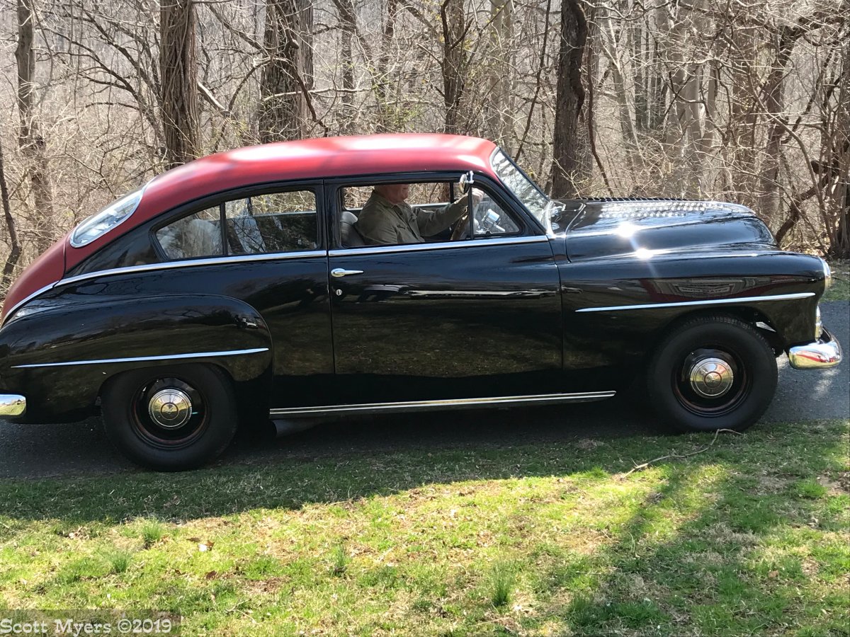

  11. I knew it couldn't be a space issue. Friend of mine shoe-horned this into one of those Mayflowers.:D;).......Images by Scott. IMG_1542.jpg IMG_1497.jpg
