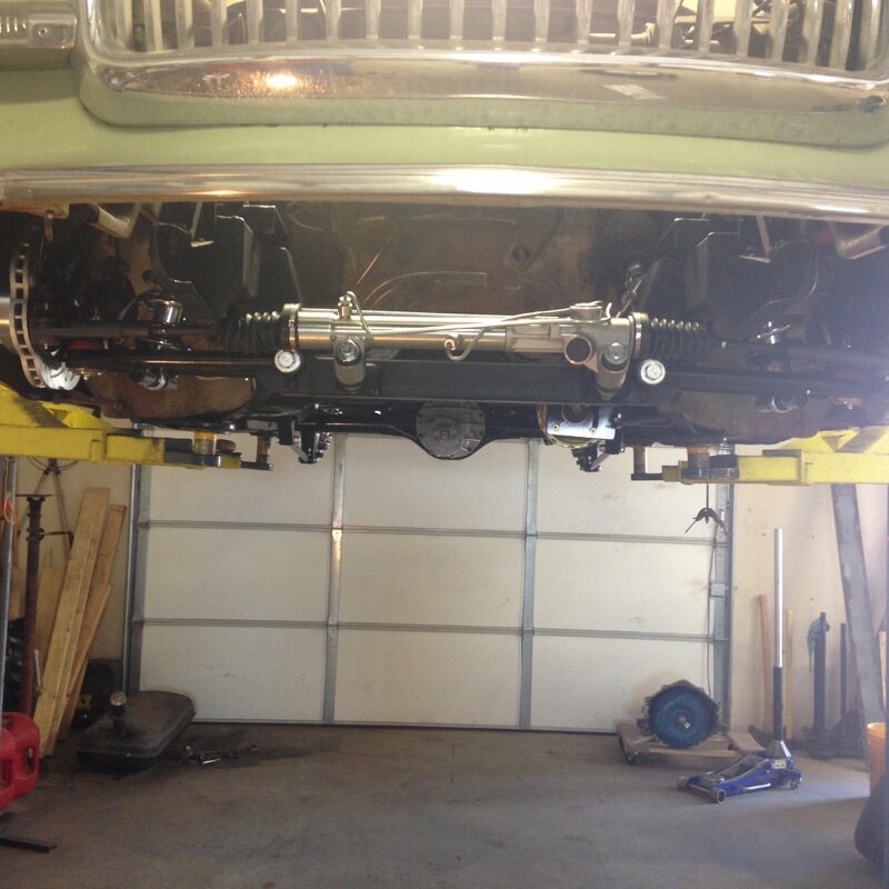

    Wanted to give an update on the Nash. 4-link set up with 12 1/2" coilovers is in the car. We used a 9" Ford out of a Lincoln with 31 spline axles, disc brakes, and posi third member. The steering column was cut off and now supported by a new bearing and carrier. Will take multiple U-joints to connect it all when the Chev motor is in place. Not a lot of room imagejpeg_1(3).jpg . Steering/suspension /engine mounts coming together now in a new crossmember kit from Johnny Law Motors that has to be assembled and fitted very carefully.

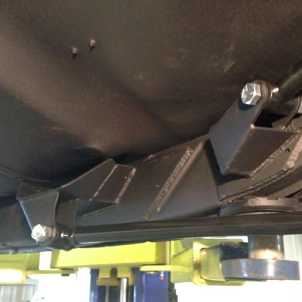

    Here are a few more pics. Pls don't hammer me on nuts that aren't fully tightened or not having washers where reqd. This is just getting all the fabrication done... imagejpeg_2(3).jpg
