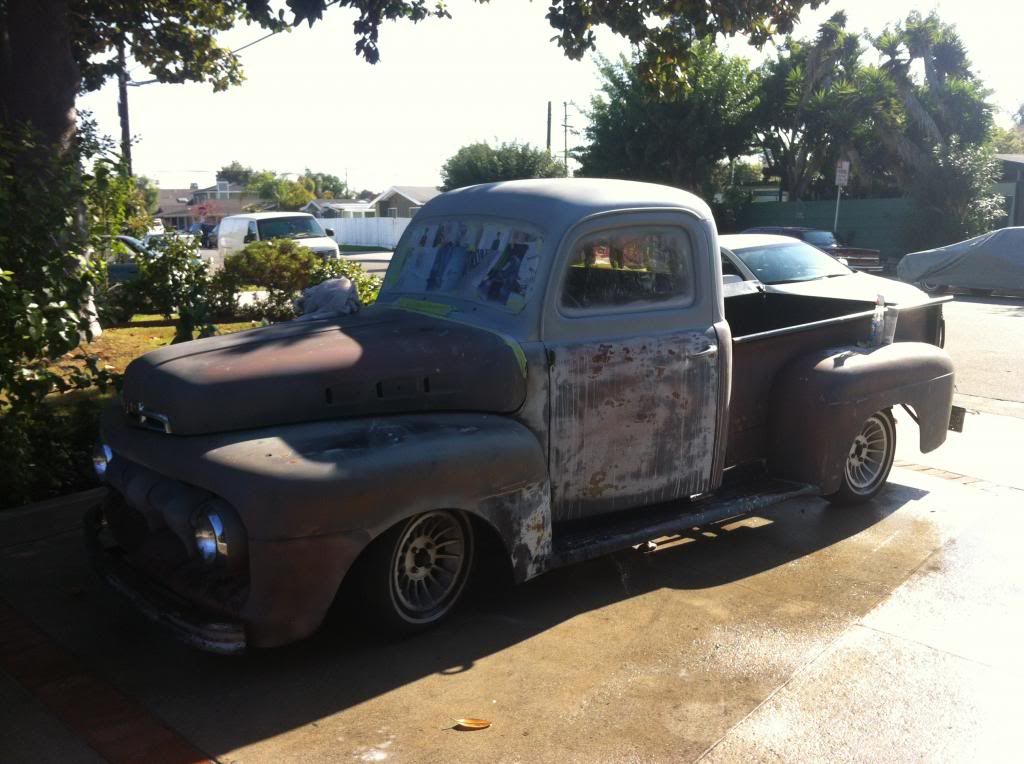

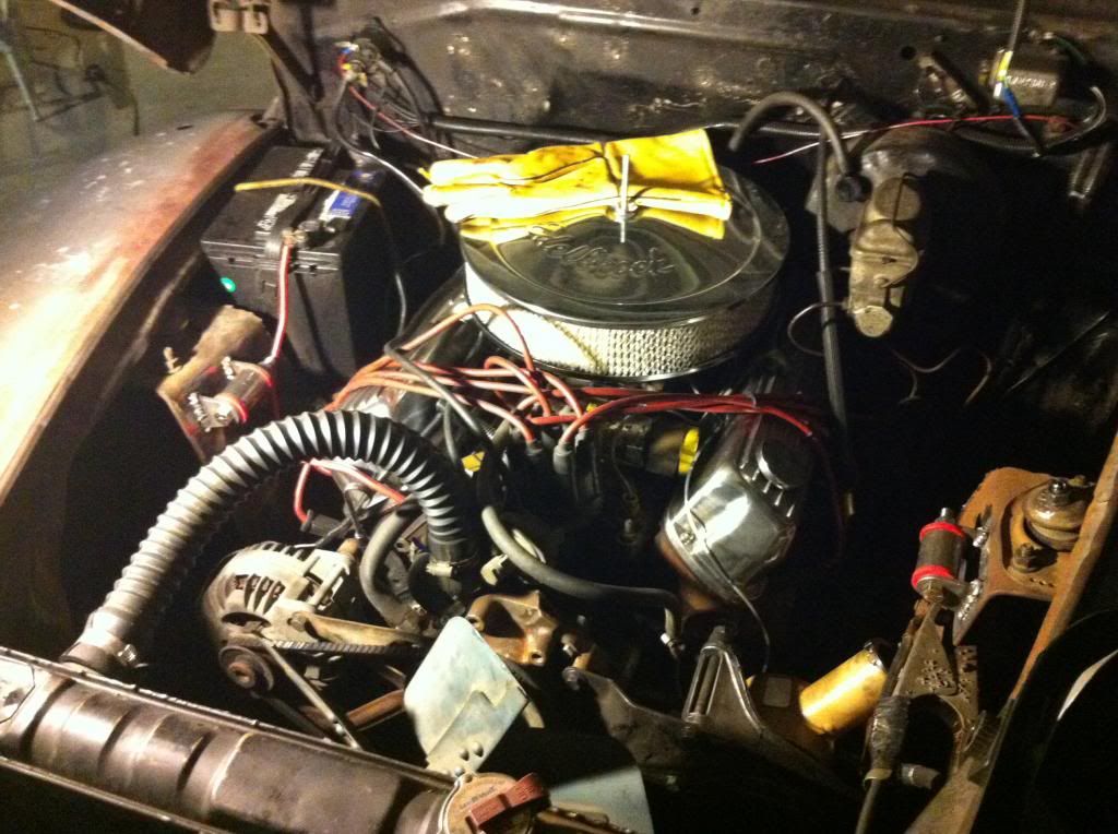

    I picked up this truck a couple months ago as my daily driver. Not practical but I like it alot and enjoy the challenge. It has a 302 and a 4 speed manual, a pinto or mustang frontend of unkown origin(not M2). Body is in great shape as far as rust and dents/damage goes. The PO sanded the nice black paint that was on it and painted it with red oxide "because I like when they look old". Not my cup of tea but whatever. Heres how it looked when I picked it up.

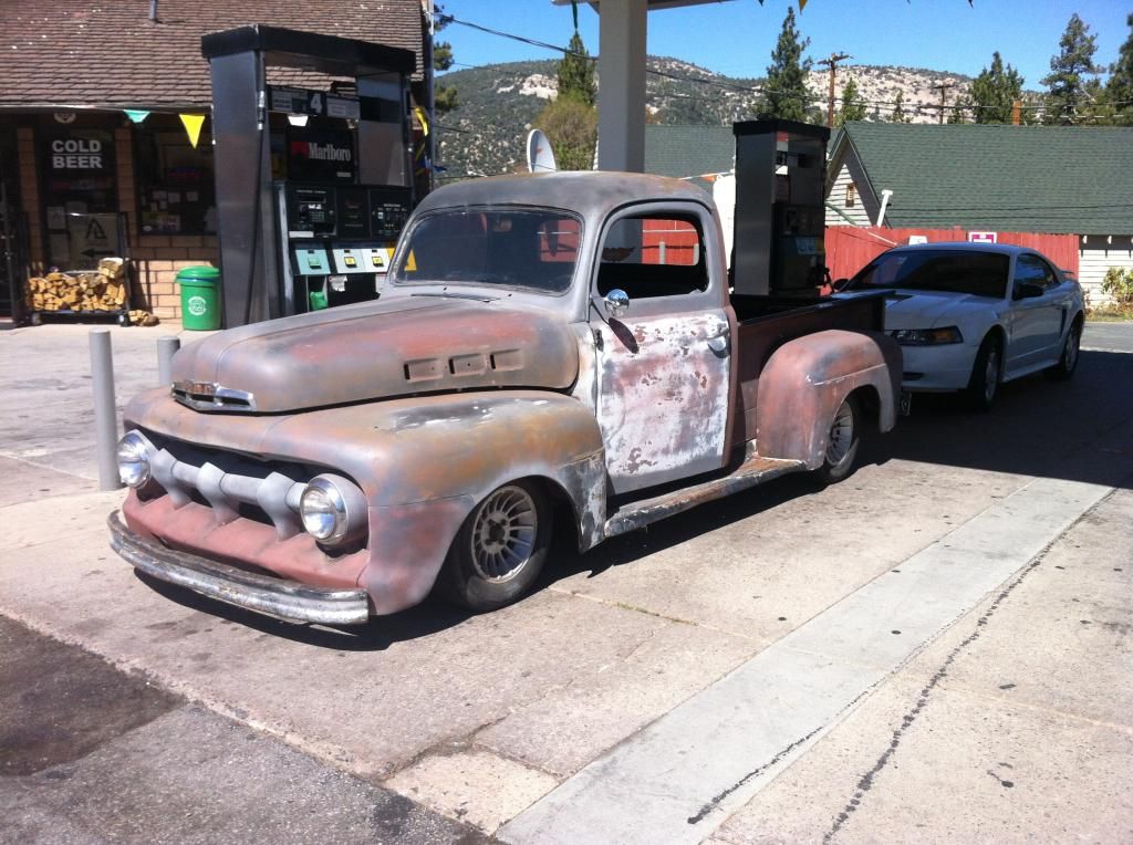

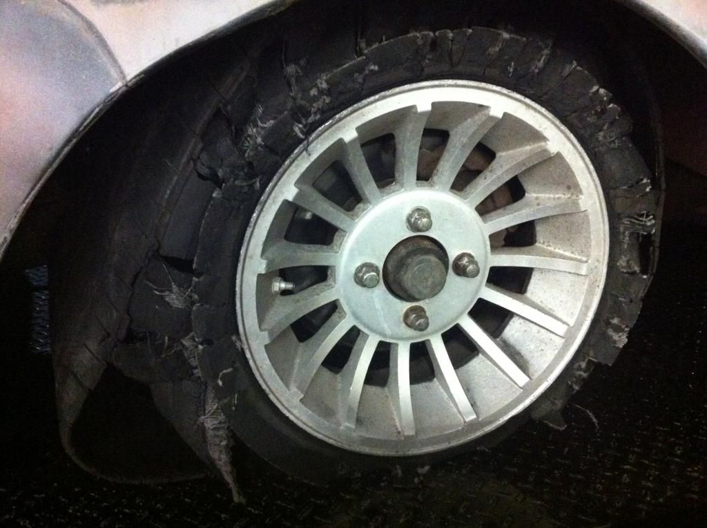

    I drove it all the way home to Costa Mesa from Big Bear City...sketchy but and adventure. It was a sunday when I picked it up. This happened on the 55 freeway on the way home from work. POOOFFFFF FWUD FWUD FWUD FWUD!
    My plans are to put a jag frontend, and an 8.8 or 9"(whichever I can find that will work best) that way I have a safer, better ride and 5 lugs wheels. Right now they are mid 80's 14" mustang wheels. I want 15" wheels and moon discs.

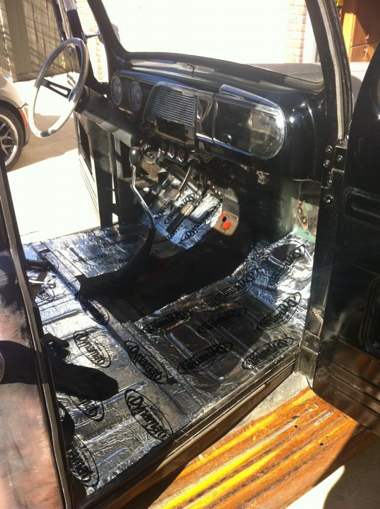

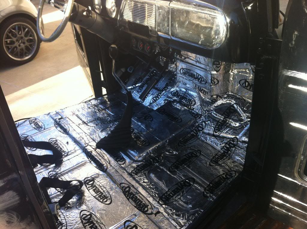

    I started with the fixing all the holes from the PO who liked using drill bits I guess and threw some dynamat to keep the heat and some of the road noise out.[​IMG]
    Not perfect but it works and who will see it under carpet anyway. Heres the finished product....[​IMG]

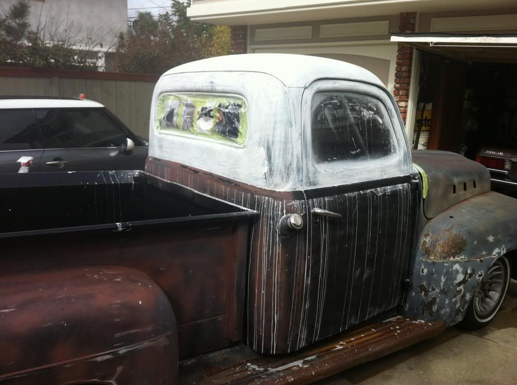

    Then the last weekend I moved on to the roof which had some gnarly rust building up when I got it home by the beach. Had to address that issue before It made holes and I wanted to get going on the paint anyway.
    Backyard painting at its finest. I sanded it with 80 grit to get through the rust and to bare steel, cleaned it with acetone and used SEM high build primer, sanded again, primed again, and sanded again. Now here is what I am working with.
    Once I have it painted I can put in the one piece glass kit that I got from classictruckglass.com which happened to be down the street from my work. :) Remember, this is my daily driver so I can't take it all apart and leave it that way. I have to get to work everyday. Baby steps.

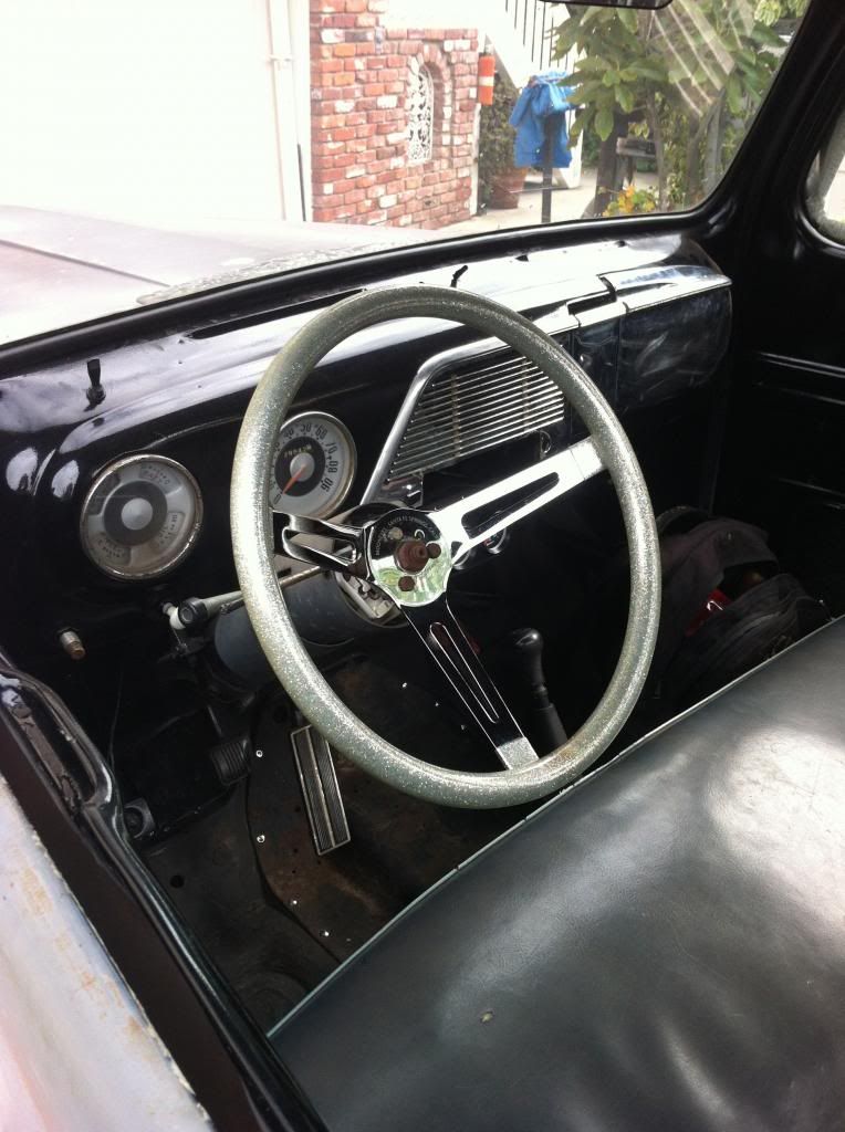

    It had a little 12" 3 spoke gt steering wheel in it. Currently the power steering isn't hooked up so I needed a bigger/better looking wheel. So I ordered this puppy.

    I have that same wheel on mine too!

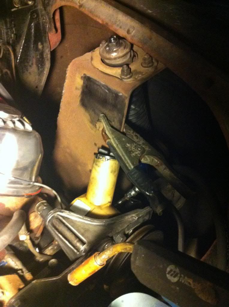

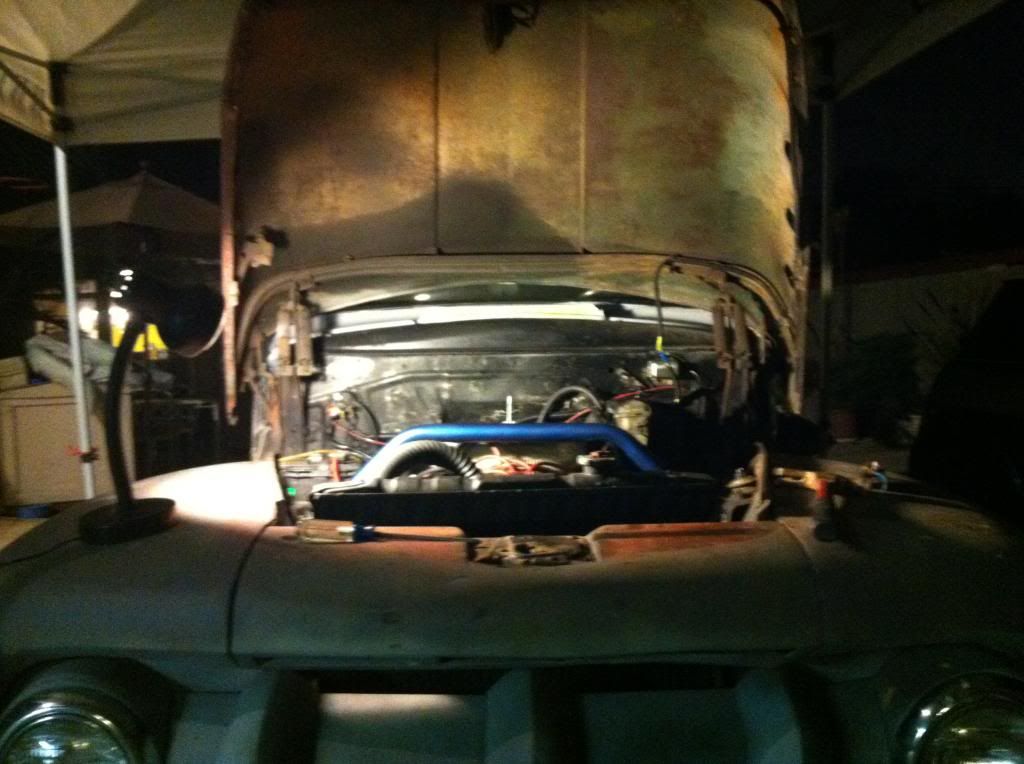

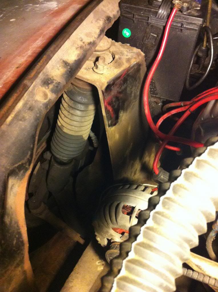

    Looks like I'm sticking with what I have for now. The whole frontend is a bit of a nightmare with plates welded to the frame and crappy welds galore. I put new springs in it after cutting a few coils out. The old springs were torched and one was broken. Replaced the struts, and now the strut mounts are flexing since they actually have pressure on them. I bought some urethane bushings and tabs and will make a crossmember so they don't flex in towards each other. Once I jump on it, I will take some pics for you guys to see the nightmare I'm working with...

    Well here with go. Pretty scary. I think the PO was the leader of the M-I-C...K-E-Y Mouse club. This was the right side...
    Driver side...

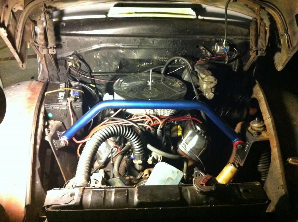

    Here's the tabs I welded in tonight. Be gentle, I'm know I'm not a professional.

  28. Mark in Japan
    Joined: Jun 19, 2007
    Posts: 1,465
    Mark in Japan
    Looks OK!
    I'd want to tie those upper points back to the firewall (and maybe the base of the radiator horseshoe?) to prevent forward/backward movement.

  29. kevinwalshe
    Joined: Apr 22, 2010
    Posts: 428
    kevinwalshe
    Thanks Mark! It is an early fox body mustang suspension from what I've researched. The strut mounts are pretty wide at the base and there is a 1" piece of tubing down to the top of the coil bucket. I am going to add a 1/4" plate between the tube and the ugly strut mount you see from top to bottom. Then it will be a "T" resulting it less flex. So much work, so little time. :D
