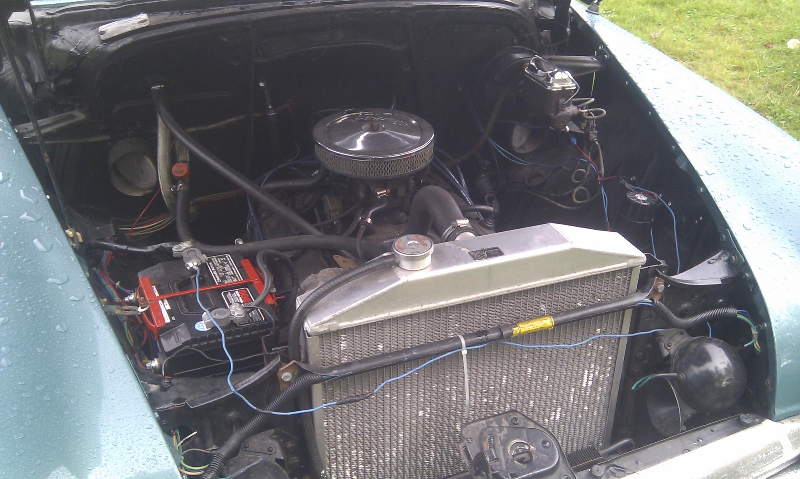

    trying to get my head around the heater in my 51. the 52s chevys I had has the heater core out in the engine bay and I was thinking this was just a blower motor but I noticed that it has 3 inlets for water in the firewall.. so Im guessing it has a core inside the car? the heater has never produced heat sence I got it last fall..any help in undrstanding these heaters would be great. thanks
