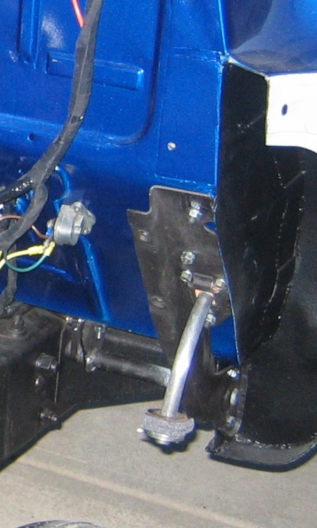

    Hello, I am restoring a 51 chevy truck, short bed. Also known as Advance Design
    I had a new emergency brake bracket, but the firewall and the floor are rusty and gone so I need some help, maybe somebody can take a picture of the location of this bracket and the rest of the mechanism.

  3. does this help?

    Thanks thats the idea...

    The bottom of the bracket has a hole for the e brake pivot rod and when properly positioned the rod should be parallel with the floor. Is the short bracket supporting the other end of the rod still there?

    The short support is not there to, but the pedal rod its there rusty, but I can make a new one using the rusty part, so for the short support I am gonna make an adjustable one, once the floor and fire wall is correct "patched"
